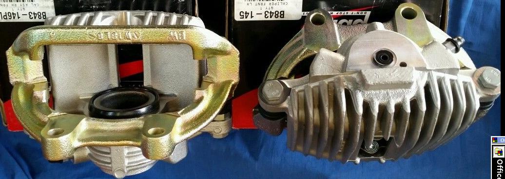

VL turbo and early V8 models had an alloy finned caliper but that's not it. I have a set here on my hotrod.
They have much deeper fins on top.....
what's interesting is that the earlier Commodores used a 22mm thick disk, the TP Magna uses 24mm.
