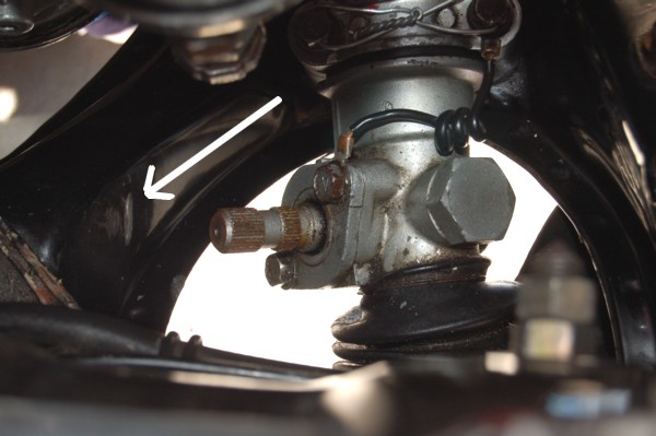

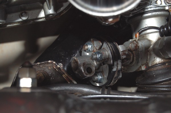

I've noticed that the steering shaft coupling on the GT is scraping the cross member below, as shown here:

Should I be rotating the rack towards the front of the car to stop this, or just pushing the coupling as far towards the rack as possible?
How much clearance should there be between coupling and cross member anyhow? Doesn't look as though there can be much, even when properly aligned?
Thanks in advance for any advice.

The coupling must side over then whole length of the splined shaft.
Then the short clamping bolt can go thru it's hole in the coupling.
If it is still scraping on the cross member you can rotate the rack clockwise enough
so there is clearance.

Thanks Lewis. Yes, I'd got new steering rack rubbers about 2 months ago and fitted them.... Dave Carey was having a few made up so I got some then. Not entirely sure where he had them made, but they appear to fit well. Maybe the rack shifted a bit anticlockwise during this? Not sure, but I do know there was bugger all clearance between the coupling and cross member before that. I've been having a bit of ongoing trouble in this area and had to replaced the rubber coupling late last year...
Coupling seems to be where it should be in reference to the rack; covering the whole of the splined shaft, and the key bolt goes in fine. So only thing left to do is undo the rack mounts and attempt to rotate rack. Any idea how much clearance should I be aiming for, or is it just a matter of putting the steering shaft back in the column and trying to get it all to line up before tightening everything up?

The workshop manual doesn't give any clearance detail. I have about 10mm (finger width) on mine.
You just have to rotate the steering rack enough to achieve clearance without a big change of direction
