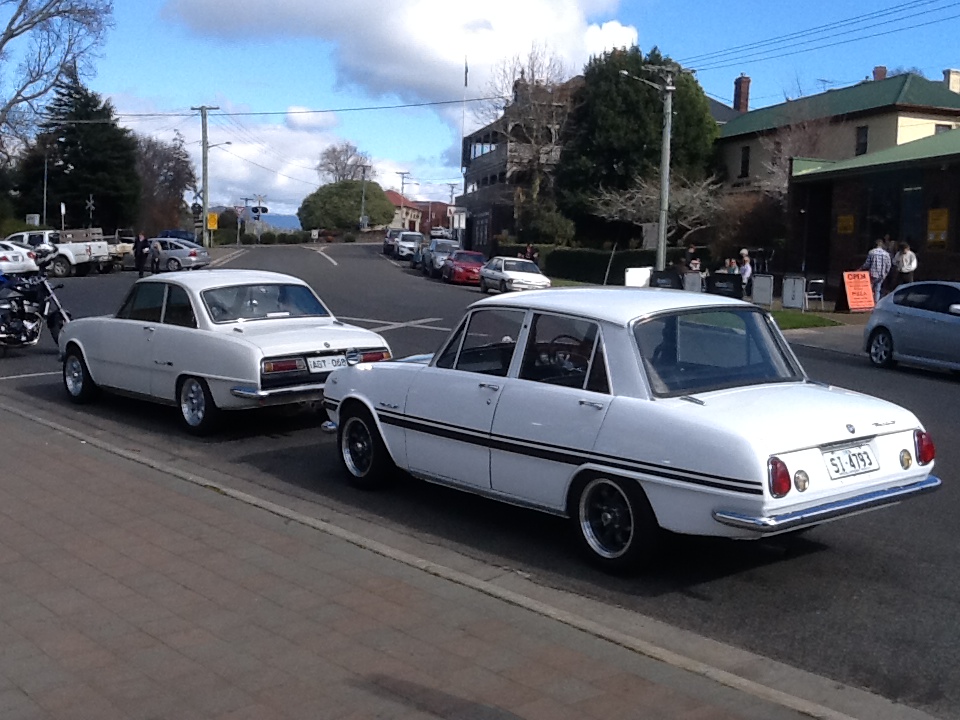

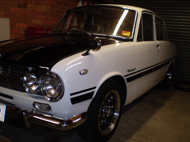

My Bella run Performance Superlites 14 x 6 x 114.3 with offset 18mm (Aussie made)
Same as on Rod's GT in photo
Fits real well with 185x60x14
James
