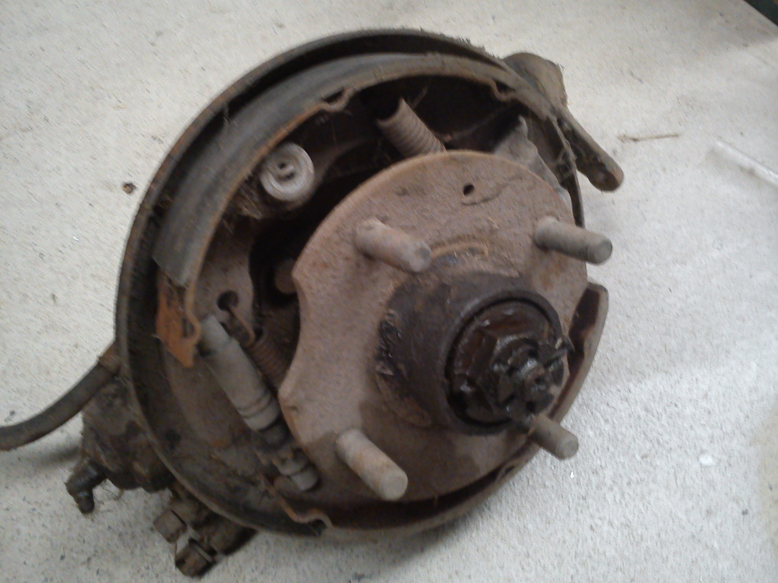

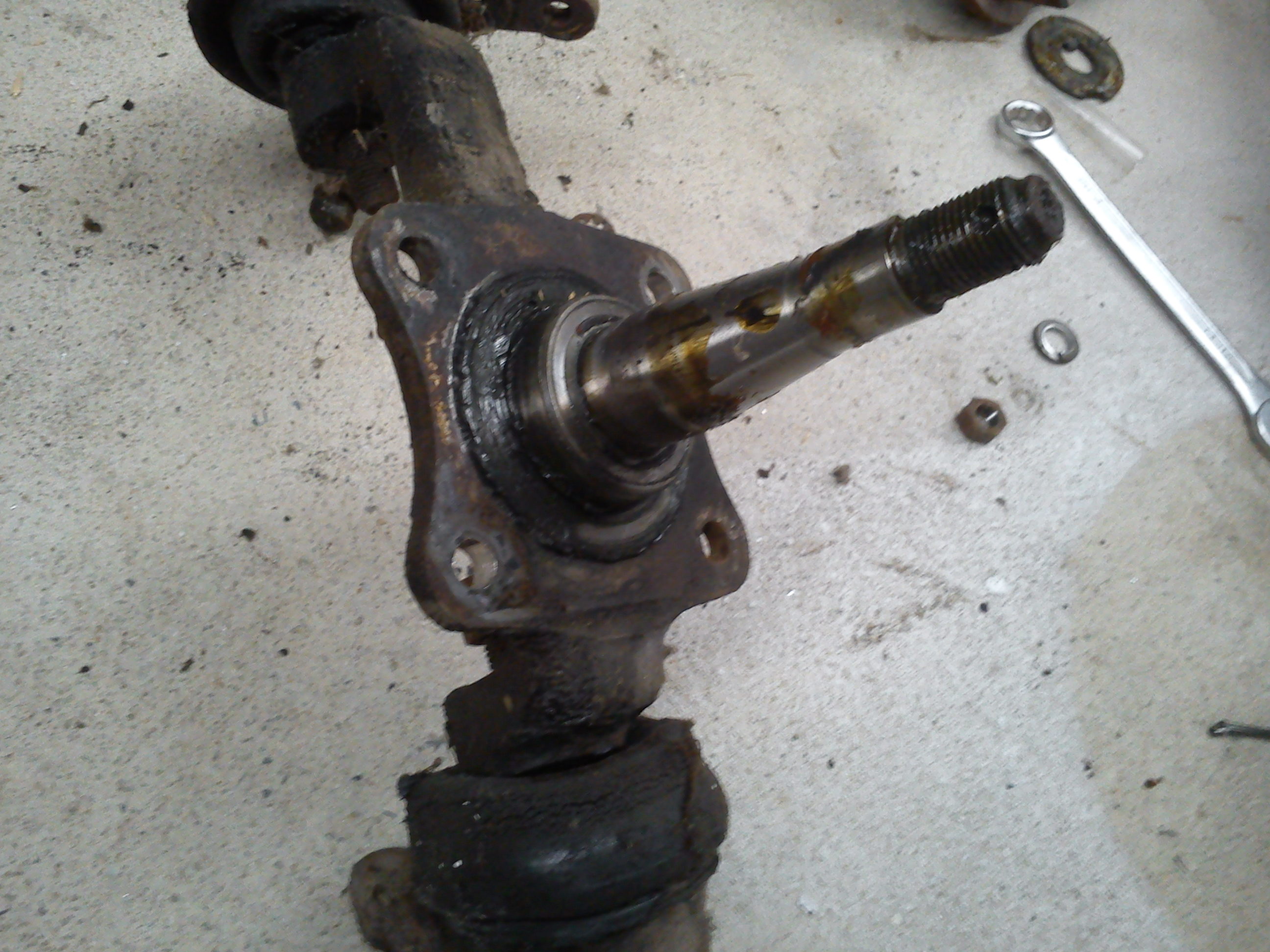

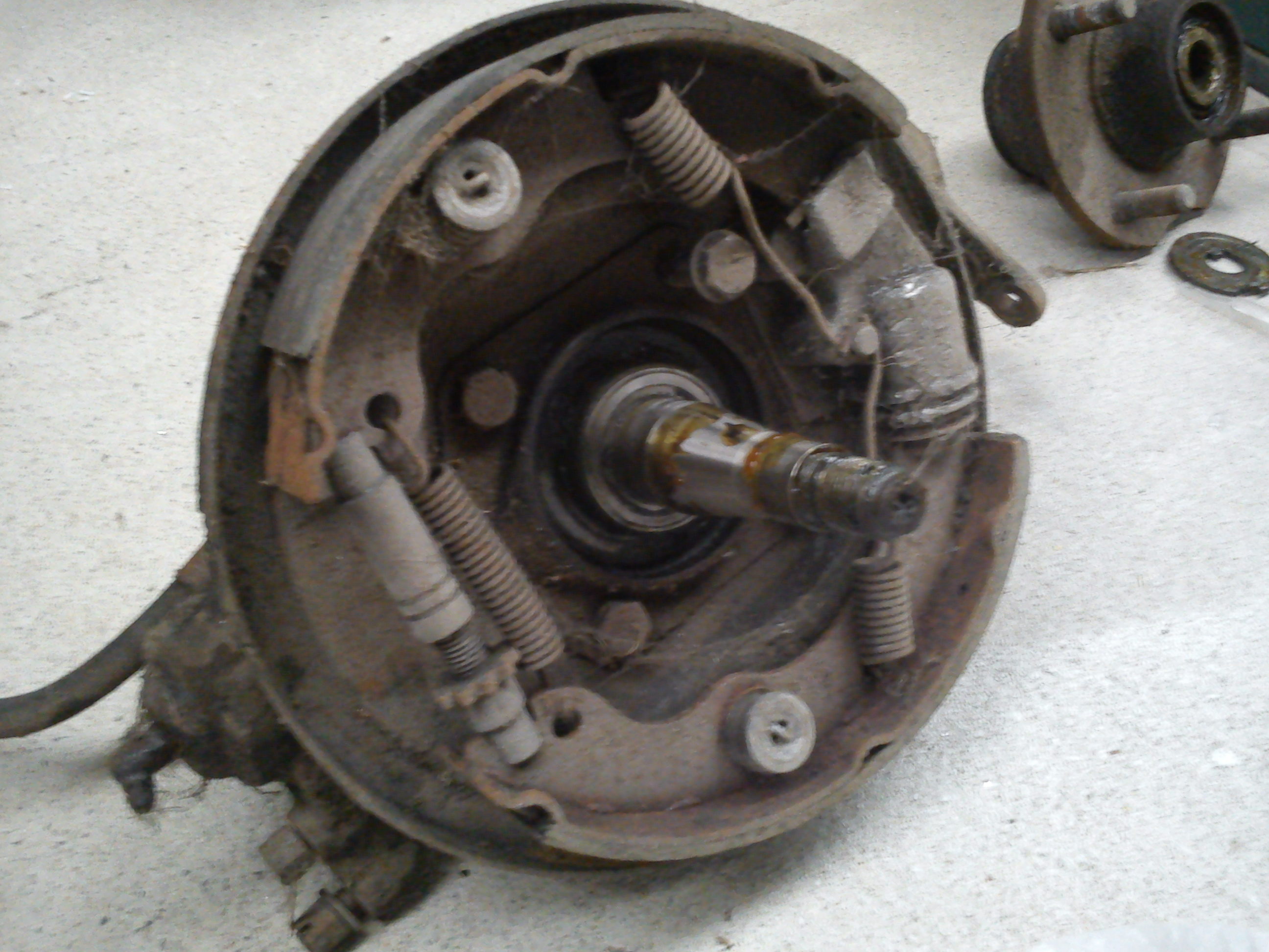

Here is a Bellett stub axle assembly of unknown year.
I removed the 4 bolts holding the old drum brake assembly
Sat May 05, 2012 3:06 am

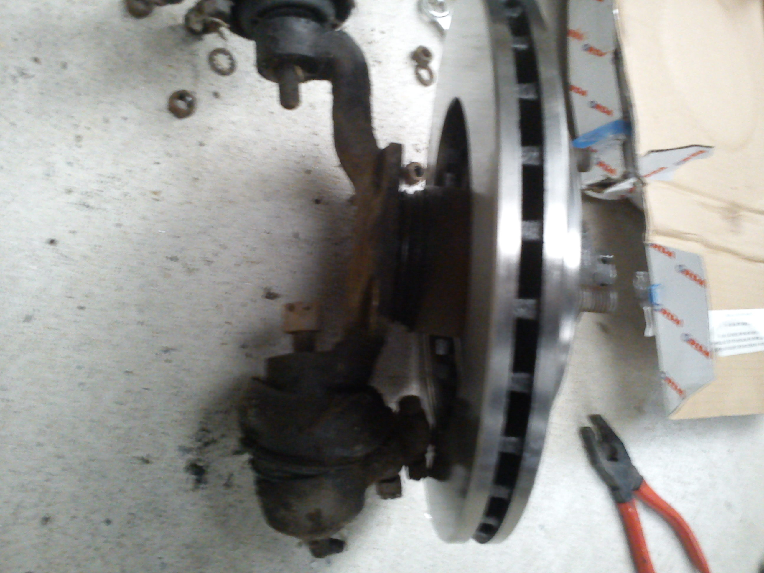

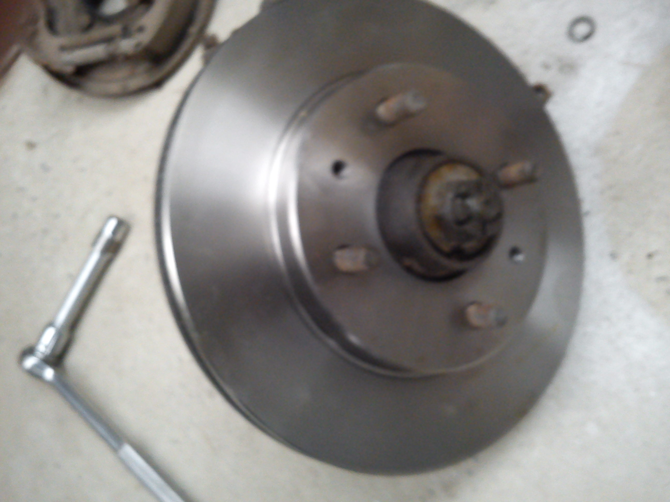

So, now slip the rotor over the hub as indicated in other posts........
Mmmmm........... does not fit !
The rotor has a 69 mm hole, ......Bellett has a 74mm shoulder area. 5mm needs to be machined from the centre of the rotor.
I should add here that the Bellett hub needs to be absolutely clean. It will have a build up of grime and surface rust. This must be revoved totally so the rotor will (eventually) seat on the hub correctly.
So, first job is to get somebody to machine out the hole.........
more later.

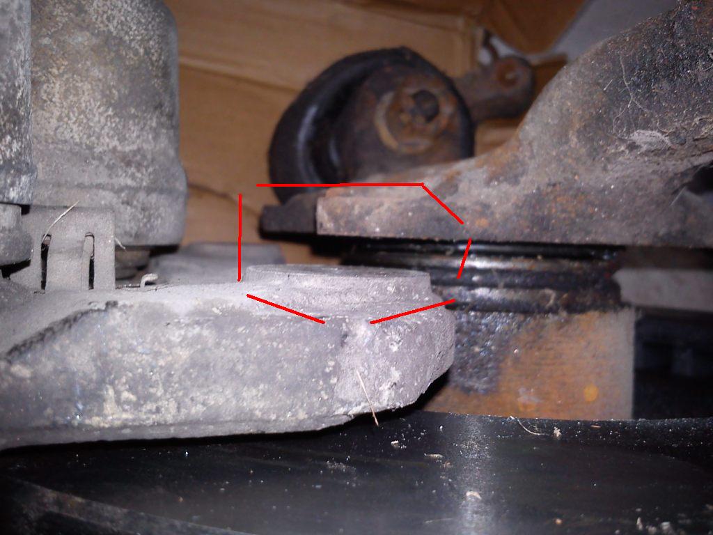

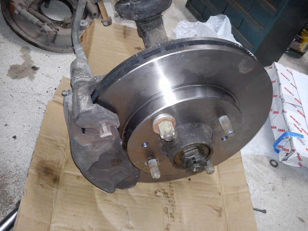

I now have one rotor turned out to correct size. The fun begins...working out the caliper bracket. This is where I will be guessing though as not having a car here, i can only assume the actual position of the caliper. ie front or rear of the axle.
Sat May 05, 2012 5:33 am

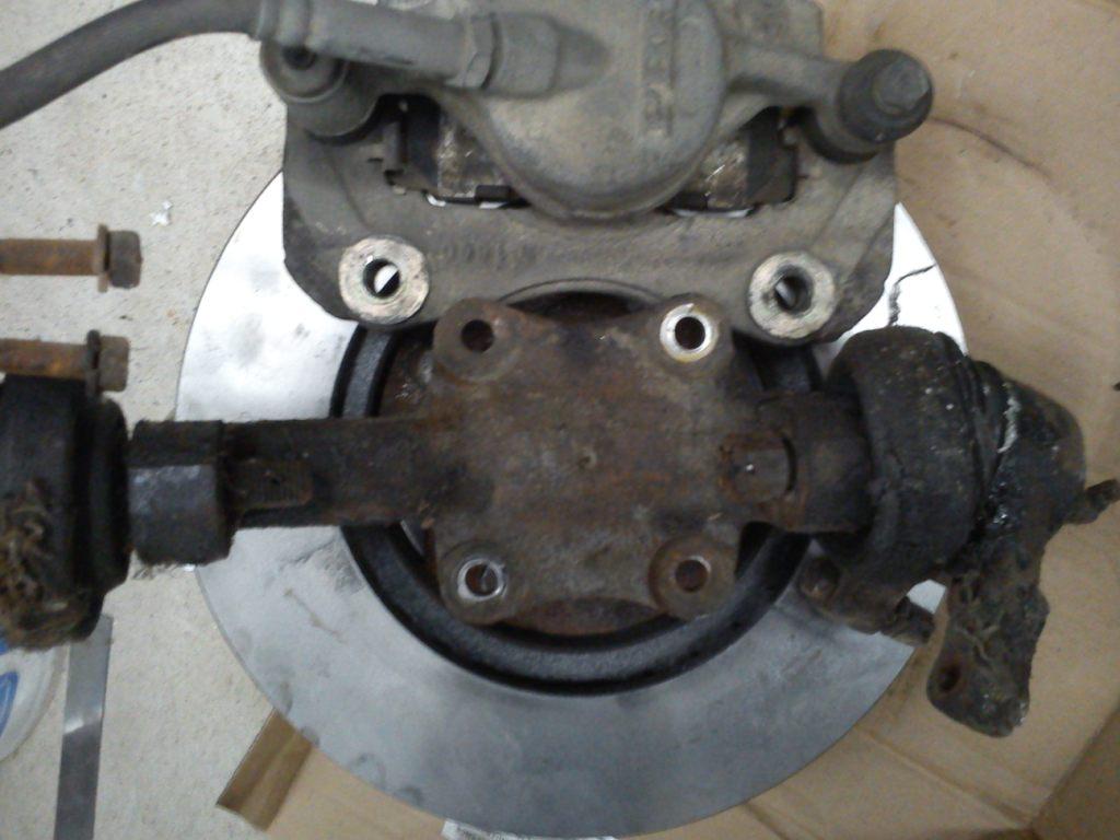

OK, some mysteries here. In the other TP thread, mention is made of a caliper mounting plate. I think 9mm thick.
I have fitted the caliper up with it's old pads which are quiet evenly worn. I have a gap of about 5mm from the face of the caliper to the face of the Bellett upright. I am not an engineer but I think 5mm plate is way too small for this job. Although, the distance between them is relatively small. I mean in a radial sense. Not the spacing.
Any suggestions here? One 'could' mill a little off the caliper face itself to increase the gap, but this is a no-no legally. So I won't go there.
For ref. The original Magna mounting bolt is 30mm long. The thickness of the mounting plate (casting) on the Magna is roughly 11-12mm.
If the 9mm plate is used and that sounds reasonable to me but I am not an engineer. One issue might be that 9mm plate is not s td. thickness?
That would mean extensive machining in a mill to fit these calipers.
If say a 10m plate was used, then there would need to be about 2.5mm taken off each side of the plate, in appropriate areas, to maintain adequete thickness in the area between the upright and caliper. ie. the plate would be full thickness in that area, but milled back in the upright and caliper mounting areas only. Not a cheap part to have made i think.
Fitting a Backing plate would also complicate things. It's probably a good idea though to fit one, to look 'factory' and keep out the crap etc or whatver they are for !
Another observation here... the lip on the hub, normally meant to fit into the wheel for support, is now missing. This maybe a moot point as most if not all mag wheel fitments would not be correct here either.
any inputs here ? I can't do any more now, as I have no steel plate.

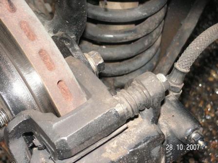

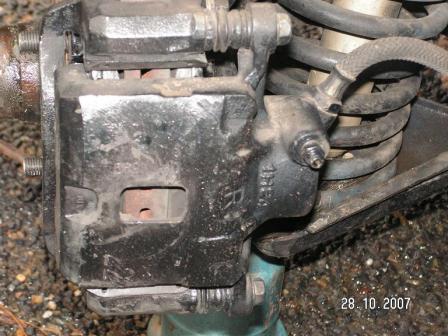

ie. Looking back at the threads, one picture shows a caliper mounted up with a plate, seemingly not milled etc.
Another picture shows a caliper that requires the plate to be machined. This seems to be same caliper i have.
ie, TP Magna caliper.
The mystery for me now is, what is the other caliper off? It's a totally different style of caliper. It appears the mounting boss area is different (thinner) and the overall style of the caliper is a lot different also.
anybody know?
File comment: is this a Magna TP caliper, note how mtg. bracket is not milled, appears to be quite thick also.

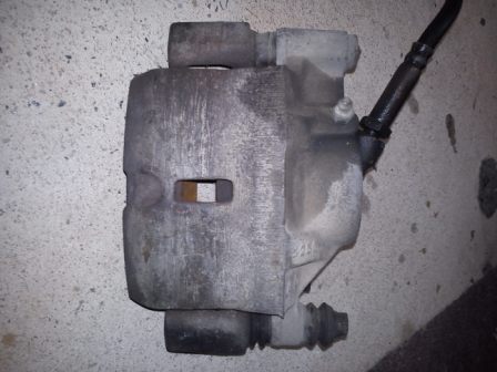

Here are the 2 types. One for sure is TP Magna as I removed this from a car. What is the other one from? Maybe a different Magna model?
1st picture is 'my' TP Magna caliper, made by PBR.
What is the other one from ? Perhaps calipers changed as time in the TP model life?
This is why you need "exact" details of "everything" for any proposed mods. or substitutions !
File comment: Magna caliper PBR (branded)
File comment: what caliper is this from???
Sat May 05, 2012 11:55 pm
second calliper almost looks like a commodore rear calliper? (vn, vp, vr, vs?) just a thought?
after looking them up on the net they look similar but they are different to what you have shown there.
