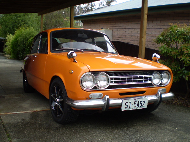

Hi
I am running a set of Advanti 15 x 7 with offset I think 38mm. 15 x 195 x 50 series low profile tyres
Require 'X' factor to clear calliper if running disc brakes.
Down side for mainlanders is I 'fine tune' with 5mm spacer on the rear
J

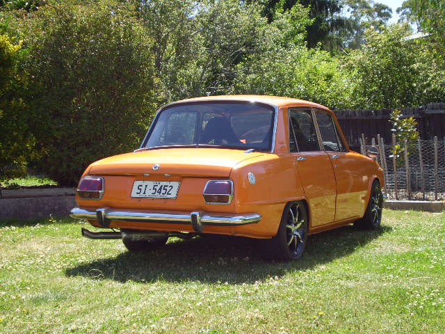

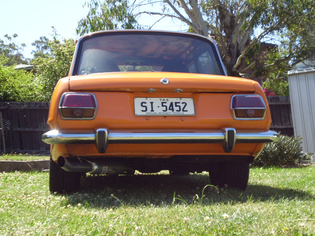

Here is a picture of the rear and how well Asroc's wheels fill the guards
For the record a mag wheel with with tyre on is usually 1 inch larger so 7" mags actualy equate to 8" with tyres so Asroc has 8" sqeezed under her guards
Sweeeeet
Cheer
J

very Sweeet, love the car, love the look of those wheels, seem to suit it fine.
you just need a "Bellett" strip on boot lid now......

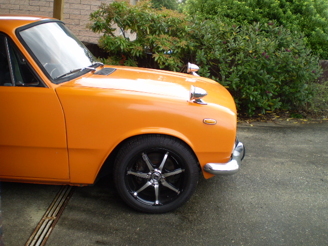

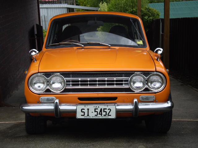

Thanks James. I would be interested in a picture of how the front sits in the guards ( front on ) as the +38 should narrow the track I would have thought. but I guess the extra width helps in this regard. As for the rear, by running a 5mm spacer ( which as you point out we can't do up here ), that would make it a +33 in effect. All of this is good news as it does make my search for wheels a little easier. Do you get any tyre rubbing on the rear at all ?

Your deductions are absolutely spot on
My front hubs have custom Volvo calipers and an effective machined spacing of approx 18mm out from standard so this would equate to approx offset of 20mm.
This is in keeping with Performance Supalites which are popular mags and run an offset of 18-24mm I think

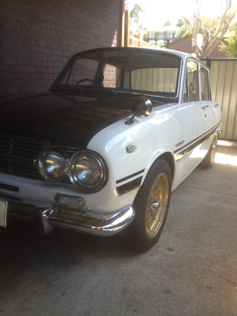

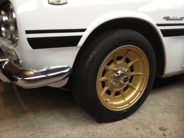

Here are the Magnum Dominators that I purchases specifically for 2014 Nationals
14 x 6 with offset of 20mm
Interestingly had to special order 175 x 60 x 14 tyres as 185 x 60 x 14 scrubbed big time
J

Here is the photo you requested from front
J
