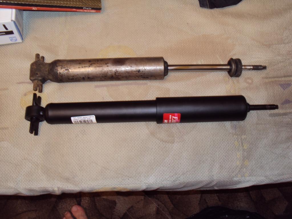

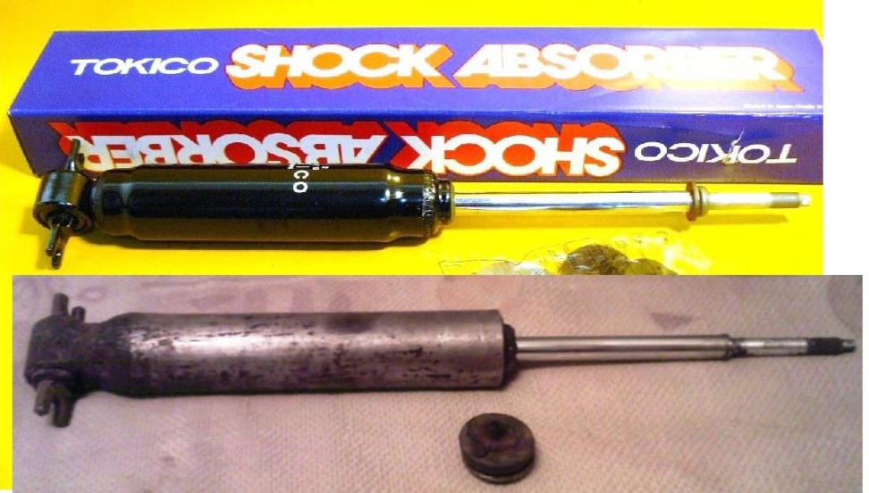

Hi. My question:
Front shock-absorbers for Florian and 117 coupe same as at Bellett?
sorry for my english )))

puhol
- Posts: 7
- Joined: Thu May 14, 2009 1:37 pm
- Car(s): Isuzu Bellett 1972 PR50
- Location: Russia, Vladivostok
Re: Springs and shock absorbers
I bought absorbers for toyota noah. I think they approach
mrflibbles
- Posts: 1129
- Location: Adelaide Hills
looks very similar, i have no idea what a toyota noah is though! look like toyota hilux/hiace front shocks - also very similar to some mitsubishi and holden front shocks!
