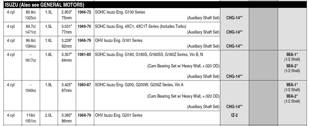

I found a listing here showing "CHG-14" for the layshaft and MIA-1 half shell and
MIA-2 half shell which is +20 thou. for the OHC.
This is from a catalog by DURA-BOND (usa)http://www.mellingdurabond.com/Portals/3/pdf/2009%20Catalog-Interior_r3.pdf

extract of above pdf file:-
