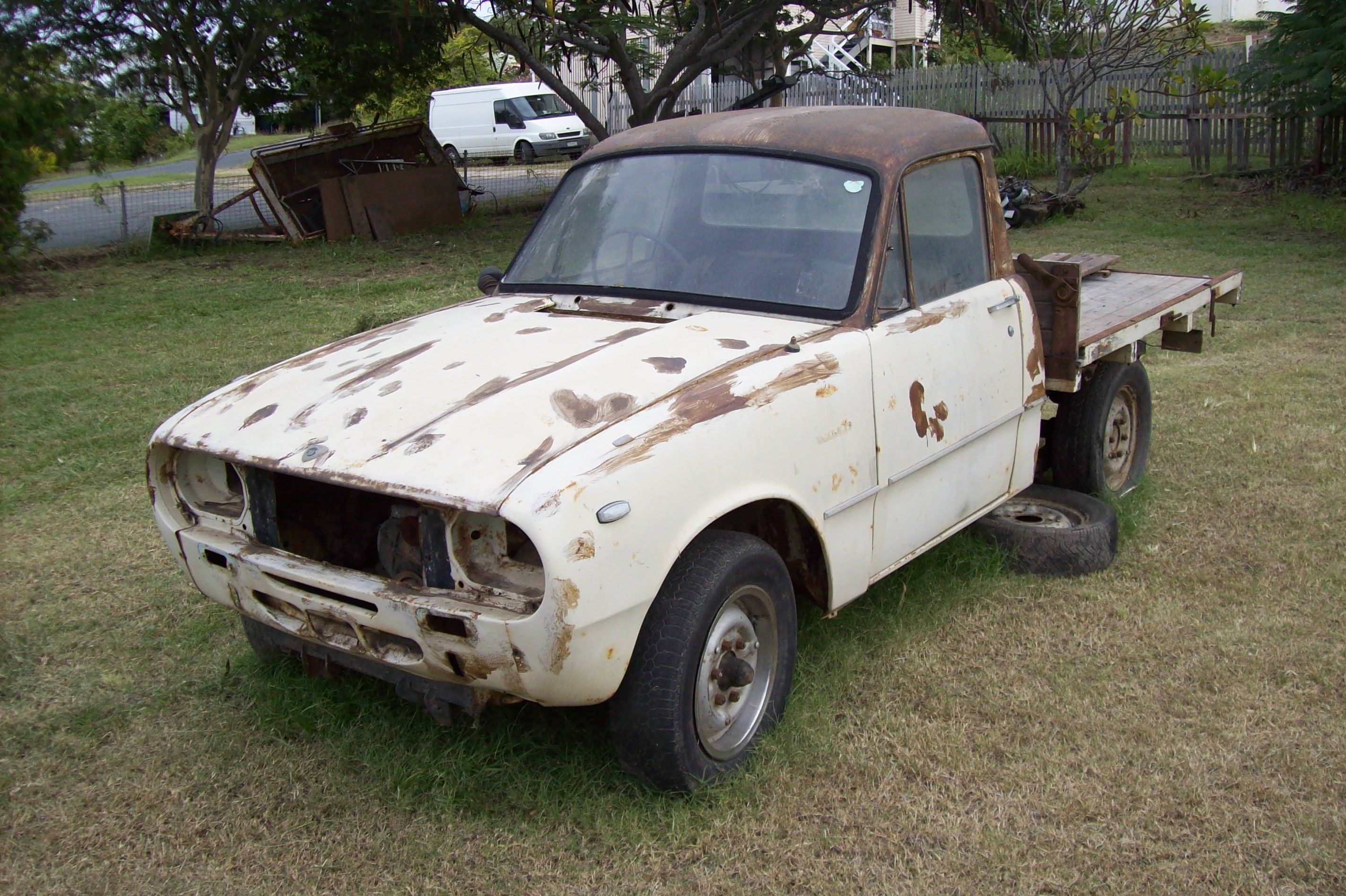

File comment: 'Neville'. Good for spares only.

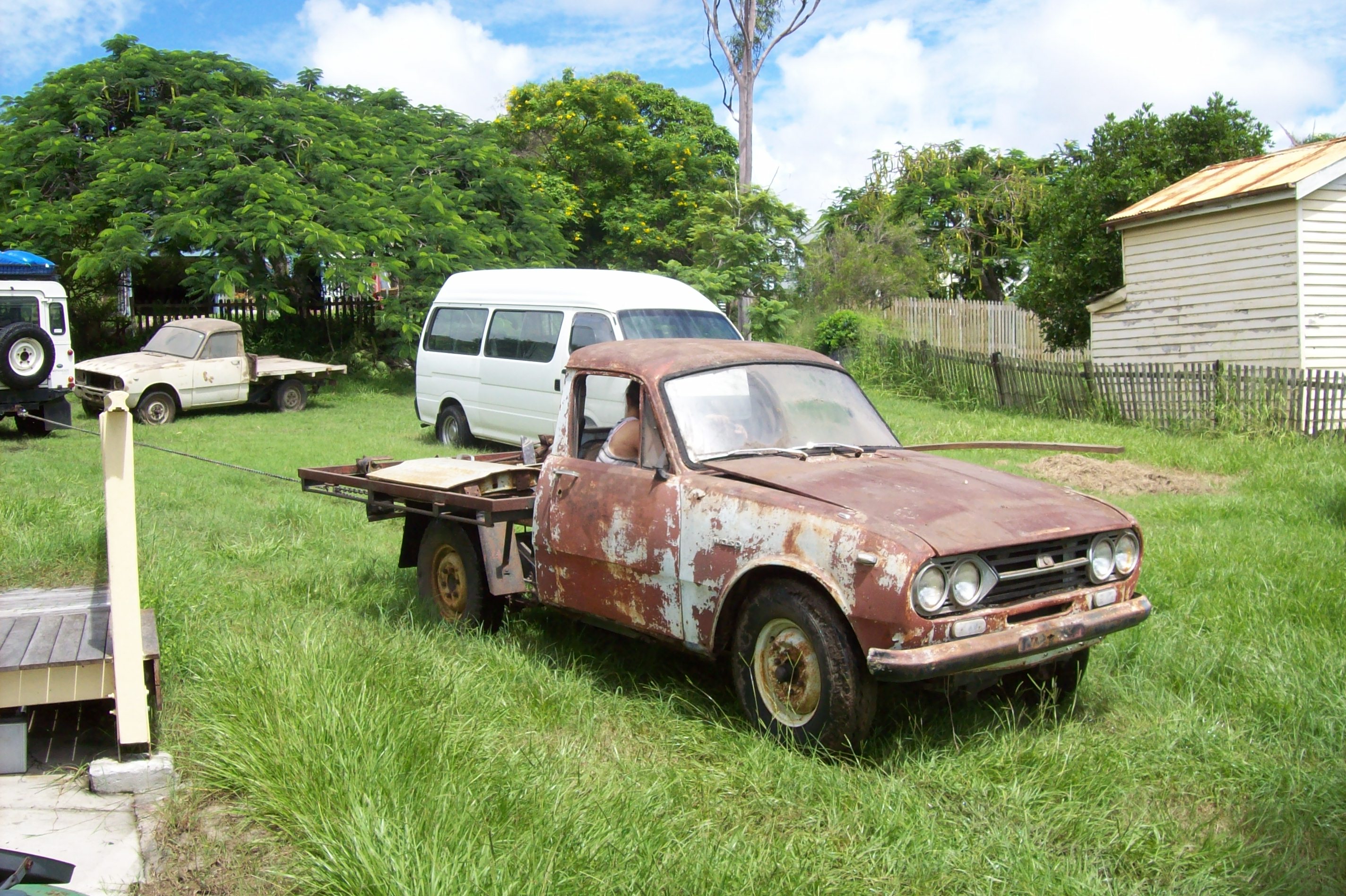

File comment: This is 'Harry'.

Thanks for the Wasp pics. You must be the Dave with the 2 Wasps.......

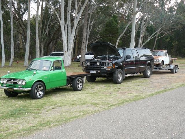

bloody strong cars those wasps towing that landrover unbeleivable ...mate looks like they are all there . painted and off to merrimbula better hurry mate times running out cheers davo and thanks for the photos
Thu Jun 14, 2012 7:21 am
need i say more :lol:

I am the Dave with 2 Wasps, 2 Sedans & 1 Gt.
The sedan on the trailer behind Gricey's 250 in gt Orph's picture above is 1 of them.
You gave me the door check for it.
