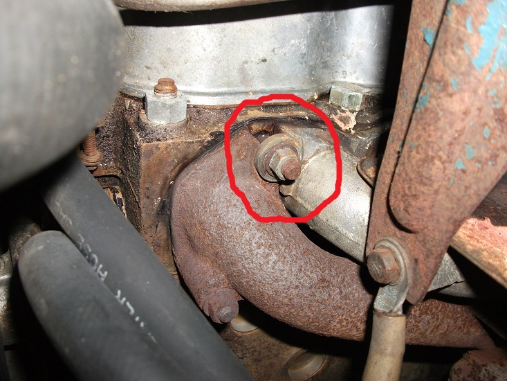

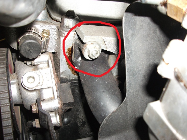

ok, here's the differnece in GT to sedan manifold mountings:
*the different mountings are across the entire manifold face, not just at cylinder number 1. i have only shown number 1 as it's the easiest to photograph and see easily for reference*
sedan: note location of top bolt/stud on number 1 cylinder, circled in red.
is at "1 o'clock".

GT: note location of top bolt/stud on number 1 cylinder again, circled in red.
is at "11 o'clock".
very basically, the sedan heads have the 'close spaced' bolts/studs along the top row and the 'wide spaced' ones along the bottom, while the GT is exactly the opposite.
and yes, that makes the sedan and GT manifold gaskets different to each other too, just to make things a bit harder for us all....
