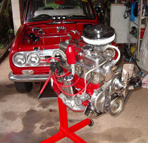

I got a complete rebuild kit back in 2003 for my standard 1500cc engine from Dalby Autopro - they were very helpful via email and on the phone.
It comprised of:
VRS Gasket set
4 x Pistons (.0030 over) rings and bearings.
I will have a look in my files to see what I have on it regarding part numbers etc.
This is how it turned out:
Darwin
Wed Oct 29, 2008 9:40 pm
Awesome looking G150! My rebuild won't look nearly as nice as that but it does give me somehting to work towards :)

The guy at the chrome platers/polishers LOVED me for a few months :lol:
That is the first engine I have every built - and it is still going strong.
Wed Oct 29, 2008 11:16 pm
crusing some old posts and that engine re-build on the G150 is an awesome job there Redback!
i am sure you have enjoyed driving that car for many years after doing such a good job.

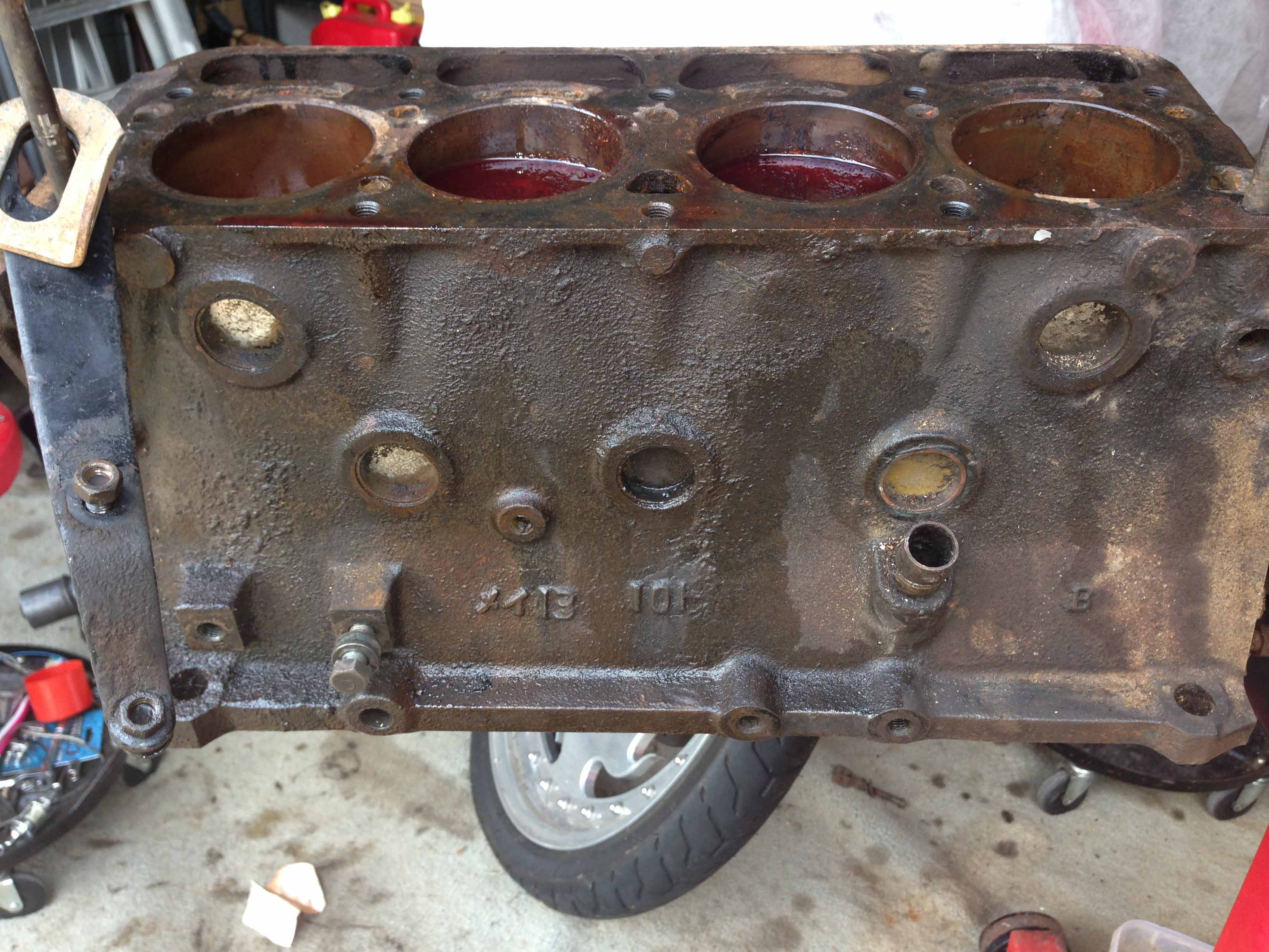

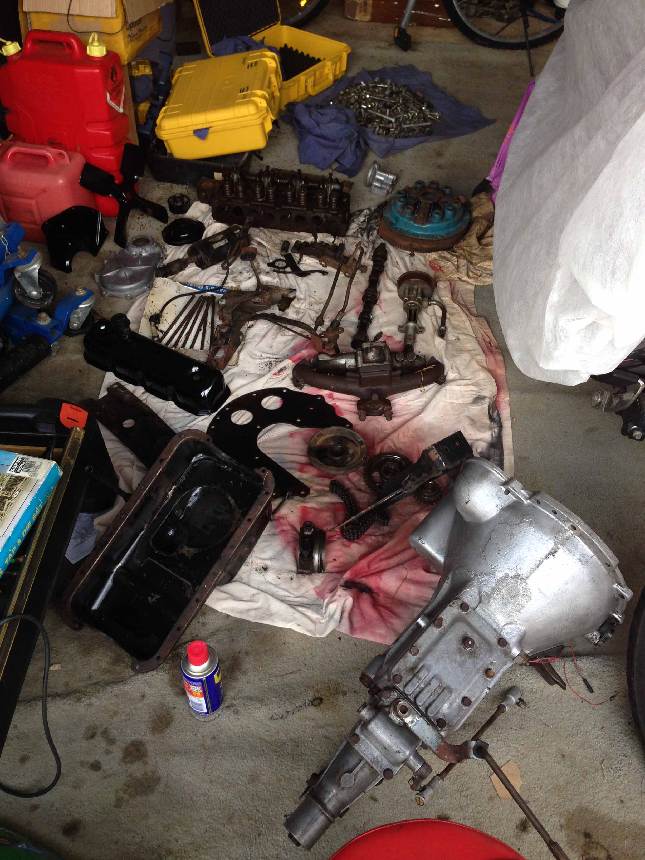

Hey Brains Trust,
I am probably going to rebuild the spare engine I have in my shed - I am bored and wanted to get my hands dirty again........
This is going to be a "Hot One" High compression, built for perfomance - angry hopefully.
I am wondering what size it is - 1500cc or 1300cc
Can any of you shed some light on it please: so I can make sure I order correct parts etc

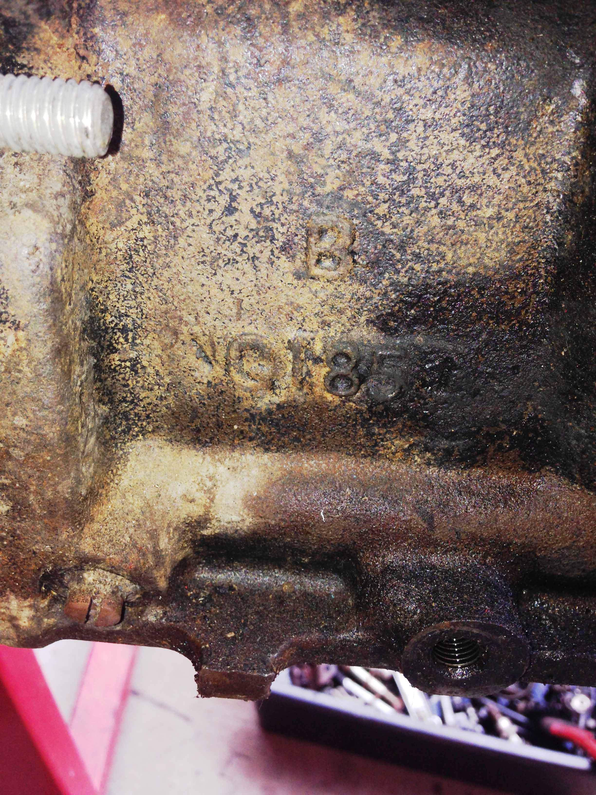

Photos of markings:
Left Side has Japanese Symbols then13 101
Right Side has:
B
G185
I have a 3 speed manual I will probably use - just for something different.
Any advice or help is appreciated.
File comment: Shed floor filing system - super organised

Sun Nov 03, 2013 11:08 pm
Neil.
G130 bore size 75mm. 1325cc. G150 79mm. 1471cc.
Going by the sump and the front engine mount foot and starter it's probably a 3 bearing donk.
Has the engine number got a prefix on it or is it like most that I have seen just a number.??
Is there no model number above the fuel pump mount hole.?? Very strange if not. :!:
Mon Nov 04, 2013 1:17 pm
Hello Dave,
Thanks for the reply - yes it is a 3 bearing motor and I cannot remember seeing a model number above the fuel pump or the engine number - I will investigate this evening and measure up some bores.
I have a mate who works in a engine machining shop so I am hopefully going to look over his shoulder and learn some interesting machining stuff in the near future.
I will keep updating this one.
Mon Nov 04, 2013 9:22 pm
Would be rrrrrreal unusual to have a 1300cc engine but stranger things have happened.
3 bearing main engines go really well but dont run them at high RPM for long periods of time!!
due to the flex in the crank, you will eventually start to chew thru the bearings.
better to do a 5 bearing main if you want reliability and give it some extra go.
or do basic rebuild on this and drop it to replace the other engine and go hard on it instead.
keep us posted with plenty of pics

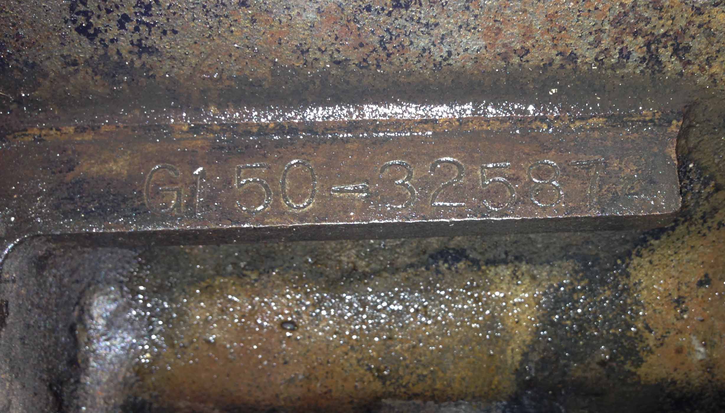

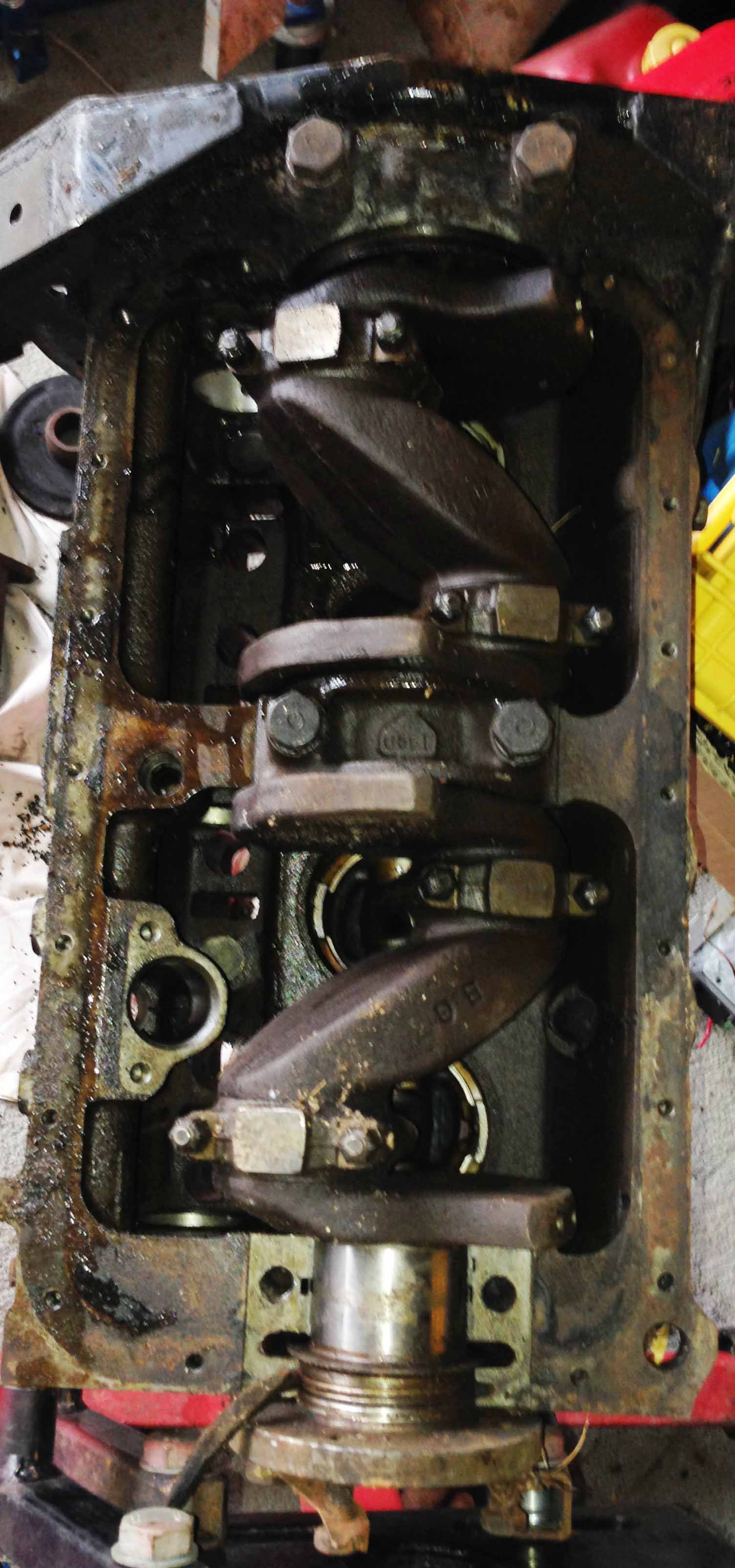

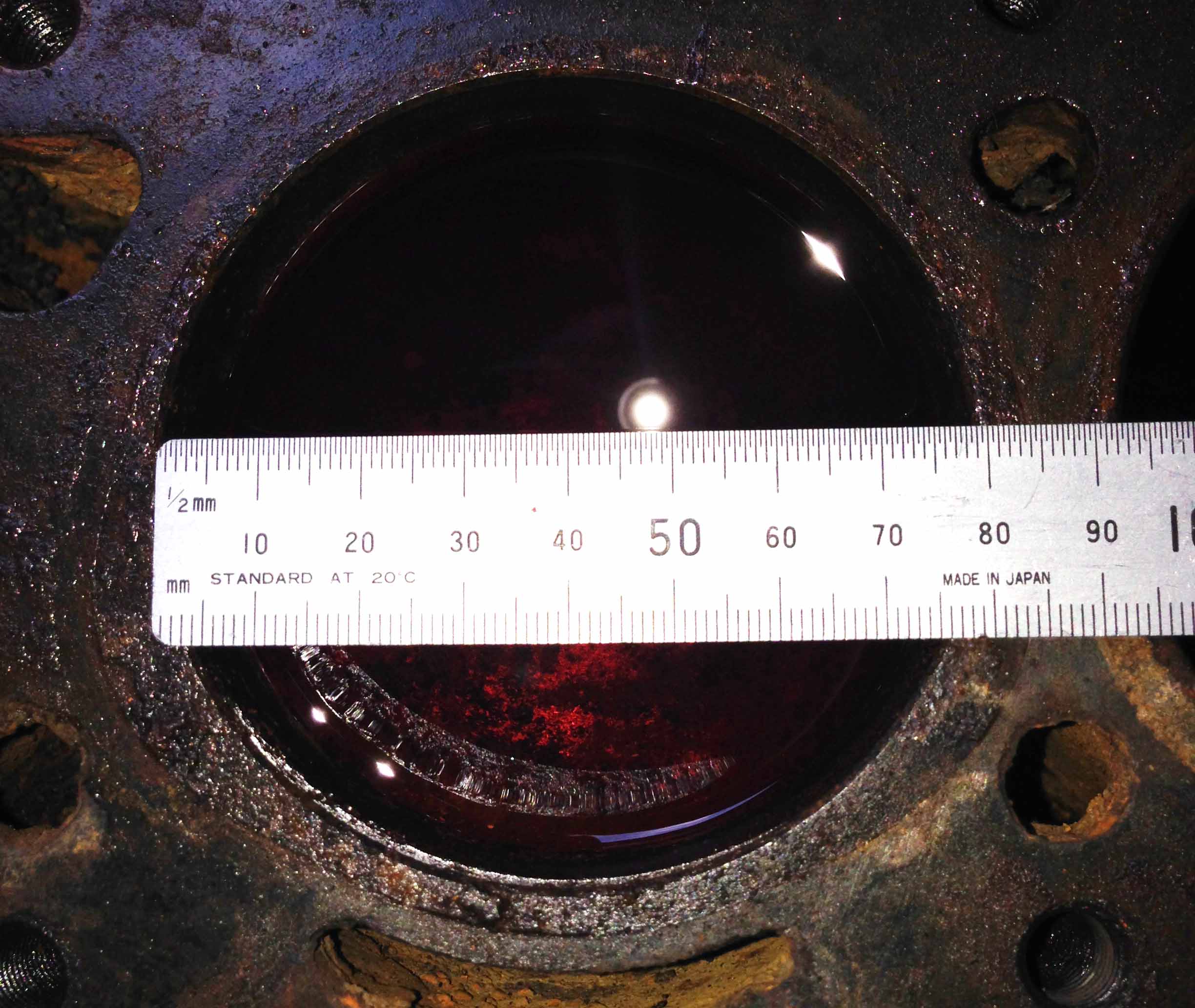

Tue Nov 05, 2013 7:18 am
Yep thanks Dave for reminding me of the engine number ( has the size at the start) sorry.
Okay it is a G150, three bearing engine.
Onwards and upwards.
Anyone with a good oil pump and water pump?
File comment: 3 Bearing crank
File comment: Bore is 79mm
File comment: Engine Number

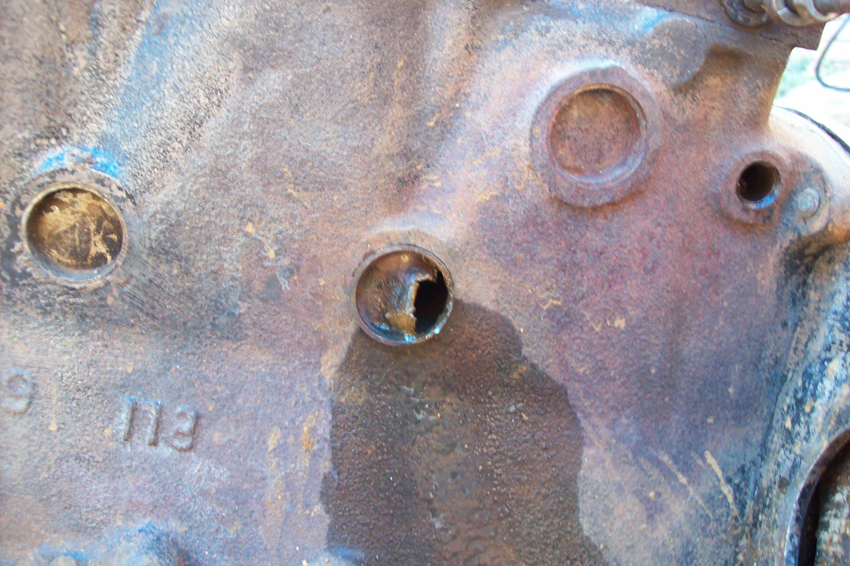

Are you going to give the block and cyl. head a acid bath. ?? Going by the amount of crudd that's showing in your photos it will need one. Back in the early days of when I started in the motor industry, [Dec. '66], radiator coolant or inhibitor was never mentioned to put into a motorcar. The only engine manufacturer at that time that I was aware of that used a coolant inhibitor was Cummins. These engines were fitted to the IHC ACCO. In 1975 I changed jobs and started working for the GMH dealer.This is when I had an introduction to coolant inhibitor and only if you were going to go to the 'Snowys'. Later it was part of the service and is now used extensivly by all motor manufacturers.
Three years ago I was trying to get my sedan to 'Coona' for the Nationals. As my original engine was at the rebuilders fitting Gemini internals to it, I have a '66 sedan and I decided to put the motor and gearbox into the '69. After giving it a good clean with a pressure cleaner it was looking good enough for a coat of paint and throw it into the car.
I'm sitting there admiring our handywork and I saw this brown pinhead dot on 1 of the welch plugs. Got the screwdriver and give it a scrape. Well that mark got bigger and lots of water was coming out and it wasn't clear. I thought I flushed the block thoroughly. The amount of muck that came out of that hole after I removed the plug was unbeleivable. Subesquently no sedan to the Nationals, but I took the GT.
On the phone the next day and enquired about the rebuild engine and what was the condition overall. First up it gets a acid bath. Second. After the maching etc. all plugs are replaced and including the camshaft bearings. The water outlet for the thermostat I knew was RS. The front of the head [alloy]and mainly where the thermostat is recessed had to be filled with metal,ground and machined because there was never any inhibitor used. At this stage your all thinking that it's another one of Daves' RANTS and I'm in the wrong section of the forum.
I can assure you that it's not a RANT and I cannot emphasize enough that if anyone intends doing an engine up don't cut corners . Have the engine given a bath. Replace all plugs and use inhibitor.

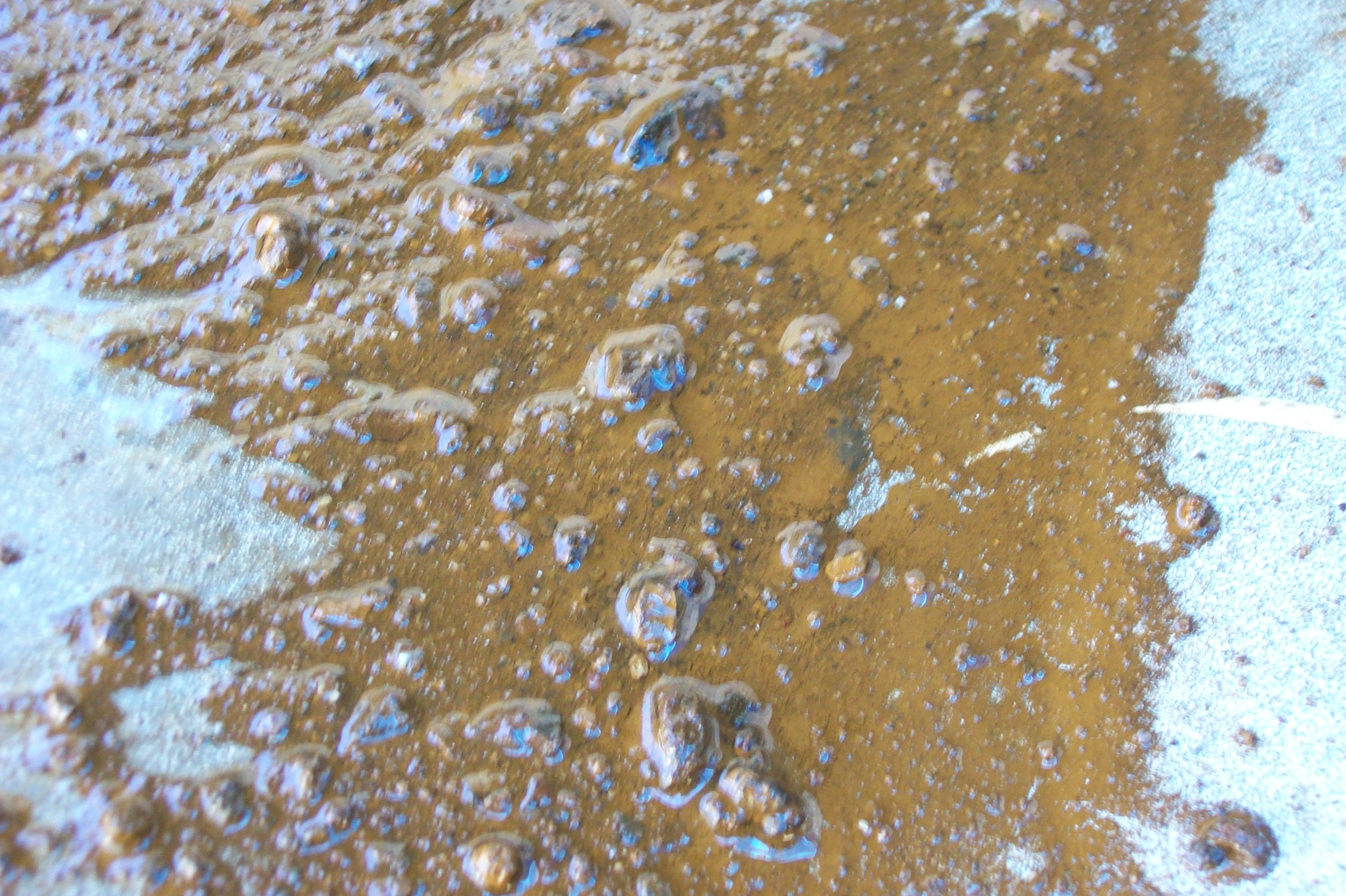

Wed Nov 06, 2013 11:59 am
Welch plugs and muck
File comment: side ofblock
Wed Nov 06, 2013 12:11 pm
just make sure you can get cam bearings before you go acid bathing it :!: they are a little hard to find ;)
