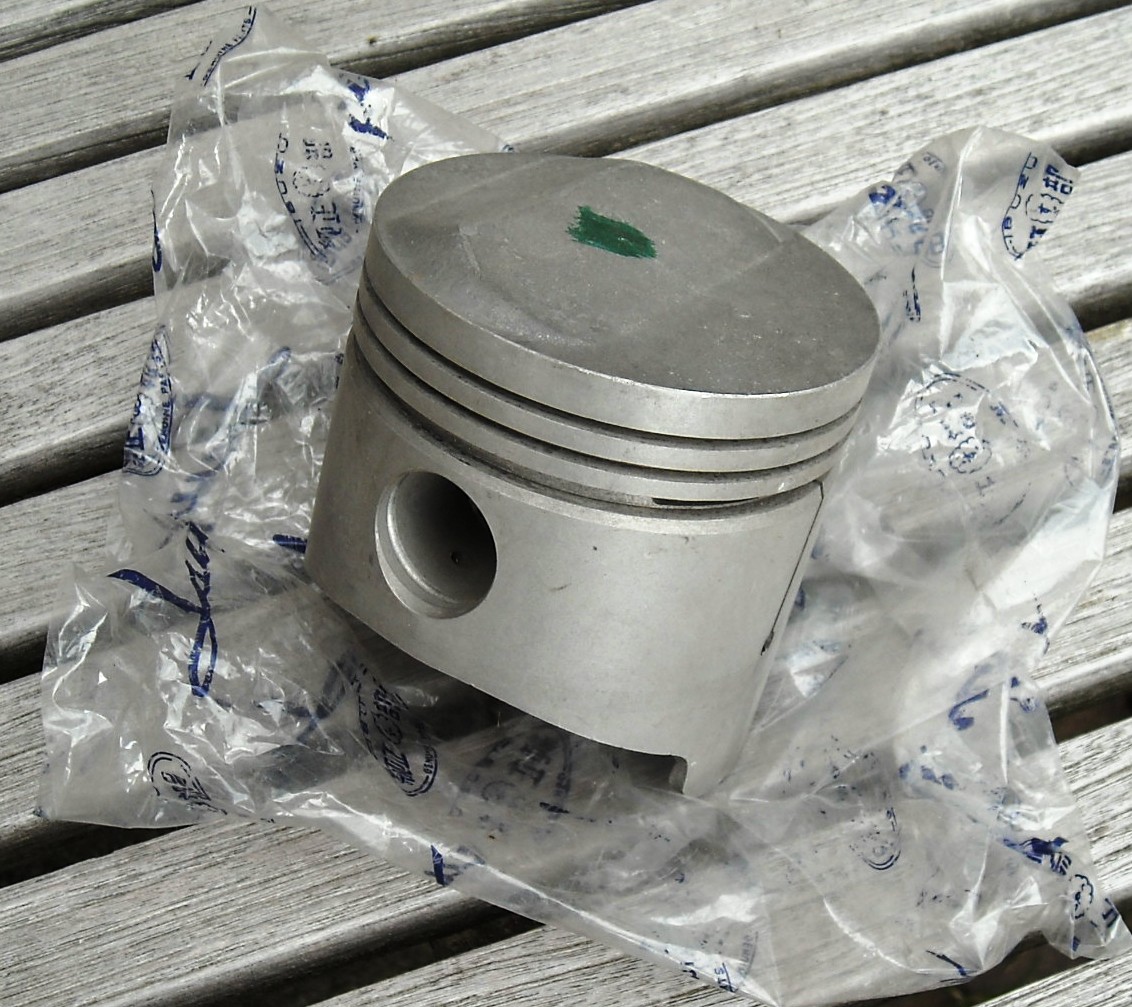

does anybody know if these pistons are correct for the 1800cc SOHC Bellett engine, not Gemini ?
eBay Item number: 280667719480 (April 2012) They are 84mm +0.75mm (30thou)
My understanding is that is correct bore size (overbored), but is there any difference in the pin height and that sort of thing?
Also, I think a Bellett SOHC is standard CR of 8.7 : 1
Anybody can confirm this ?
Overall, if these pistons will fit, what is resultant CR assuming standard head (not shaved)
Finally, a part number or source or whatever for VRS set for the engine ??

These pistons will fit but the crown of the piston is like the gemini. You will loose some compression. The piston pin is also different; not with the fastening clips but a pressure fit; so you need to adapt your pistonarm (little) bearing or machine the pistons for the rings.

Thanks for that info, Dick.
Sounds like the proper pistons have a dome on them. Since they CR is relatively low already (compared to modern engines) it would lose even more unless drastic amounts possibly removed from the head.
Re the rods, it might be possible to use Gemini rods instead of the Bellett ones.

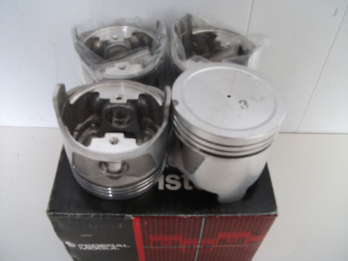

To make things clear I made a pic of the right piston with the cam on top.
It should look like this.
The Chevy Luv has a flat top and compr ratio of 8,2 :1
The Gt has the cam on top and a compr ratio of 9,7 : 1
So you loose some HP fitting the flat tops, but with 1800 cc it will be enough HP left.
These original sohc pistons will not be possible to find I think (by the way, it is a 1600 - standard size - piston for a sohc engine in this pic ). The flat tops are available, I have them on the shelf my self too.
Fitting can be done with later type rods without modification.
groetjes Dick

Could i trouble you to measure the height from the pin to the top edge of the piston of both types, since you have both there?
When you say flat tops you have also, do you mean with the dished top like in my initial picture? Or a true flat top?
