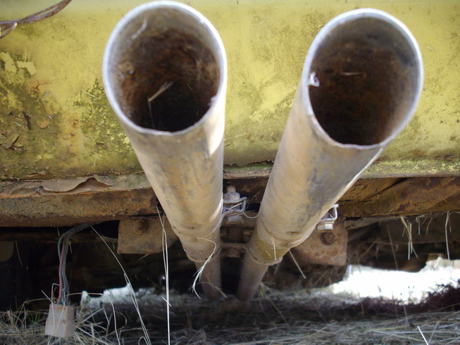

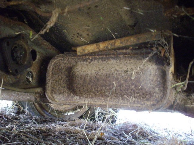

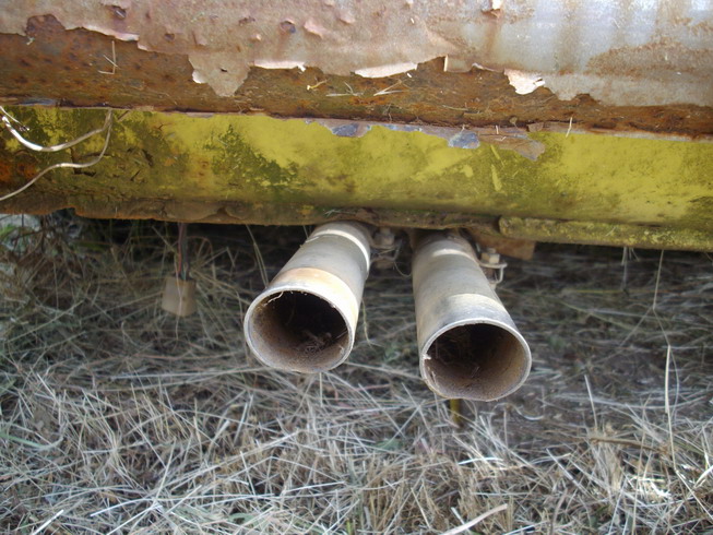

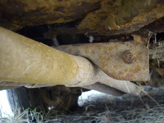

Hi JT, sorry I'm so slow to get to this, hope it's some help. My parts donor is fitted with an original equipment system (aibeit rusty). When I get to taking it off to copy, I could take more pics. Original muffler with heat shield. Attachment:
Outlets - 32mm / 1 1/2 inch Dia. (inside) Attachment:
Twin pipes from side outlet of muffler (single pipe from headers to side inlet if muffler) Attachment:
Detail of rear support - shaped bracket, rubber block mounted. Attachment:

Is it possible that there are two different versions of the GT exhaust? The pictures I have seen show a muffler behind the rear bumper and a resonator under the rear seat. Your picture titled muffler looks like the resonator under the rear seat.
But the tail pipe arrangement picture provides some good details that I can use to double check. The pipes are actually 25% closer together than the pipe width. I will have to reproduce that angle cut with stainless pipe.

the "earlier" style is what farmer has posted, and is the most common GT pipe layout, with a single muffler under the backseat and straight thru pipes out. the "later" style had a resonator under the seat and a muffler under the boot (trunk for our u.s. cousins) floor. it seems that this change happened around the time of the release of the GT-R in mid 69, and would explain why 68 1/2 GT's like Dave's have the earlier style and Rod's have the later style, even though they are both the same later version PR91's.
