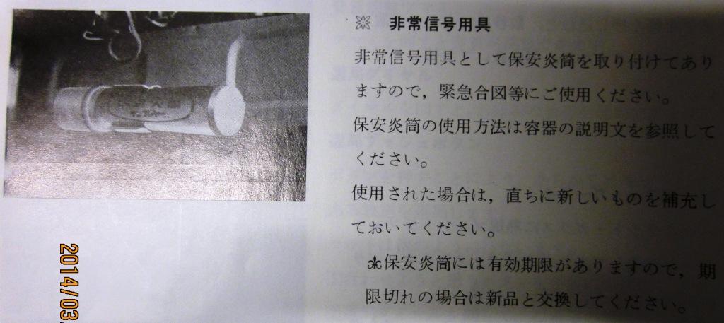

another little thing, my car has a bracket in the RH side above the gas pedal area for an emergency flare. On the strengthening bracket late cars have. Also has the flare too ! It's also shown in the Owners Handbook so is original.
