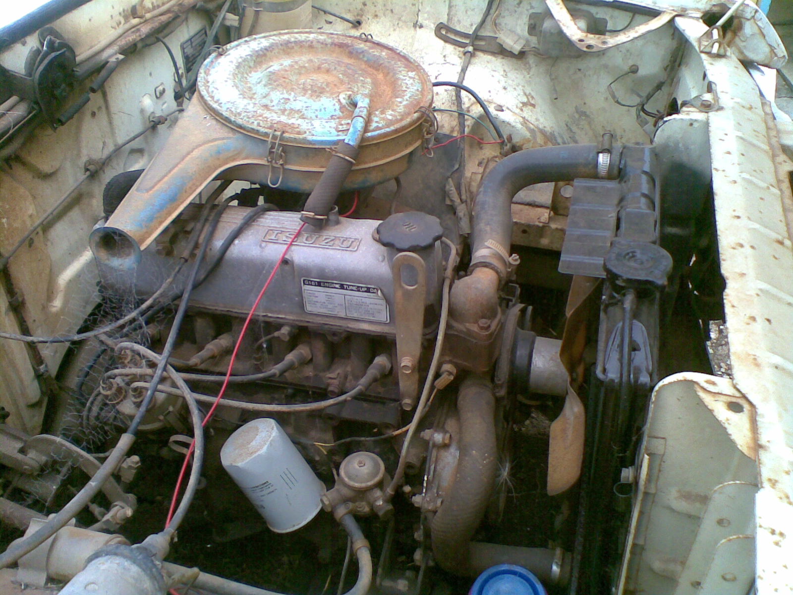

Well I have posted a picture of my engine below. Does this look the same as yours Pa_man?
Nicko
Fri Mar 14, 2014 10:59 pm
I took a photo of a friends 72 as my engine does look the same. Looks like they all look VERY similar except under the skin!!

Looks identical doesn't it!

Hey Josh, looks like your friend needs Donkey and I to pay a visit and blow those cobwebs out of his Luv :mrgreen:
Sat Mar 15, 2014 8:09 am
This is Oz's Luv, mine doesn't have as many cobwebs :D
But always welcome a visit from donkey and you.
