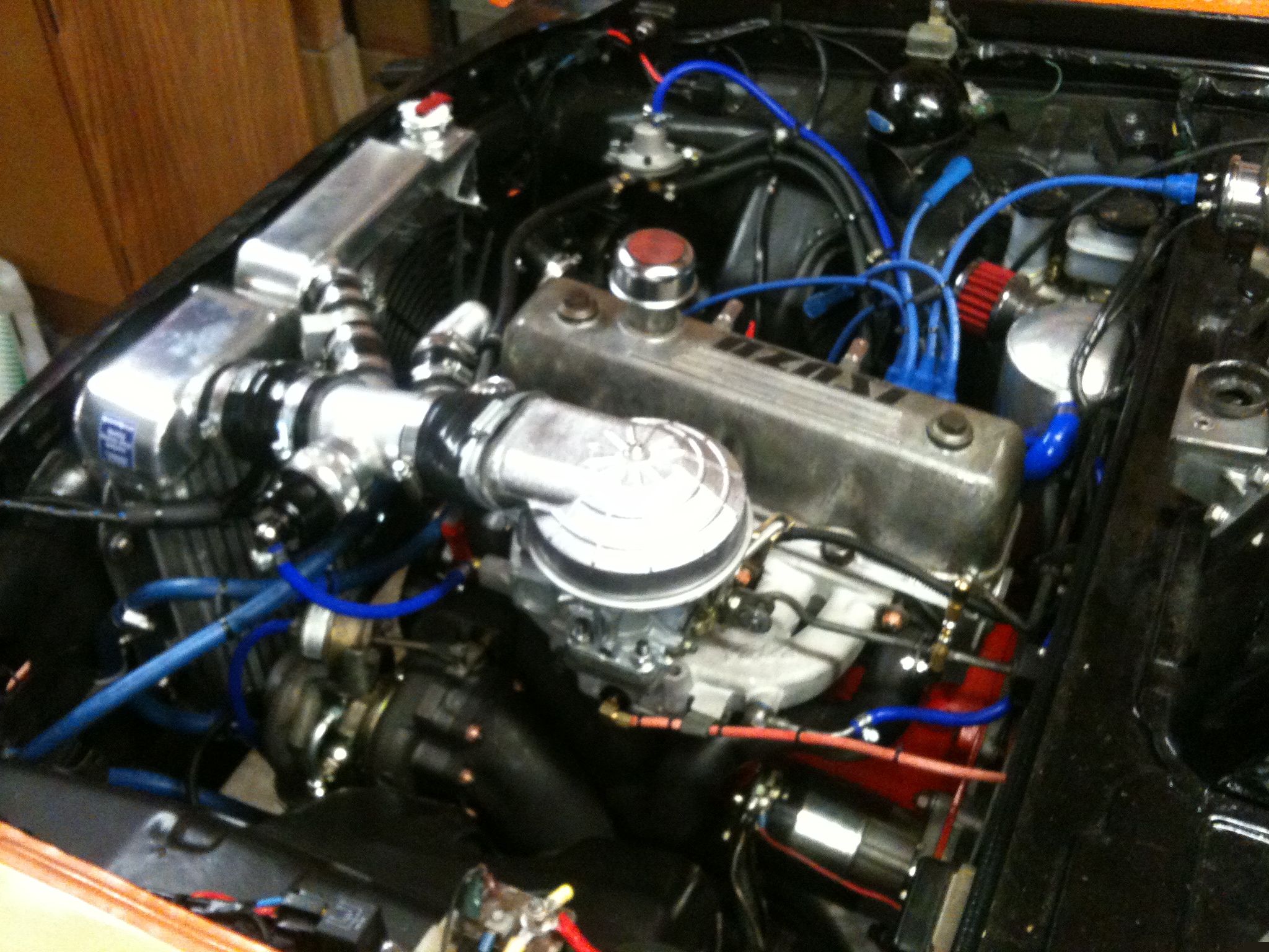

Is this a Z motor? aka Gemini
If so try Ben at
http://www.turbogemini.com/
JD
Thu Nov 20, 2014 4:27 am
Its not the gemini engine in Anthirons luv. Same basic engine as the florian (with minor differences!)
Thu Nov 20, 2014 4:40 am
Posts: 428
Location: Sydney NSW
In that case
Feast your eyes
Been there, dont that
JD

Any details on your setup asroc66?
Thu Nov 20, 2014 4:58 am
Posts: 428
have you got a month and a lot of beer!
That's just to tell u how to build it
It took me over a year to make it a reality (actually more like 3) :o
