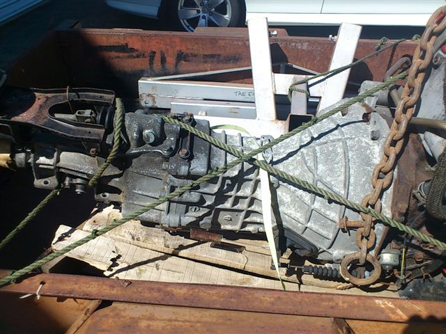

If a genuine DOHC 5 speed (pictured) is used, the lever comes out a long way back and much higher. A new trans hump like a GT, will need to be fabricated in that case and welded in. Also, the handbrake lever has to be moved back on the tunnel to clear the shifter. [you could elect to just use the Bellett 4 speed though.] The 5 speed g'box uses a cable operated clutch. You can use this system if you get a cable sytem from a Gemini and alter the clutch pedal to take the end. A largish hole needs to be drilled in firewall to take the cable. Or you could change clutch to hydraulic operation. In one conversion i did this using (i think) a Toyota system.
For either 5 speed, the rear mount under the trans has to be modified as the mount is approx 80mm further back. In fact past the crossmember. There are couple of ways of doing this, you could cut and shut two cross members to get the holes moved back, or extend the existing cross member using some heavy plate. Depending on a posisble engineer being required (?) you might have to use their reccomendations. I doubt anybody has used an Eng. though ;)

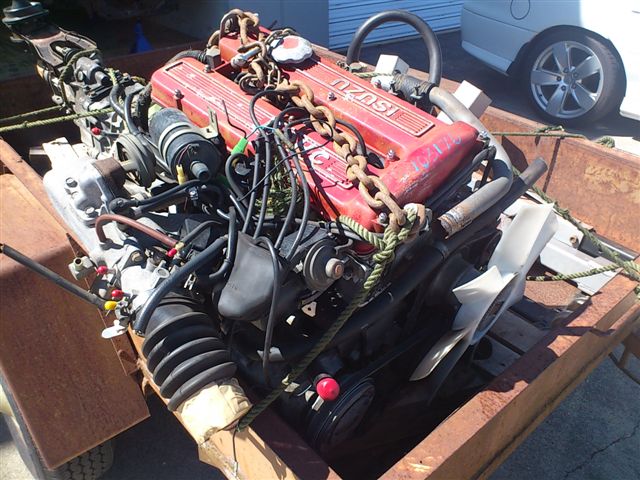

File comment: 2litre DOHC engine with early EFI

The engine pictured is the same so I will need to look at the oil pump/filter to check orientation. The engine comes with a clutch but no gearbox.

The gear box I have, pictured above is from a 117. If they are so-called 'close ratio' i have no idea.
