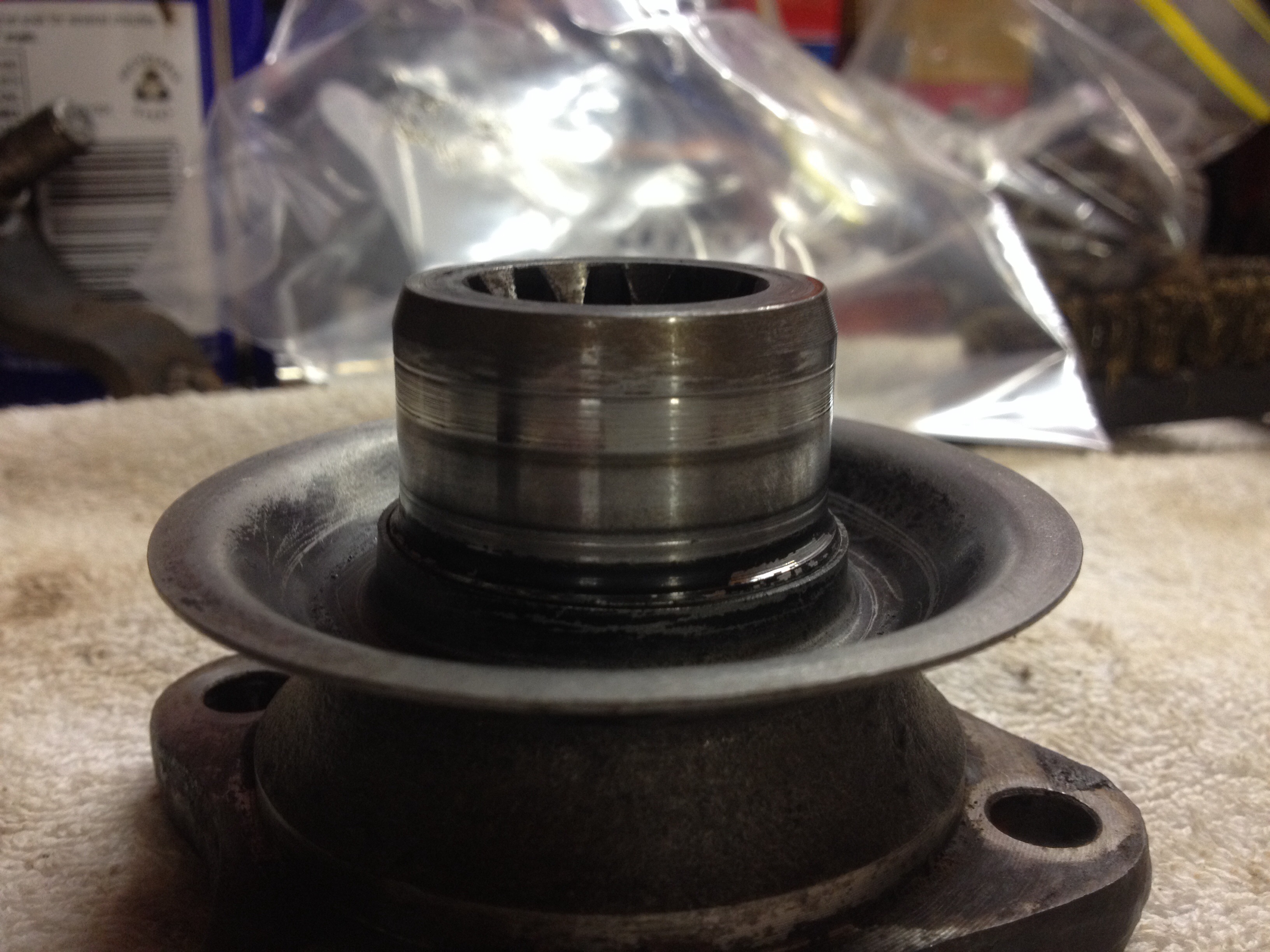

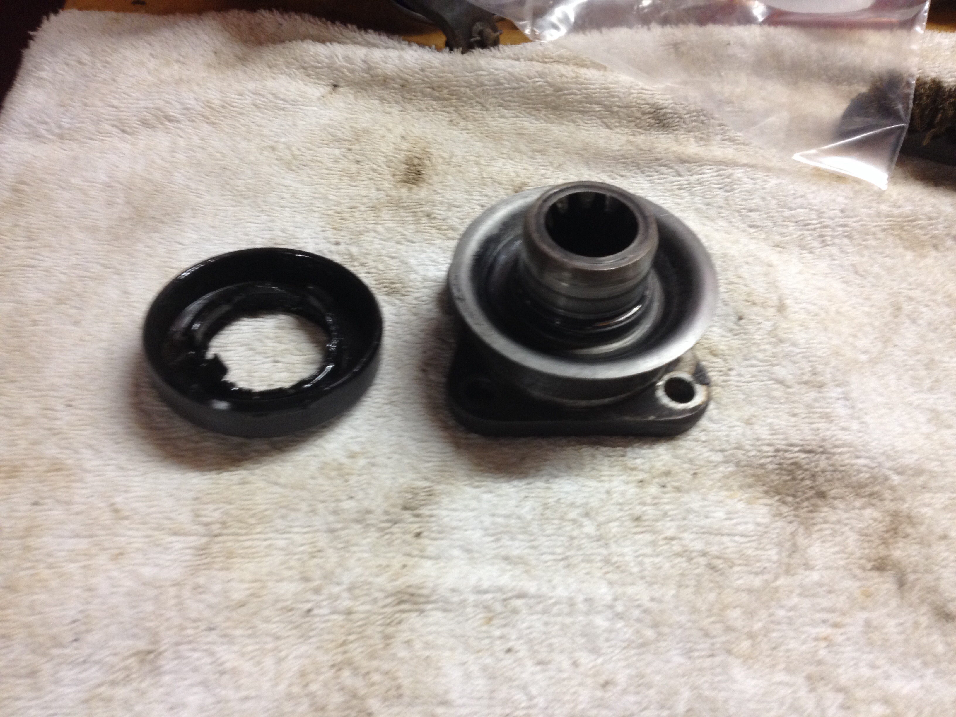

Eureka
It fought me all the way but bit by bit got the yoke off
50 year old Seal hard as hell and a real sh@# To get out lying on your back on concrete at 0' but hey, that's a heat wave in Tassie :lol: ..
The yoke will need sleeving as u predicted I am Afraid
J

Wed Jul 08, 2015 8:11 am
Posts: 428
Location: Sydney NSW
Speedi Sleave
Best invention known to man

No probs. J. We see this at work quiet often.
