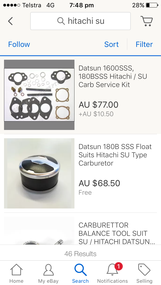

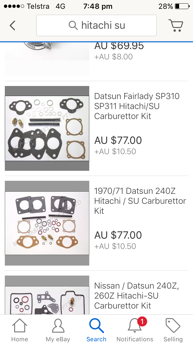

These are now on eBay
The Datsun SU Hitachi's have the offset bolt/stud pattern so the gaskets to inlet manifold are different but everything else should be same
I run these plastic floats as the brass all eventually fail
J
