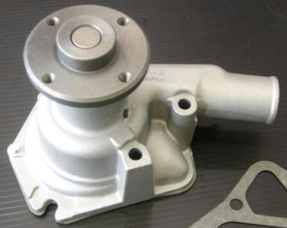

Hi again, is this the one for a PR91?

Have found a source for new water pumps.
Stanmore Auto Spares
03-389 4555
245 Stanmore Rd Christchurch
I believe he has access to 8 as of 22 May 2009.
I found him through Trademe and paid NZ$83 incl shipping from Christchurch to Bay of Islands NZ.
I'm expecting to receive my pump in the next week.
Will post to confirm.
Hope this helps.
Fri May 22, 2009 8:51 am

Water pump arrived today. It's a new pump made by GMB in Japan www.gmb.jp . Part number GWIS-13a stamped with number 7y05.
Really pleased I could get a new one and will get it fitted this weekend.

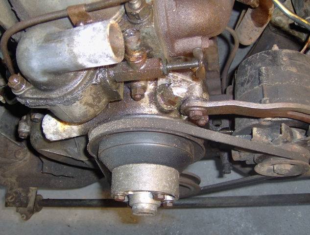

Hi I'd like to jump on here with some questions about the cooling system, ( before I BREAK something) the area of concern is the fittings on water pump that delivers water to the heater core, they are shot and in need of replacing, the entire system is apart and being cleaned.
Is there anything in particular we should look for?
Can the fittings be removed without cracking the water pump housing?
Can I remove and plug these connections without the engine overheating? (Hot & Humid here)
We'd appreciate any advice and comments from the crowd .... 8-)
Thanks
Mark&Jeannine
Thu Sep 03, 2009 11:38 pm
Hello Mark & jannine,
my advice here is - be vewy vewy careful. I once destroyed a perfectly good pump trying to remove a plug, and the car was only 12 years old! The fittings have a habit of welding themselves in, chemically I guess. Base model cars were sold here without heaters, so no probs with closing them off. Simplest thing if you have fittings & don't want a heater is to run a short hose from one to the other, I've done this when a heater core corroded out. In my experience, Belletts seldom run hot, unless the radiator is blocked, even in western Sydney's high 30's (high 90's F) & 90%+ humidity summers. (Ooooh, glad I don't still live there!)
Hope this helps, (& hope Florida gets sea-breases!)
Cheers, Matt. (Current outside temp.-3 deg. C - 9.30 P.M.)
Sat Sep 05, 2009 11:30 am
Posts: 211
Location: Florida
Matt,Thanks man .. yeah careful is the word, I had a feeling that those fittings would be a bugger to remove,the lower one is f'd up and we're really going to have trouble getting a hose on it,but we will work it out ... glad to know you can plug them without overheating.
