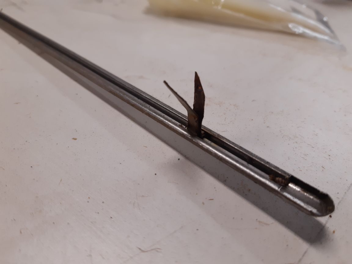

Does anybody out there have any of these clips they wish to sell or point me in the direction to obtain some?
The secure the stainless strip on the inner door cards and rear quarter. I believe they are unique to the GT but could be wrong.
Peter

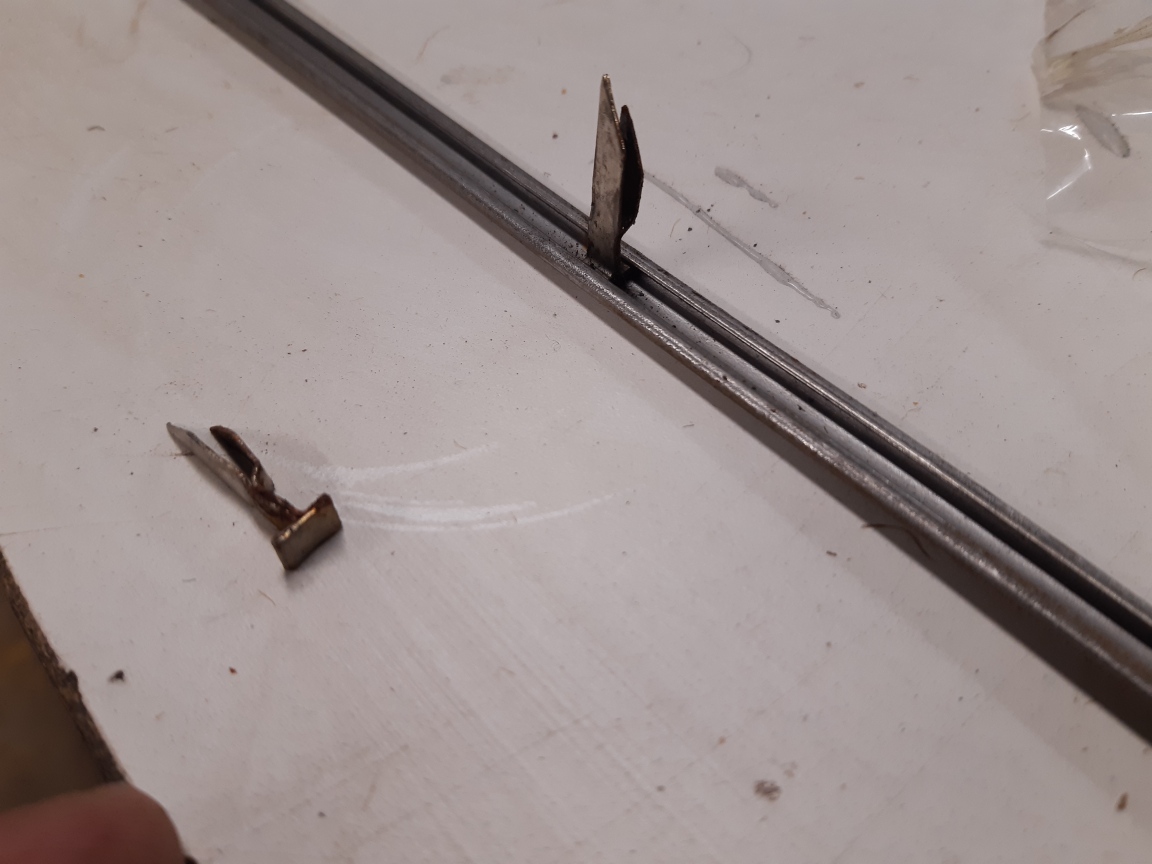

Thanks Guys for all your help with this. Paper binders are the way to go and I have found the perfect fit with a little trimming.
Thanks again
Regards
Peter
