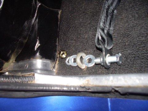

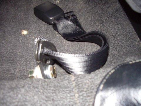

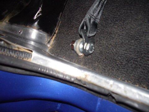

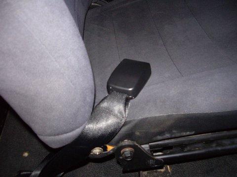

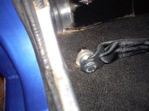

Hi guys. As an add on to the seat replacment, Clyde asked about the seatbelt assembly. Here are pics of the outside "swivell" assembly in position, as well as spread apart, and the inside static hip belt. Also pic of hip belt adjustment in relation to seat. Again, positioning and configuration depends on the original mounting point of whatever classic you want to fit the new belts to. This might include if your original mounting points are sound and strong, or if you need to remove the old ones and modify.

So the eye bolts are original? I had thought maybe someone with a drill had just dropped a few holes through the floor panel, in semi random spots, for a retrofit.
In the seat thread, the comment was that these are extremely well reinforced and could not possibly rip out of the floor.
I don't know if they were deigned for use with bolt on seat belt ends. Someone who knows bolt strengths can comment and correct me. I remember suggesting welding a seat belt mount for a different application and someone quickly told me I would be responsible for everyone else's welding ability and eminent death. Looking at a bolt through an eye bolt makes me nervous.
But they do look like they were designed for use with clip in seat belts, like the older style racing belts.

I made comment in the previous post that safety is paramount. Going by the photos of the mount of the belt they are not correct. The eye blots are designed for clip on harness types. The bolt from the belt should mount through the floor, either into an original mount or through a reinforcing plate under the floor. No extra welding is either required or allowed. Seat belt bolts are a standard size (which escapes me) world wide. Next time you are in an auto shop go to the seat belt area and have a look at the aftermarket kits.

Although the new assembly through the original eyelette is super steardy and secure, and would need some pretty serious shunting to move anything, I realise now the eye was originally intended for a clip on belt end as shown by JT191, which could swivell around in any direction. Definitely no add ons or welding to the eyelette, out of the question !!
Thanks for shining more light on the topic guys.
