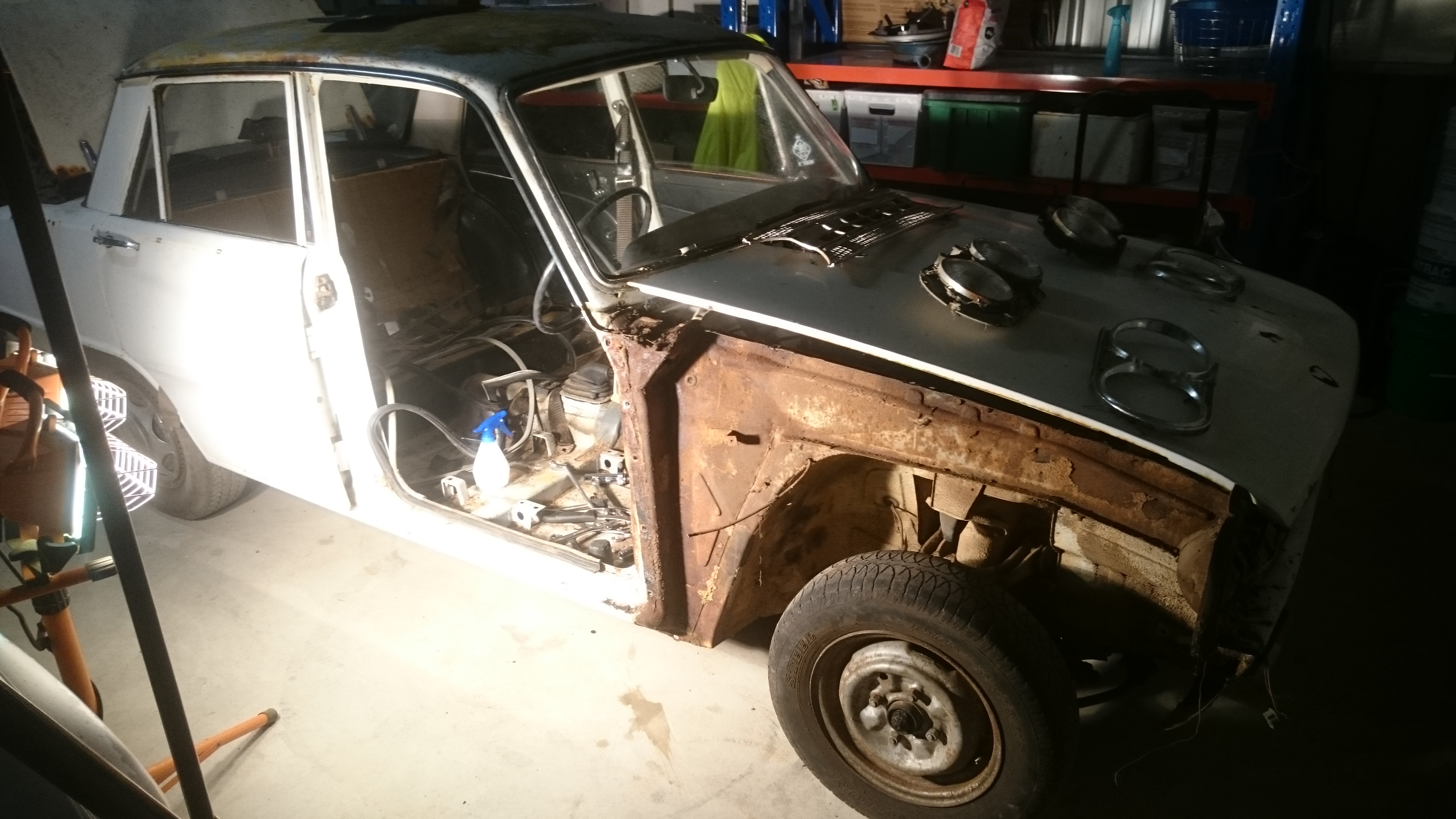

Had a win... Did have all the bolts out. Sealant holding front guards on looked like sikaflex had the hit a sharp knife around joins using a mallet :? . Got door off with persuading it with blow torch and impact driver. On to the other side now

Posts: 259
Car(s): 1967 GT Bellett
Looks tidier than most
Keep up the good work

Posts: 280
Location: Hobart
Well done. Sometimes it can be a pain getting stuff off. Bolts and nuts are often not obvious but then you had to solve the sealant problem. It's good to see you wanting to do a strip down as you find so much stuff that will only cause problems later. Good luck with it. It all looks good from your pics.
