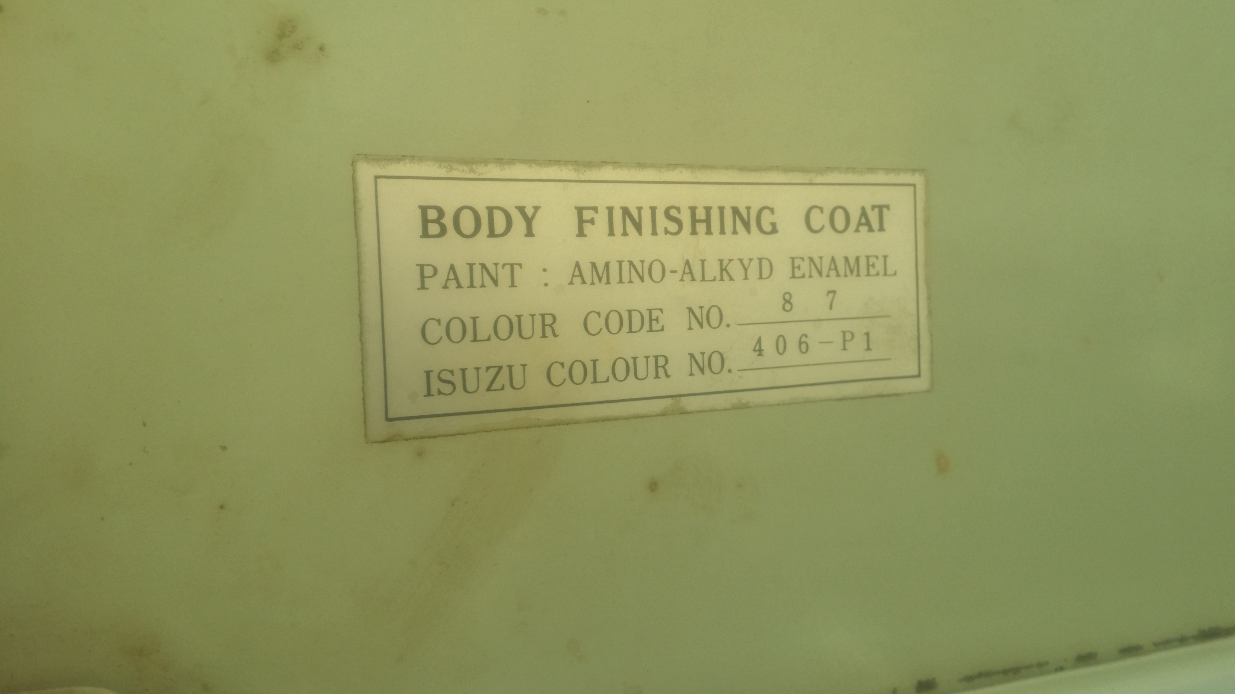

Hey All ...
Thanks for the paint code listing JT, here is the lable from under the bonnett of the PR10 .....
Later
Mark
Later
Mark
Retroasted
- Posts: 230
- Joined: Tue Aug 14, 2012 10:55 am
- Car(s): Isuzu Bellett, Morris Minor 1000
Re: Paint Codes
Would that be Glacial Blue?

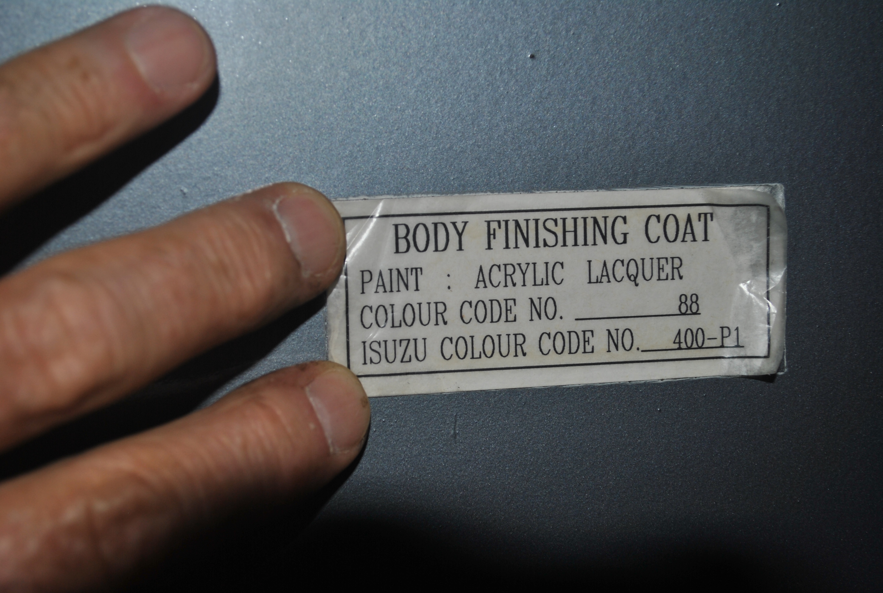

1968GT
- Posts: 1266
- Location: MUDGEE. NSW
Re: Paint Codes
Hey Brett, does your listing have my paint tinting quantities? Code 88.

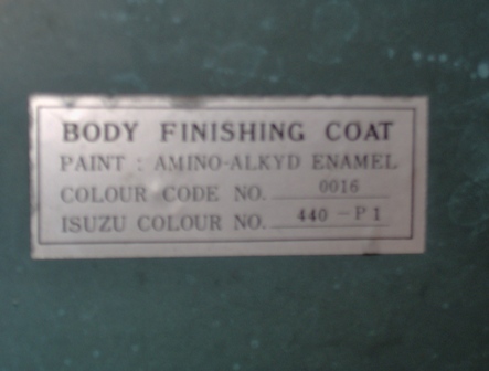

during the cleanup while moving house, i found some paint codes. More importantly, i found the actual Dulux mixes. I will bring them up here asap.
