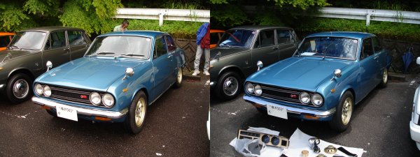

I tracked down pictures of Glenn's and Dave's cars on the internet. I did not know it was the same car. The lighting is different in the two pictures, which makes the paint color look a little different. I found two pictures of another blue car that were taken the same day, one picture overcast, the other sunny. It looks like two colors of paint.

File comment: blue car
