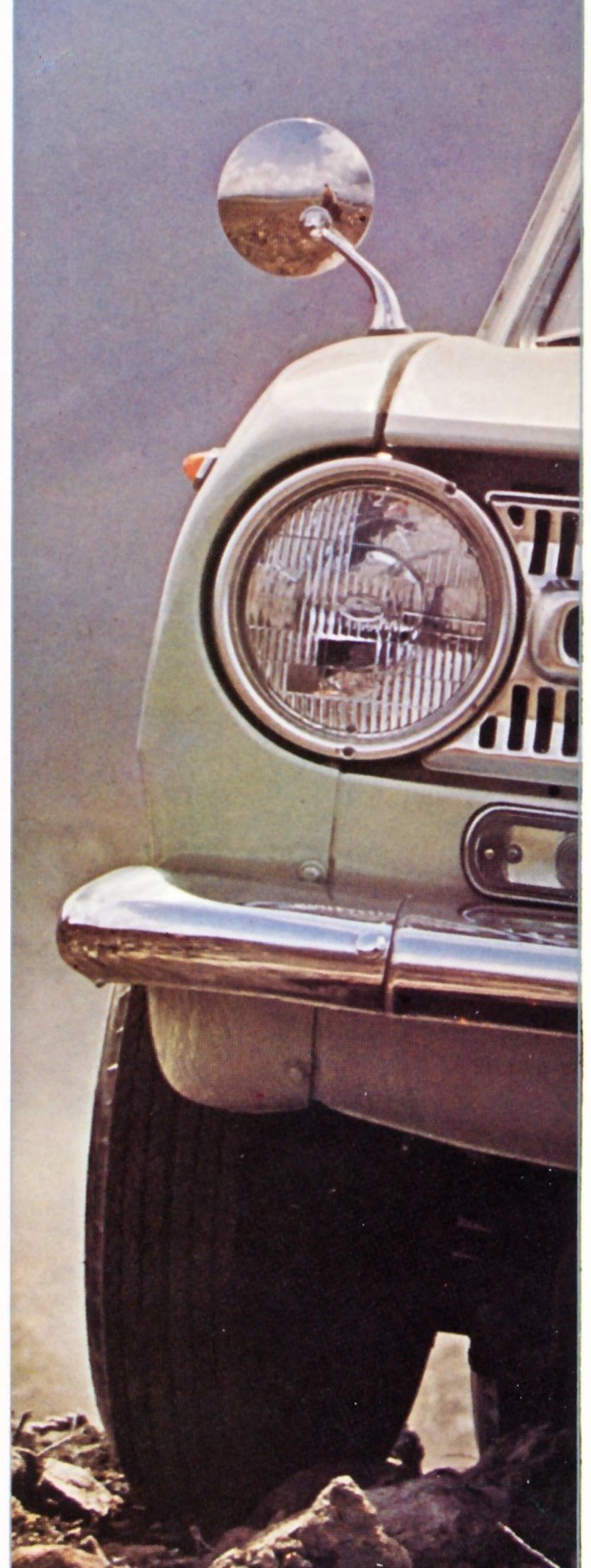

Hey George,
My understanding is that they droop down, with the long, curved side on the top and the shorter side underneath.
You can see what I mean here, in this brochure shot of a rare, 2-headlight 1964 Bellett 1300.
1964 Isuzu Bellett 1300 brochure - Japanese - 12 pages - 08 - portion.jpg [ 185.43 KiB | Viewed 39844 times ]

This is correct. Longer side to the sky. Don't put 'em on upside down 'cause it just look wrong!
Same as teardrop grille badges - thicker edge to the top. Otherwise the symbol says Uzusi. I suppose!
And 66 1/2 to 68 front parkers. The targety bit faces straight forward, not to the side.
And late overriders. Left and right front are shaped to face forward so that if you parked against a flat wall, the whole rubber would be in contact. And the rear overriders are different as the bumper is straight.
