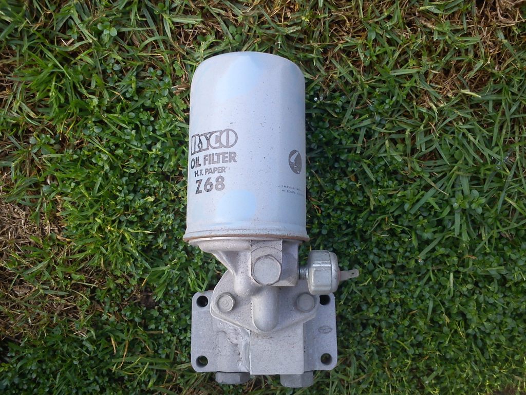

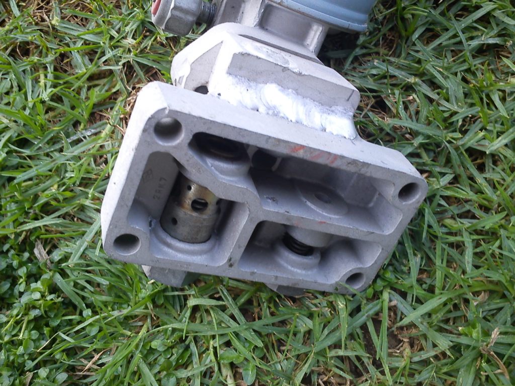

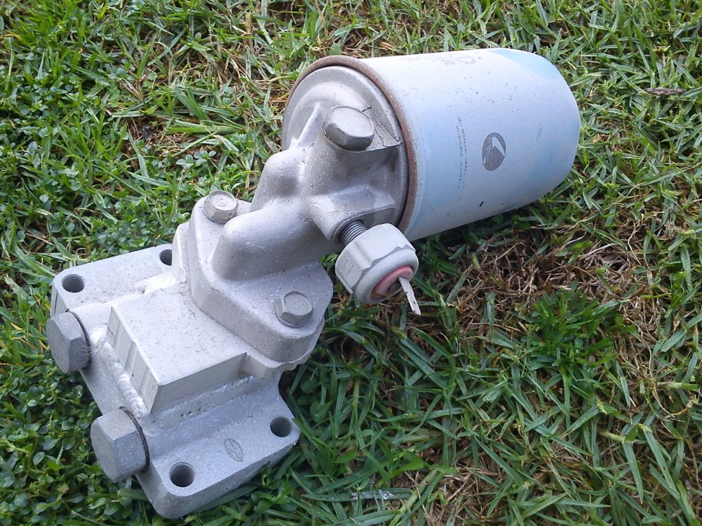

As mentioned in another area, I made up this spin on filter adapter some years back (many years)
Uses the original Bellett block on side of engine with an adapter machined to fit an early Corolla engine's (the slant engine) similar block. But used this so that the Z68 filter fits and also has a place to put in an oil pressure sender.
Caveat here is that I never fitted it to an engine.
File comment: the modified block from bellett engine

pretty neat job there, Glenn
pity you never got to try it out
