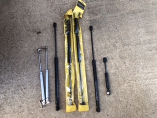

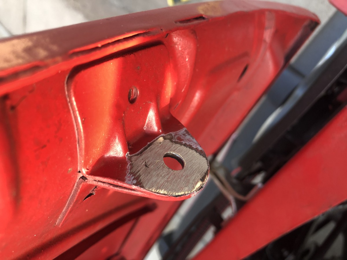

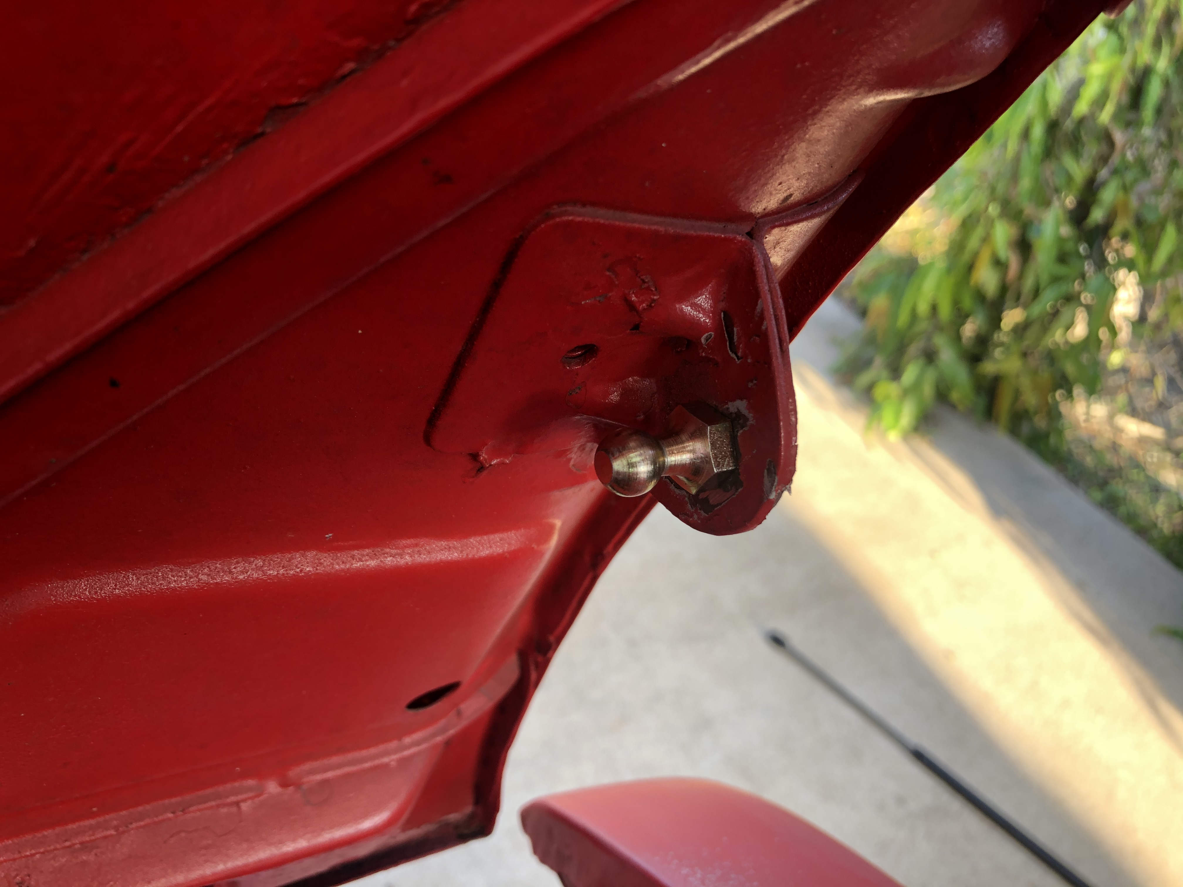

This is what I have so far. I would love to do the boot too.

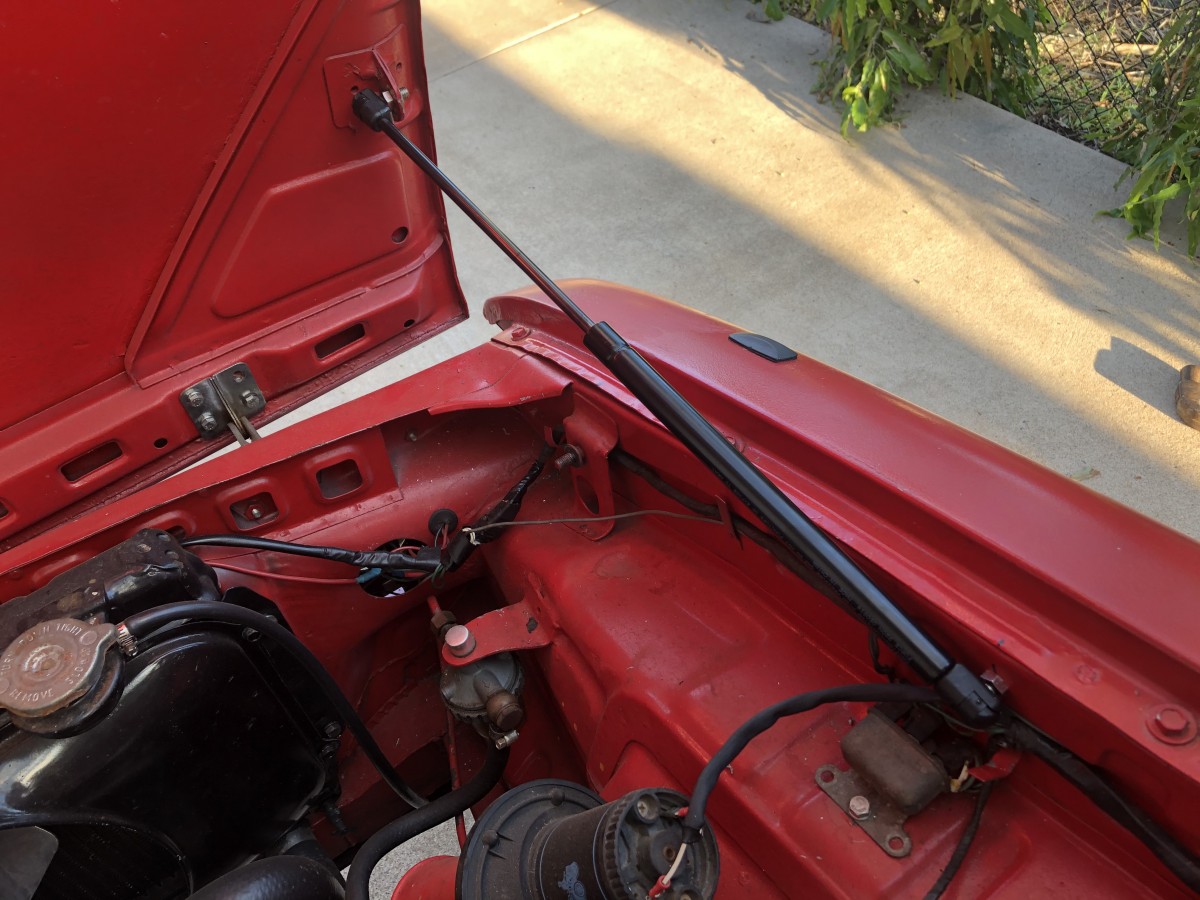

Soooooo - I have been thinking about doing this for YEARS..........15 minutes later:

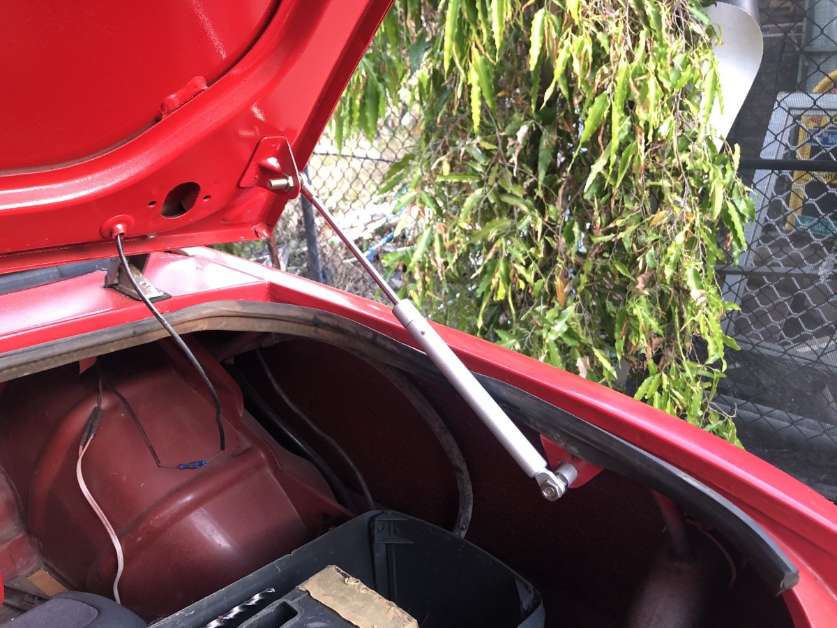

And I did the boot

Hey Glen,
Yes thank you - you certainly did.

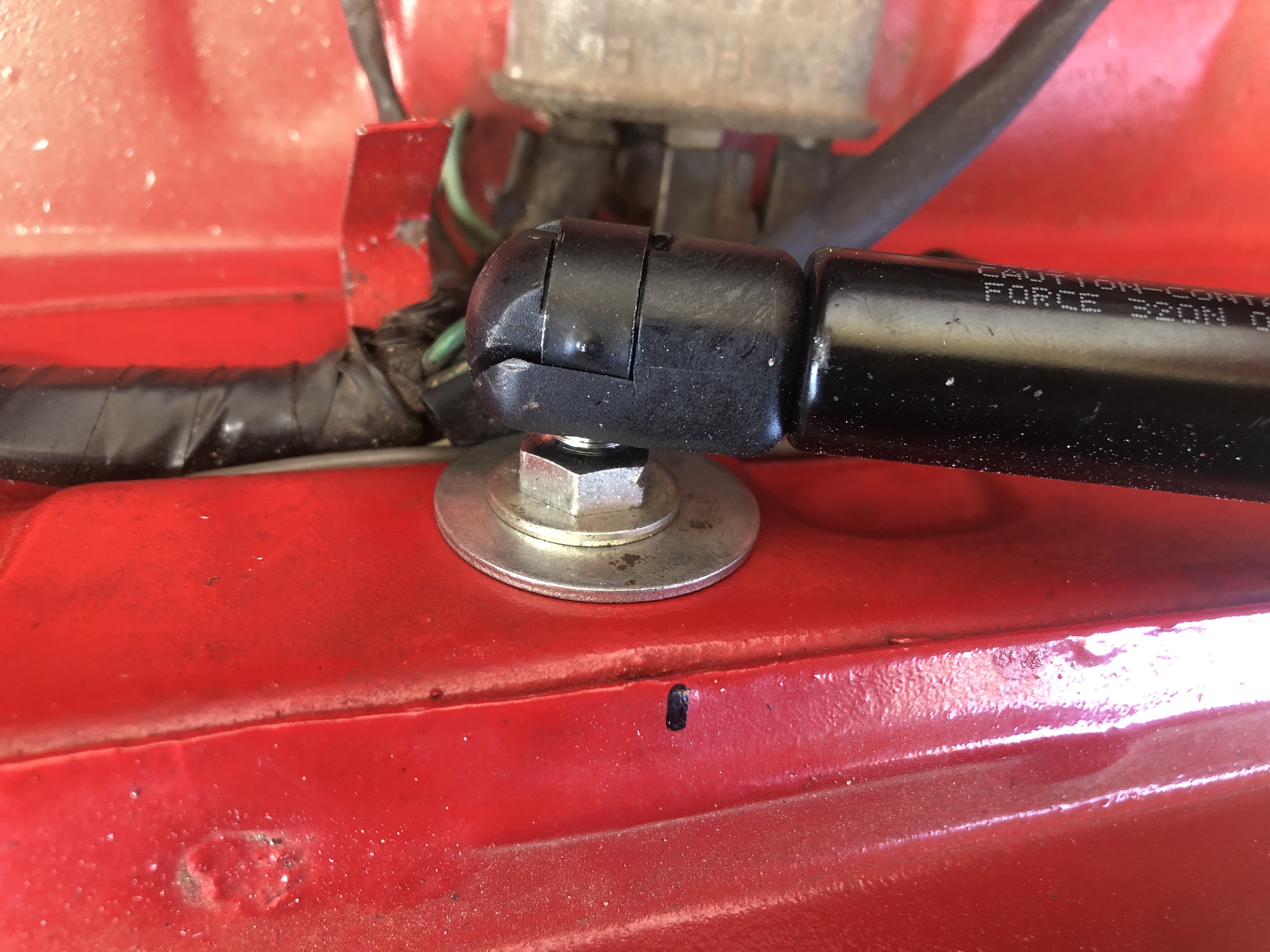

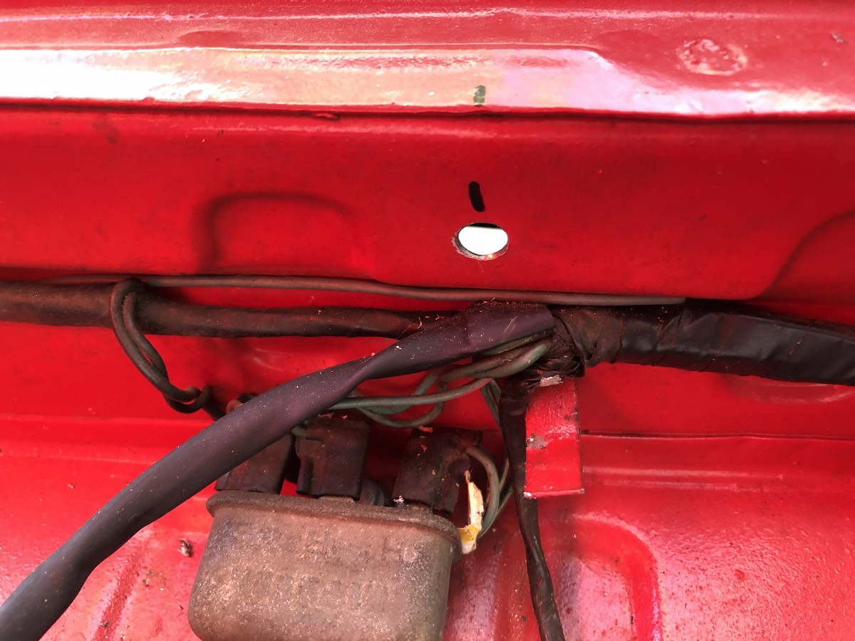

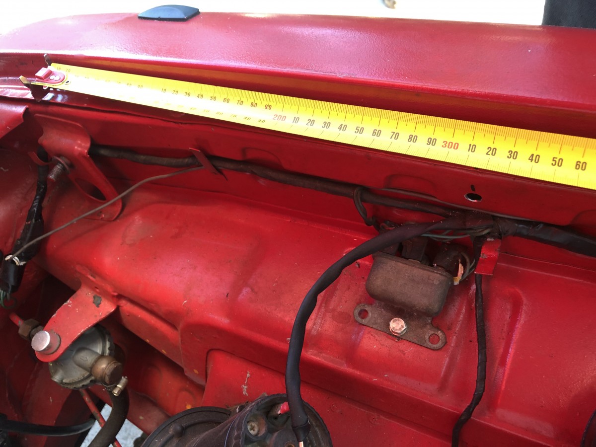

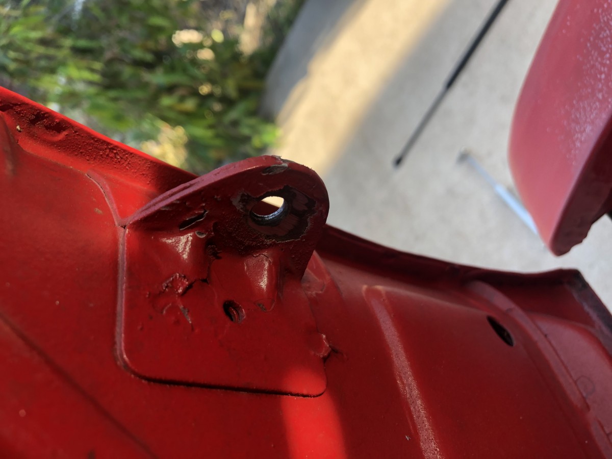

Ok here are the details.
FRONT BONNET STRUT:
Calibre CSS311 - new from Supercrap Auto.
It is 500mm from hole to hole extended and 311mm closed.
STEP ONE: You have to cut and grind off the stud on the bonnet side of the bracket and drill it out to 8mm to pass the ball stud through. Prime and paint the bare metal.
Step Two: Measure 318-320mm from the original lower inner guard mount and drill a hole 8mm. Prime and paint the bare metal.
Step Three: Insert the ball end studs in the bonnet and the inner guard and retain with nylock nuts - you MUST strengthen the inner guard with a plate (I used a large washer both inside and in the wheel well area) or the inner guard will flex too much from the force of the closed gas strut.
Step Four: Install strut and test a couple of times and make sure it is not binding.
In my opinion the area on the bonnet bracket is a bit weak and may be prone to kinking as you close it - so I "help" the bonnet closed by pushing near this bracket as well as from the top corner of the bonnet.
NOW FOR THE BOOT.
I used and gas strut from a old desk that had a hydraulic keyboard height adjuster. They are 290mm from hole to hole in the open position (which I think needs to be longer) and 180mm hole to hole in the closed position. With a lifting weight of 12kg. This just bolts to the original brackets with a 12mm spacer on the bottom to align the strut properly.
I hope this all helps.
Let me know if you have a crack to install some yourself and post your photos please. :)
Good luck and enjoy doing this great upgrade to your Bellett.
