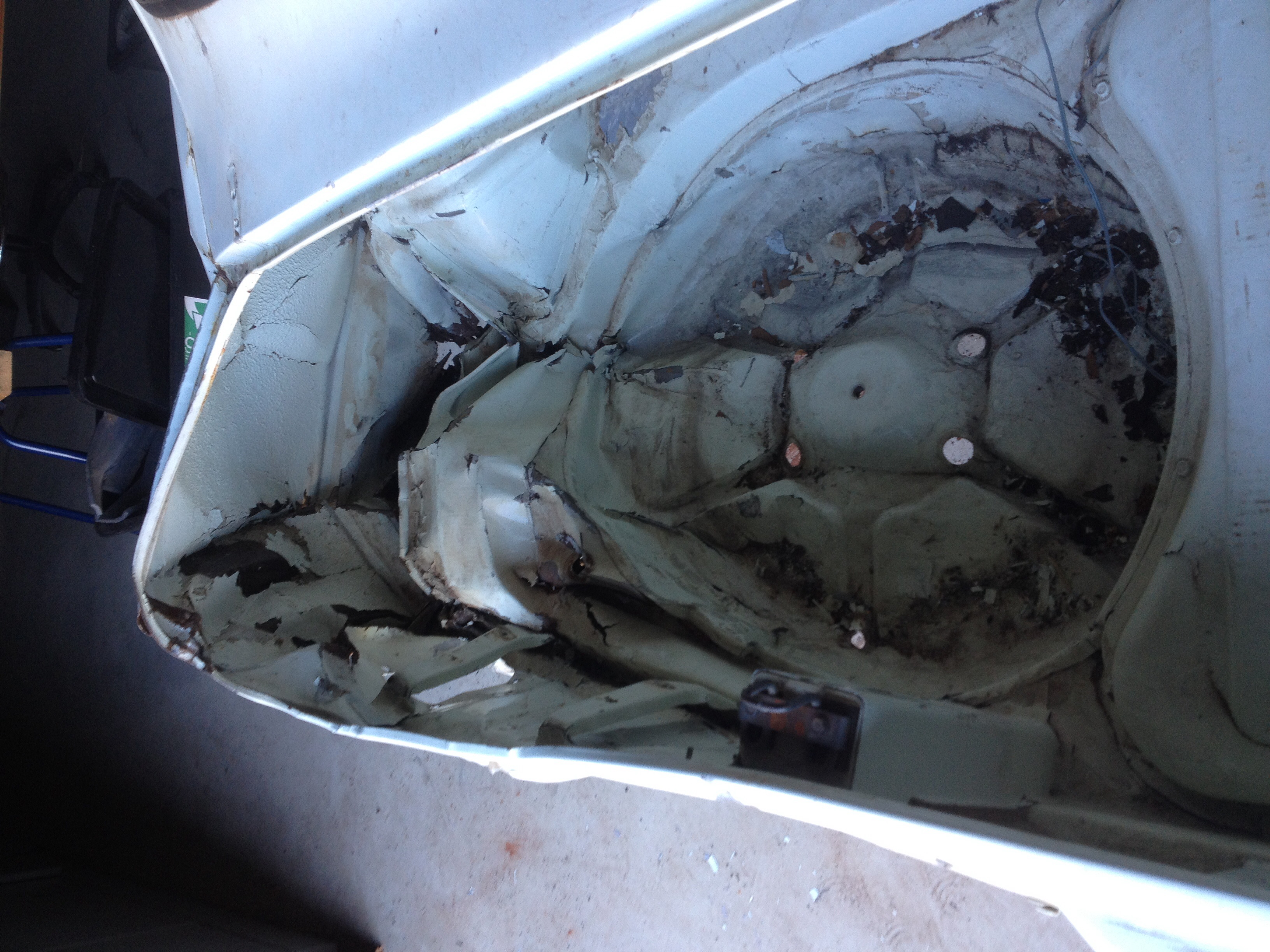

This is a pic of inside the boot (for those who don't recognise it :? ).
Spare wheel was jammed in pretty damn tight, so after it was completely deflated and with a little prizing from the 6 foot crowbar it finally popped out.
The fuel tank flange (were the two parts are joined together and bolted down) was slightly bent. It'll survive ok.
The actual subframe or rear bulkhead (inside guards, a frame support pieces, rear seat bulkhead, etc) area is untouched. Just all the rear panelwork needs replacing.
The outside panels forward of the rear of the quarter glass should "de-stress" after it gets a stretch on the rack or the rear panels get cut off.
No doubt a lot of work, but that'll be done by someone who knows their stuff (hopefully).
Happy to read/listen to any advice that people may offer. PM's welcomed if commenting in public isn't your thing.
