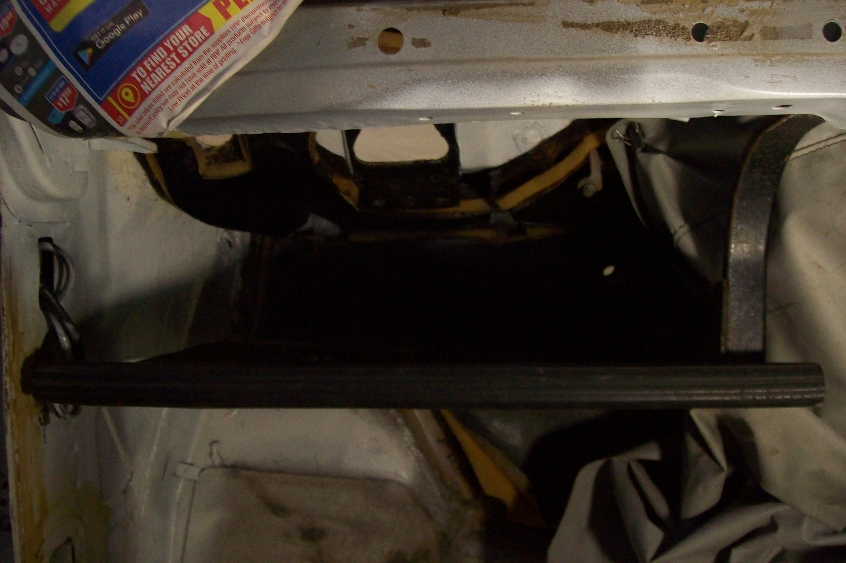

I made mine up by cutting an old biscuit tin (with scissors) , hold in place with a couple of self tappers, and then sealed it with silicon and painted. I then sealed this part to the body with reinforced duct tape after it was bolted in . Works very well. It cannot be see when installed.

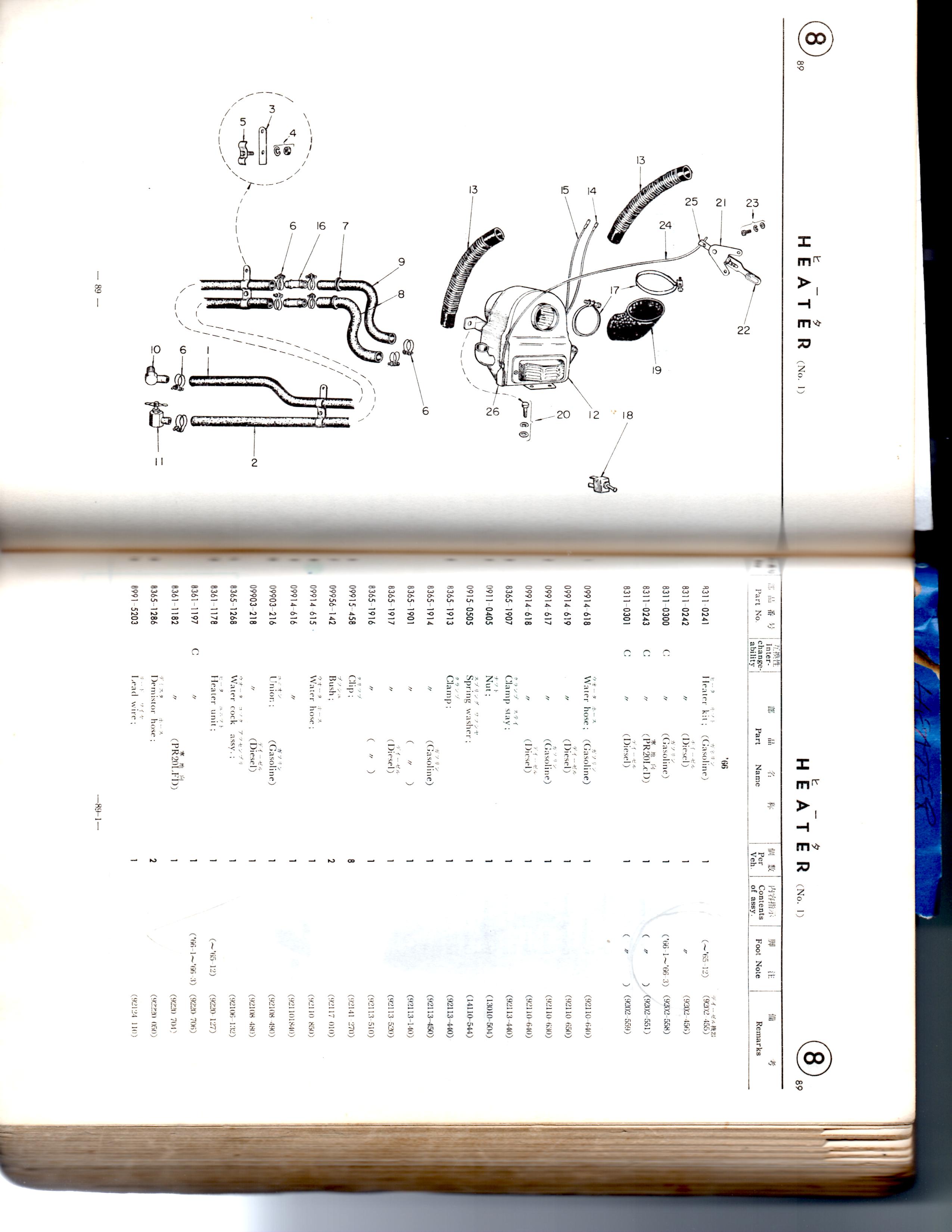

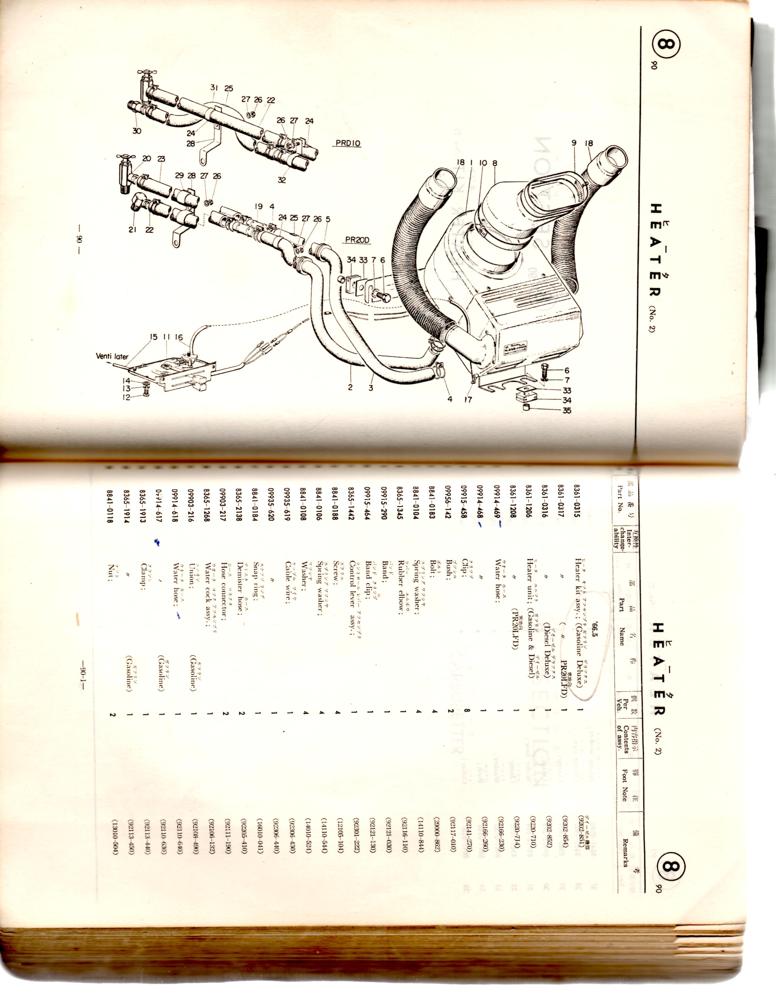

Diesel Kiki had the contract to supply the heaters to Isuzu. Just looking at the diagrams in the parts catalogues shows the early vehicles had a rubber round elbow between the plenum inlet and the heater. Isuzu changed the inlet to oval and Diesel Kiki didn't want to change their tooling so they came up with the oval to round elbow. Which is a part of the vehicle when disturbed splits or fall to bits. I'll try to upload the parts listing to show you what I'm referring to.
Sat Jul 31, 2021 12:12 pm
Parts listing for heaters. As you can see the difference between the early duct hose and the late.
File comment: Early heater unit.
