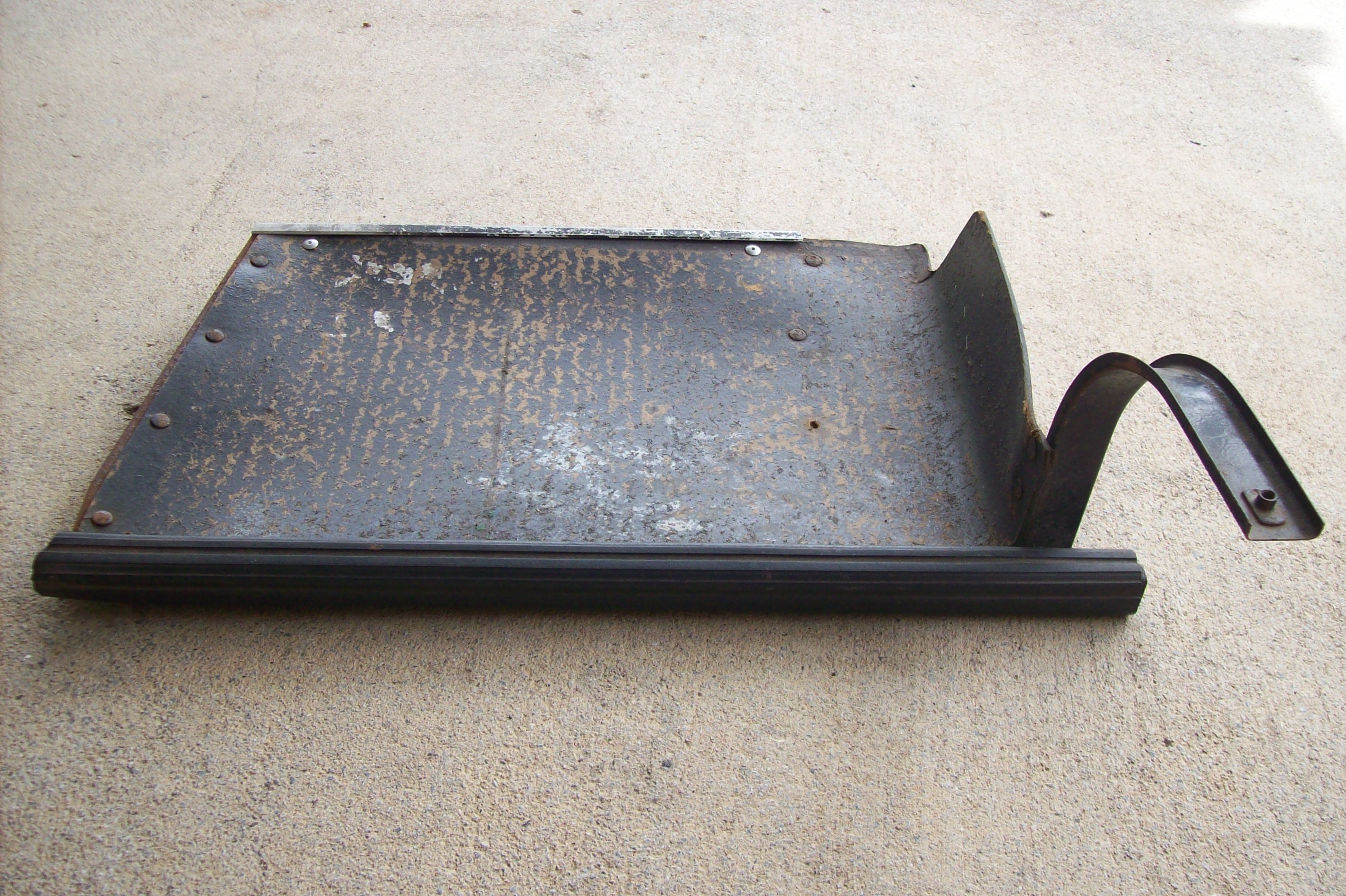

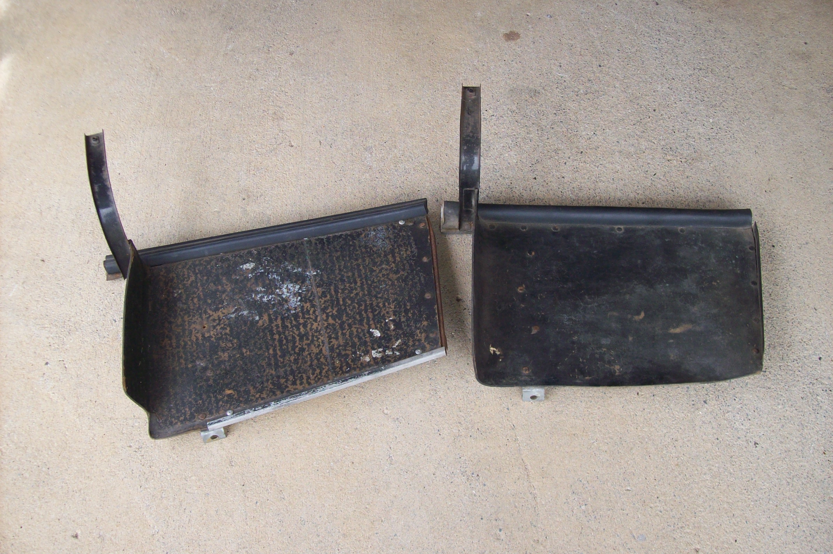

I've attached a few pics of the Parcel trays out of my GT's.
Hoping those who are not aware of what We are discussing will now know.
Even that I had a sample to copy from I reckon would still be easy to make.
File comment: Under das location.
File comment: Single tray.
File comment: Both Trays.

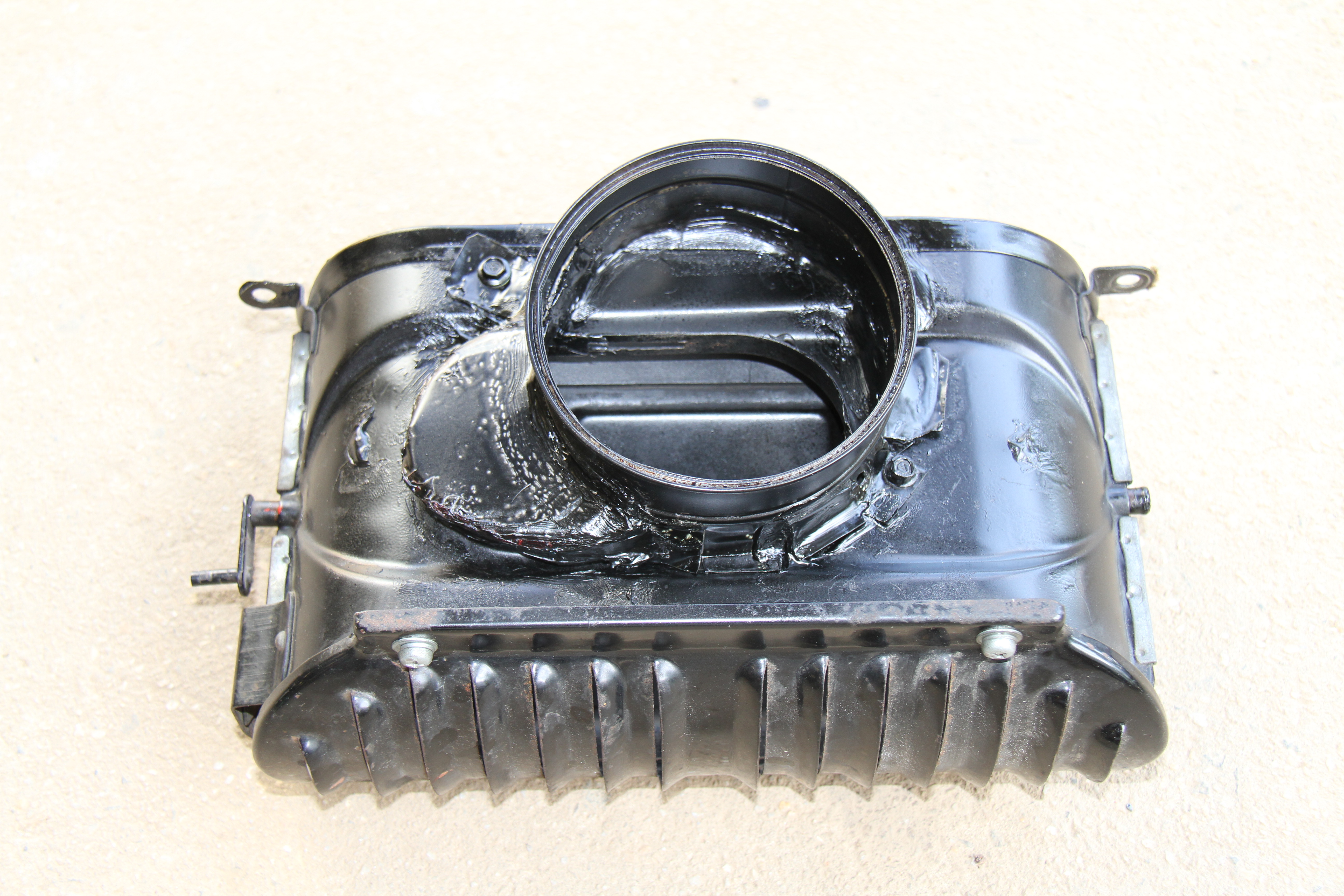

I made mine up by cutting an old biscuit tin (with scissors) , hold in place with a couple of self tappers, and then sealed it with silicon and painted. I then sealed this part to the body with reinforced duct tape after it was bolted in . Works very well. It cannot be see when installed.
