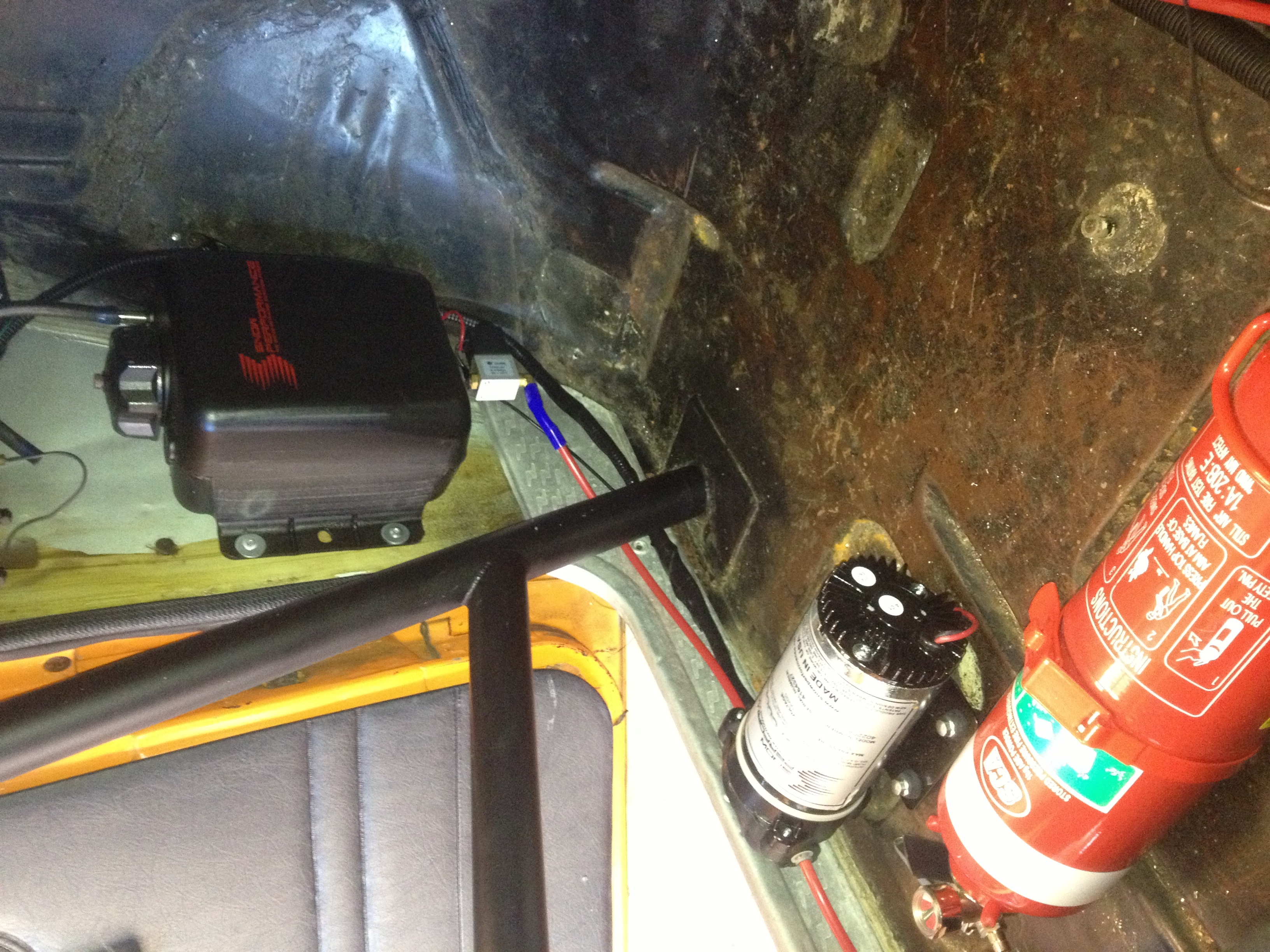

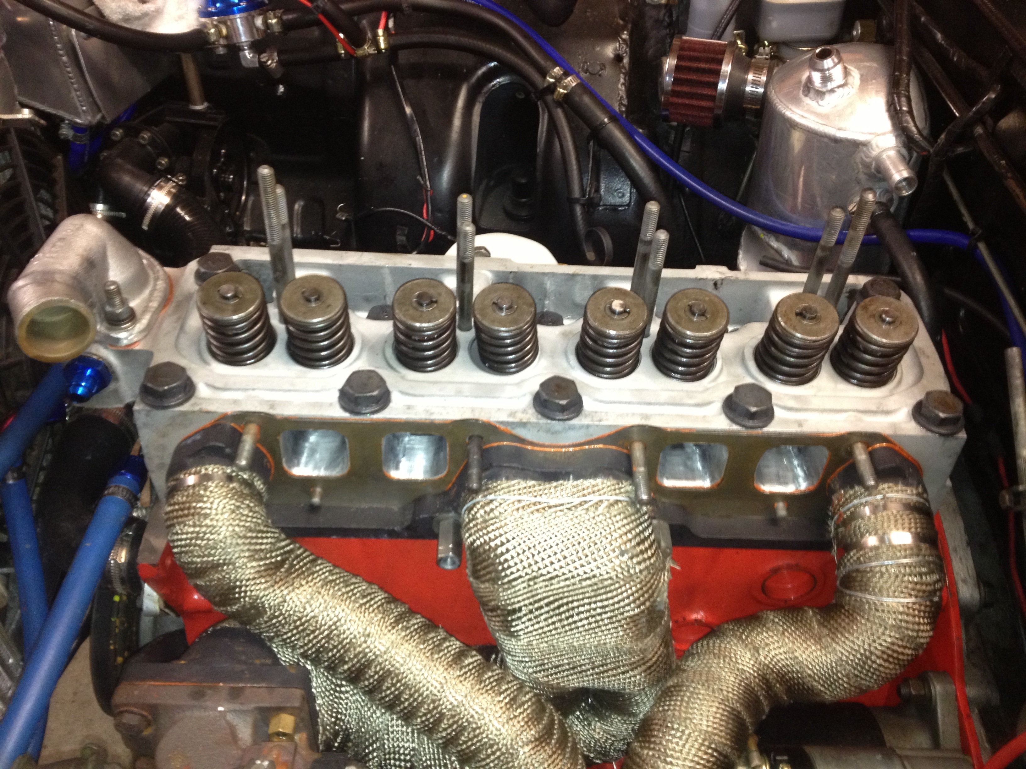

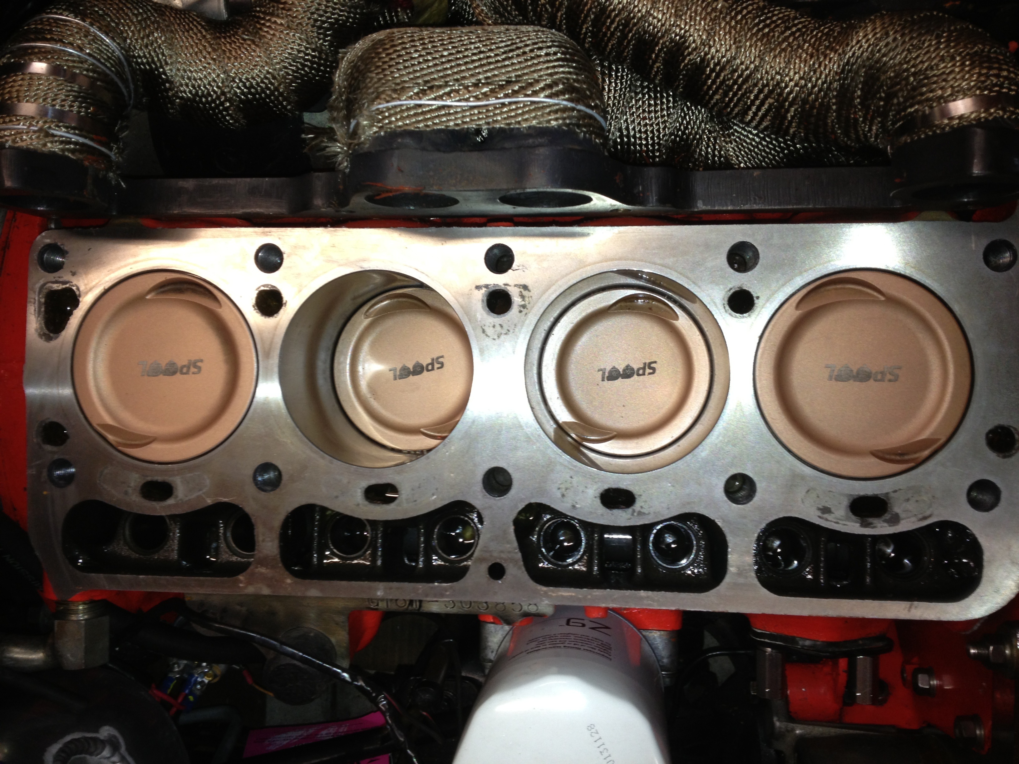

I'm happy to post some pickies so here are a couple
James

and the setup for fuel and battery in the boot is 2nd to none as well.
many many many hours of painstaking work in that car.
a real reflection of the dedication of the owner. very nicely done, James.

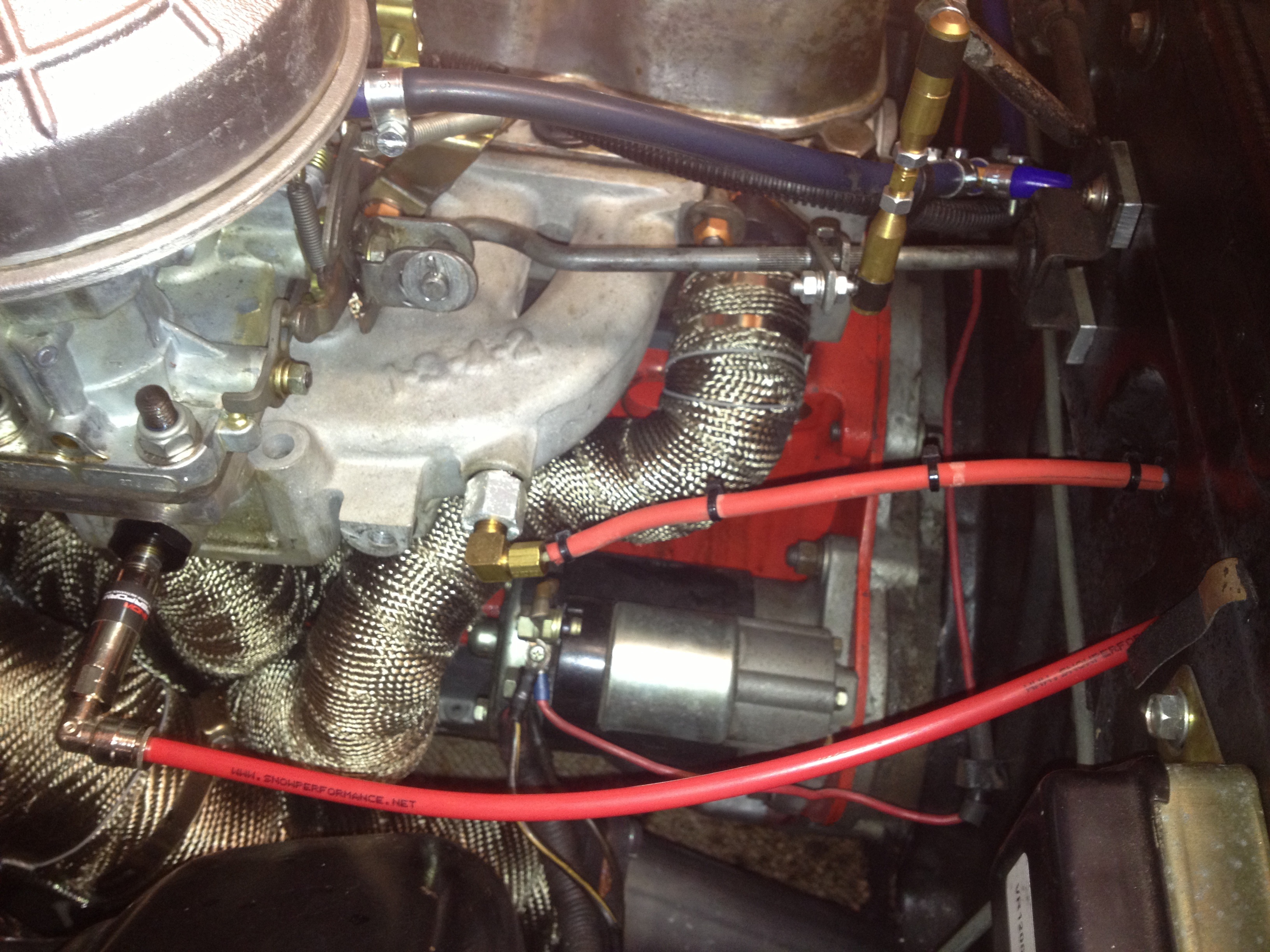

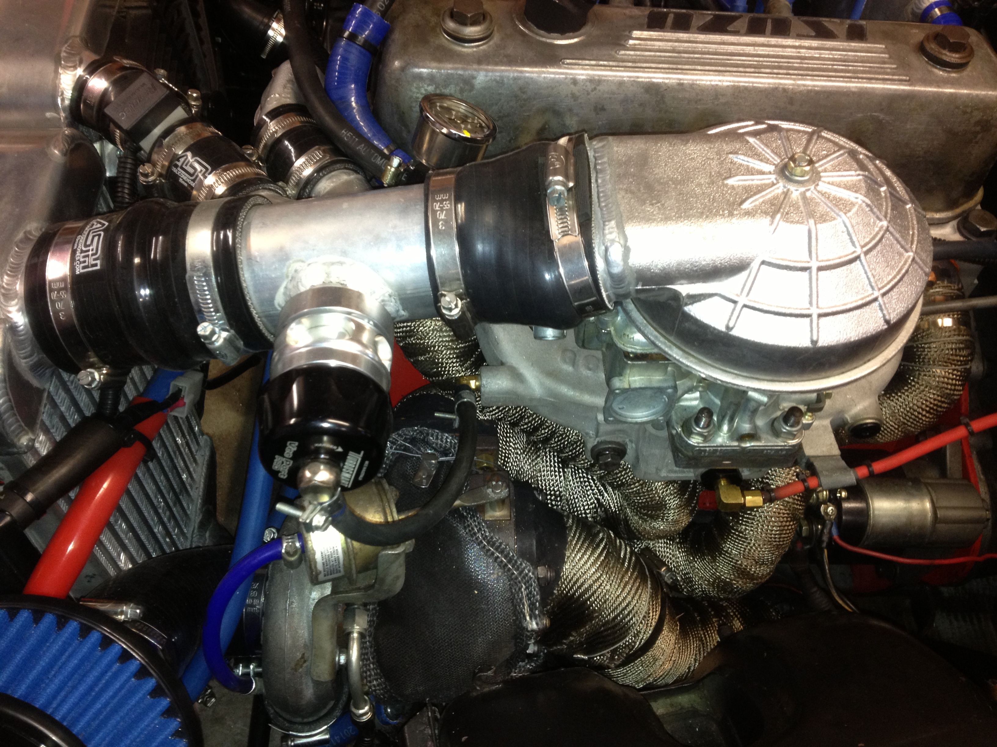

Thought you may be interested
Final 'tweak' (for now anyway)
I bit the bullet (with all the excellent builds posted past and present) plus as a very good insurance measure against detonation
And fitted Water/methanol injector system.
I mounted the injector right under the carby in the inlet manifold for best effect
Pulls like a Malley Bull
J
