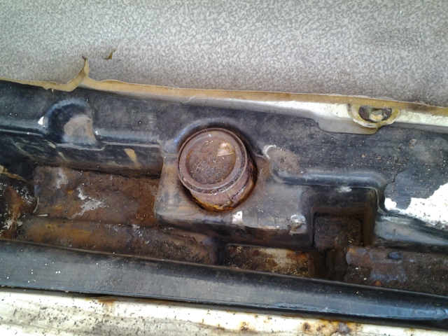

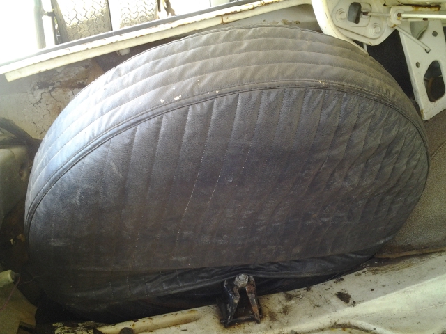

Well, got into the boot. Pretty easy really, remove back seat and vinyl sheet, half crawl through with multi grips and pull out the lock retaining flange. Lock then lifts free, and screwdriver turns latch. 8-)
No jack, or chocks or toolkit :( but...
perfect spare cover, like Aunty Mary doesn't have! *Yoink!!* :D
Original paint touch up tin in place too, but rust flakes just holding together!
No rust holes in boot though! :D
Very fun,

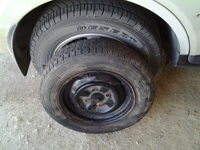

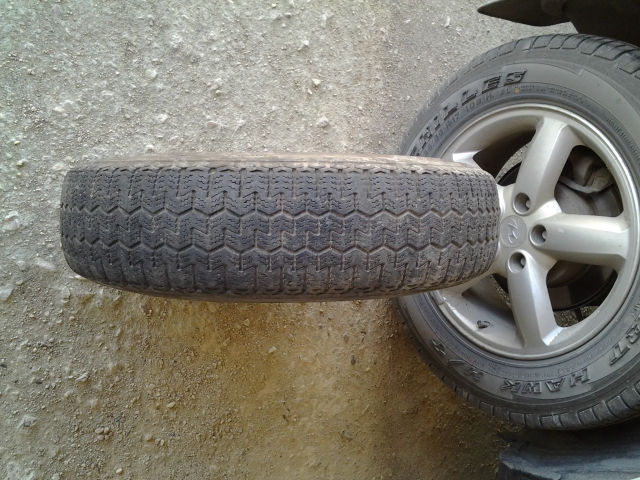

So the spare under that covef looks like this-
155SR14. As it fits the cover, I think this must be the radial equal of the original rubber. Also good for cutting up your pizza....

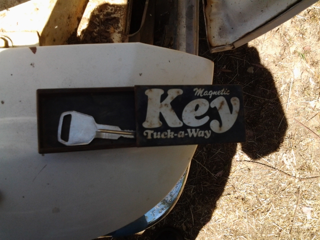

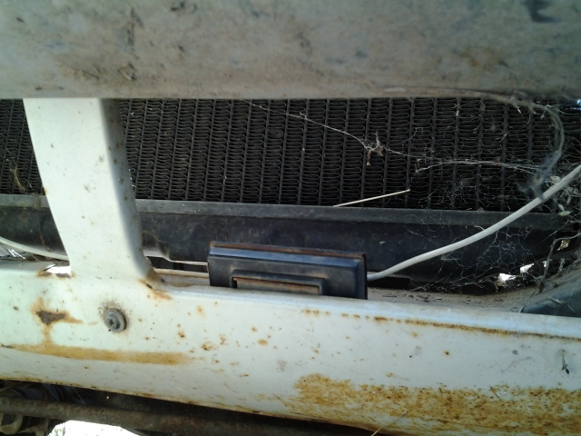

So I decided to fit it and get my jack back from under the parts car, when I dropped a nut under the car. Crawling under to get it I wondered, what can this be?
Well I seen it, but I don't belieeeeeeeeeeve it!
This made me :lol:
Then a short pause and... :lol:
Nice shiney new key fits all locks! Now I can put that boot lock back.
Sometimes you just have a good day........
:D Matt.

nice finds mate, i have been looking for a replacement tyre that fits under the spare cover hard to find! well done finding the key too!

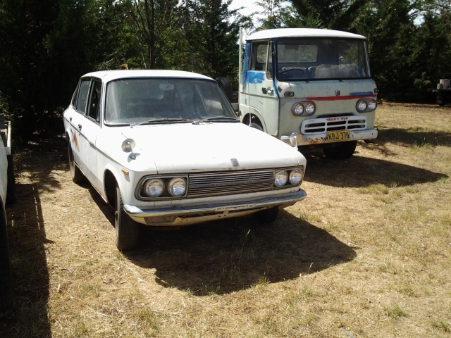

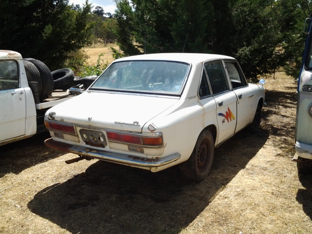

So here we are in the backyard...
And from another angle...
But wait, how did it get round that way??
Well, I tell ya, I didn't push it!
:D :D Matt.

you little ripper!
IT CAN HOVER!!! :o
:lol:

It runs already? :o
Tue Dec 02, 2014 12:15 pm
mrflibbles wrote:
It runs already? :o
Maaaaaate! They always start!
I've been pretty busy, so haven't had much chance, but I just had to try!
First look, it seemed the motor was locked up tight, but it was only the waterpump. Took the fanbelt off and the crank turned easy.
So then the usual WD40 treatment, made sure the tank was clean, (it was!) found a spark, filled the carbie bowl and turned the key. And she fired up! Even the fuel pump brought fuel up! After a soak in 'blaster' and some tapping on the fan the waterpump released. So I filled it with water and went for a little drive! 8-)
But there is a hole in the bottom of that bodgey radiator nearly as big as the one in the top! So I'm in the market for a radiator as I don't have any others.

When I say I went for a drive.......well it was a short drive......clockwise.
The previous owner had a mishap with a roundabout all those years ago, so the left lower wishbone is bent. So it only turns right. But I've got a spare front end, so its all good. Thats why it went in that shed, and it outlasted the shed!
These motors continue to amaze me, 18 years it stood, now it runs, idles, theres no exhaust smoke, no sump fumes, and only a bit of tappet rattle. And I haven't even changed the oil yet!
I have all the bits it needs, apart from the radiator, numberplate light and the dashpad. So I reckon I have to at least give it a tidy up!
