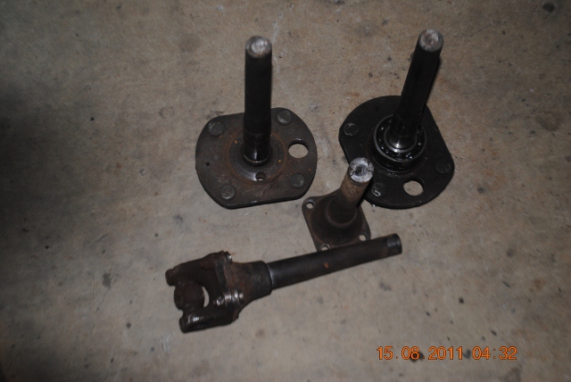

broken rear axle
Has anybody ever seen a Bellett snap an axle? I don't mean a rear uni or the half shaft, the actual axle where it goes thu the rear trailing arm. :oops: and if so how whot caused it? and whot would cause it do do both at same time? :oops:

No airborn action :cry: i left the 1st one when i hit second gear from the start grid and the second one about 200 meters from the 1st. The 1st one smashed the uni and axle the second one the uni still in one piece attached to half a half shaft lying lonley in the middle of the track. Got a cheer from the crowd when it was handed back on my way down the hill and it was explained to me from the guy that won our class i had a better trophy than his :lol:.
The big problem is it is we can't work out why it happened :?: I have a better quality uni's on the way when they are fitted we will do some testing. i destroyed 2 uni's the day before :shock: The 1st few trips out i had no problems i dont do burn outs and the track was wet. The only thing is the uni's that were first fitted were chinese i ordered toyo brand but alcheapo's turned up so i fitted them due to lack of time to get other ones. I am hoping that the axels were stressed when the uni's went.

I took beethoven to grafton on the weekend to try and see if i could bust some axles :D and failed. The car only came off the hoist day's before and after lots of theory's trying to be proven the only thing :D we could come up with was dodgy uni's the thing is we tried v8 holden that were too big and in desperation last time i went to our local parts shop with a sample and recieved a chinese brand. I think when they snapped in half they stressed the axles with the diff locked and tried to push them in a oval motion :?: With some local testing and some unknown markings on the road out the front after fitting some hardy spicer solid uni's it's fine.
After 4 runs at Grafton it was best to bring it home while all was good :? as repaires before leyburn would clash with other plans.
