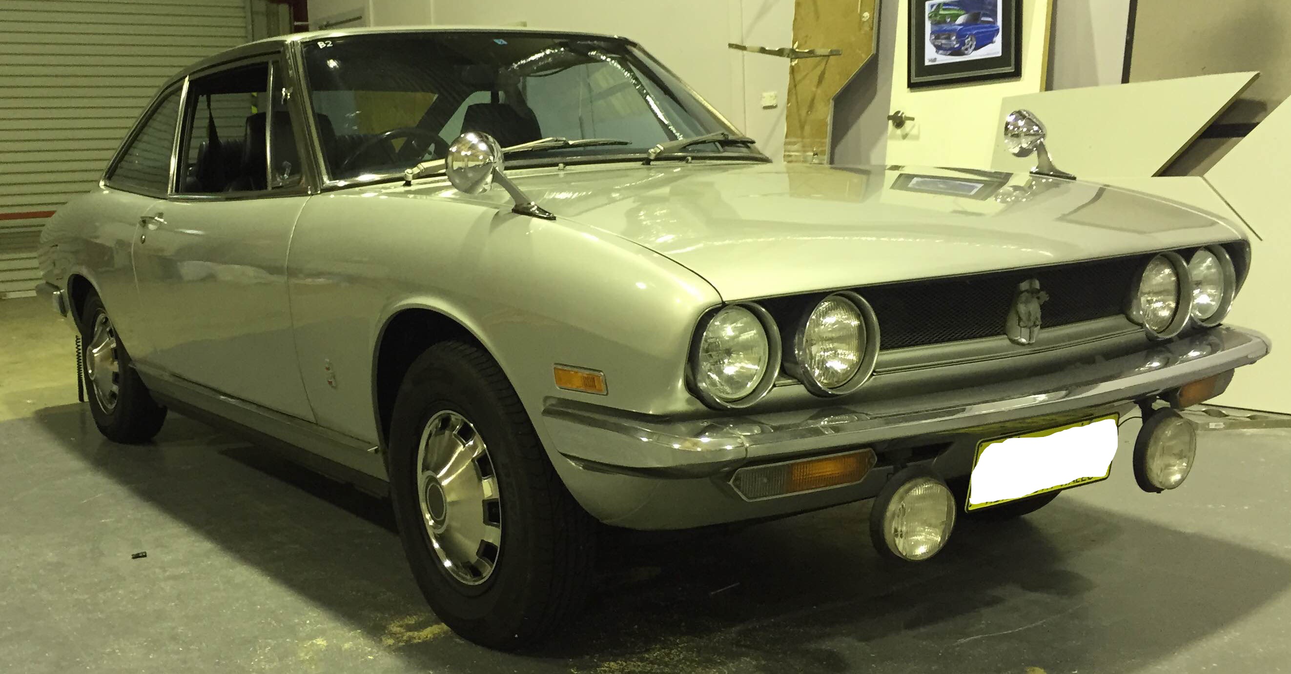

I am trying to figure out what size wheels I can fit under the wheel arches of a 1974 Isuzu 117 Coupe PA95 XT (Yes I will keep stock + hub caps in warehouse for certain events). The car came with the original factory hub caps and I measured the current steel rims and they measured +35 offset.
Wheels: Watanabe Type R
Now the rears I wanted to fit the widest 15x8/8.5/9 with +0 Offset if I can as the rear guards are naturally pumped out already. The fronts well thats the headache I think, as with the +35 offset of the stock steelies the wheel literally sits on flush with the guard (attached image to see the difference between the front and rear) and I doubt I can fit 15x7 +20 offset unless the hub & double wishbone can be changed :S
Any info is greatly appreciated as I don't want to order the wrong wheels.

A 15x7 wheel with +20 offset should fit no worries as the more positive offset you have, the deeper inside the arch the wheel sits. I you go a +0 offset or a negative offset the wheel will have more dish and sit further out toward the arch.

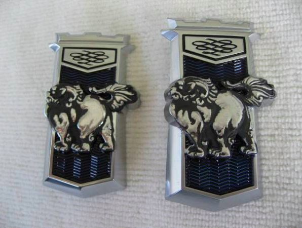

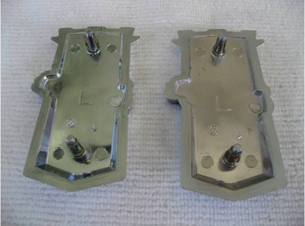

Couldn't resist new badges are my weak spot.
