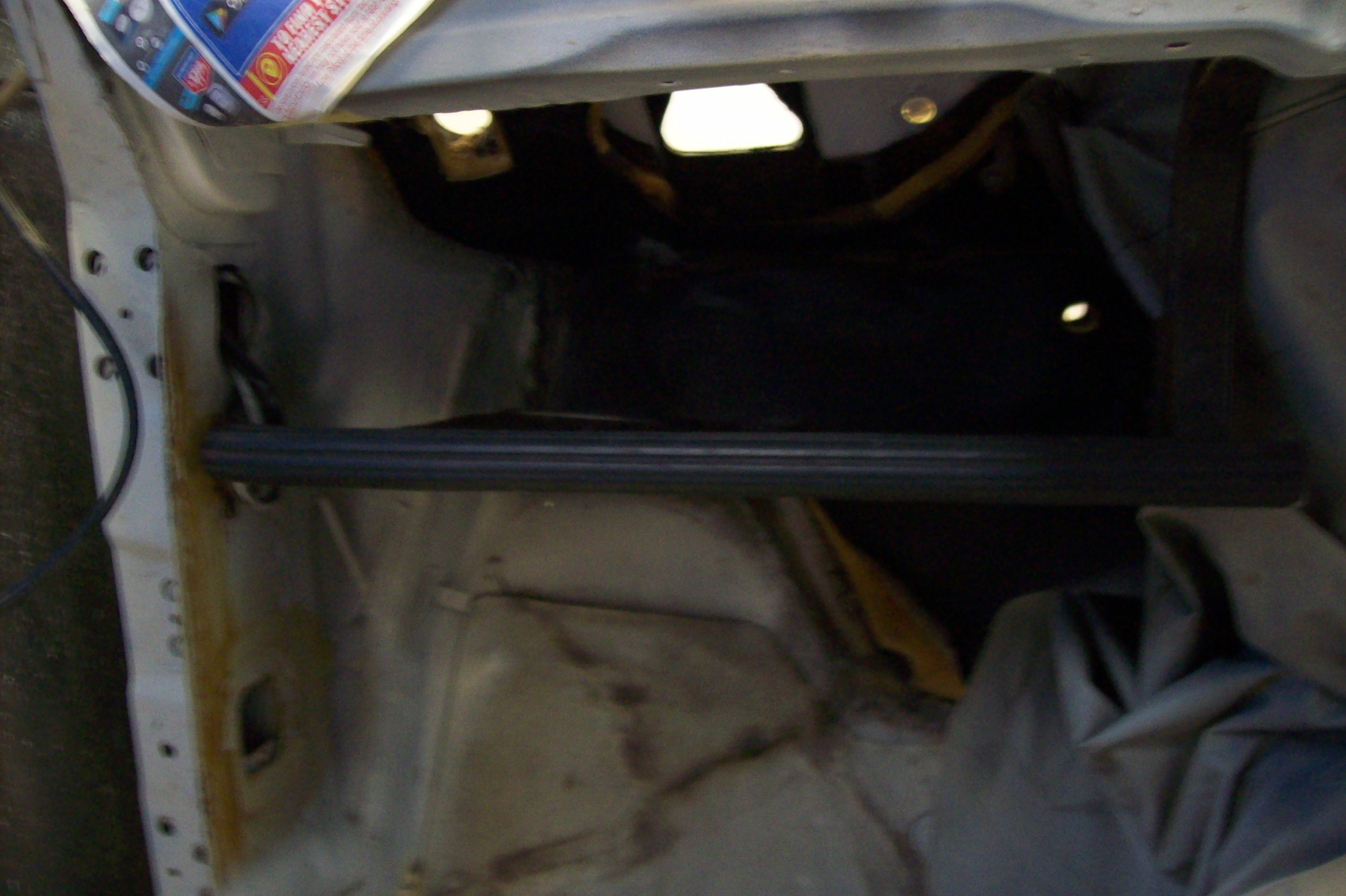

Author:  Glenn [ Wed Mar 17, 2021 1:07 am ]
Post subject:  Re: Parcel Trays under the Glovebox
My 72 sport has one. Obviously not Aust delivered though but i thought at least all GT's had them standard.
Mounts: as far as i recall all Belletts have a tapped hole on the A pillar....... one bracket goes in there (pics)
On the right, a curved bracket runs up under the lower dash area.
At the back there are L shaped brackets underneath that screw into the firewall. Possibly those holes are in all cars too, not sure.
