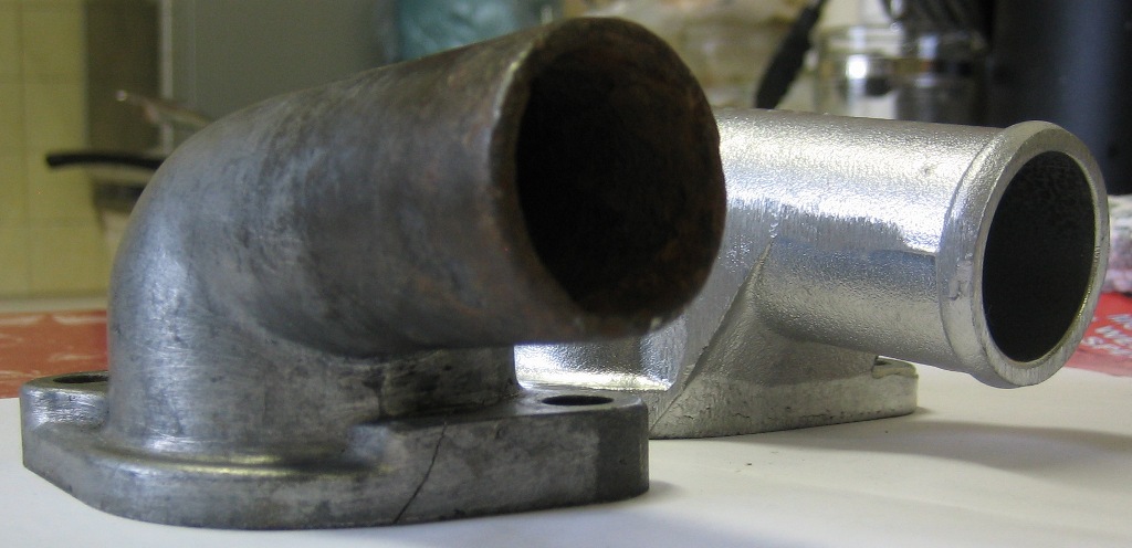

OK, here's the follow up for the thermostat housing. As you can see from the first photo they are not a 100% match but the bolt pattern is identical and the angle of the outlet is right.
thermo housing1.JPG (172.65 KiB) Viewed 18606 times
The next pic shows that the oulet's angle is again slightly wrong but in this case beggars really can't be choosers!

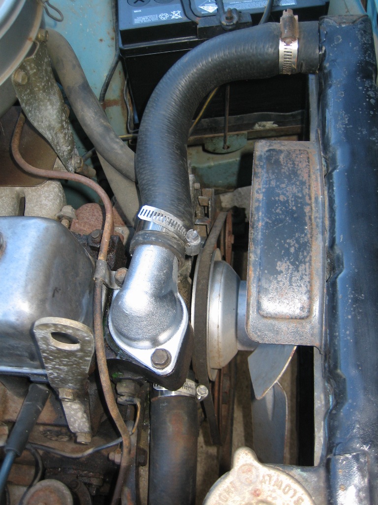

And lastly, the finished product. I had to use two gaskets when I put this back together but this was mainly because I was worried about breaking a second one plus the block wasn't particularly flat!
As you can see the outlet pipe is noticeably bending the top pipe but I don't think this will effect anything

Looks like it'll do the job. You could probably cut about 2cm off the radiator end of the pipe and get it fitting straighter, though.

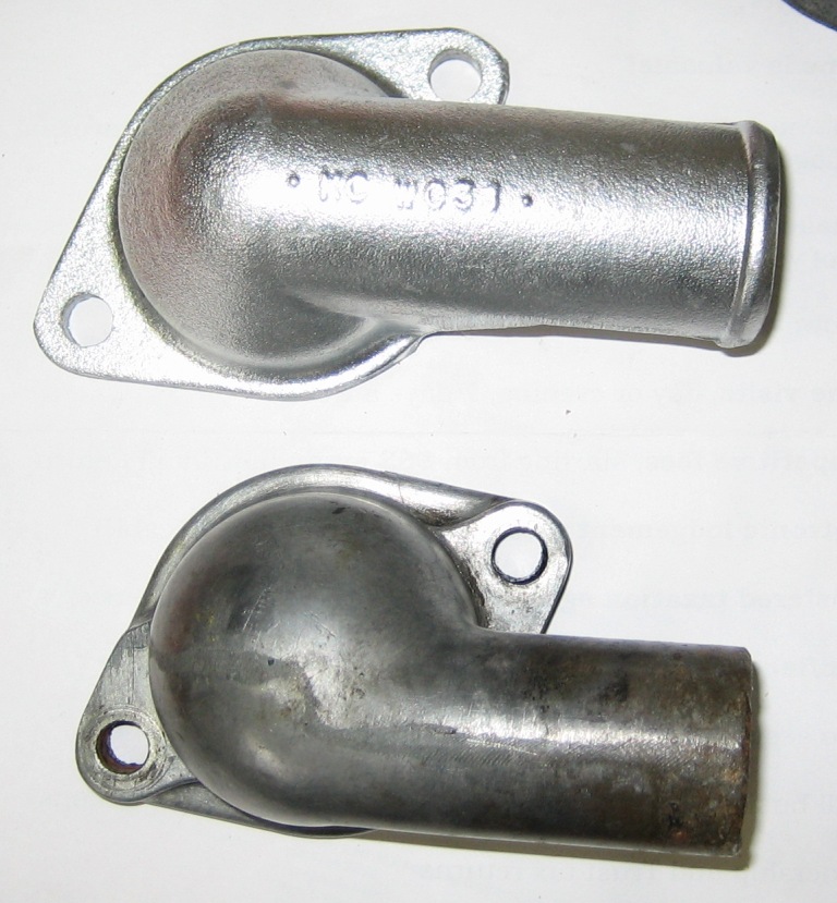

Reference to thermostat housings - Not too many years back, I was able to buy the Genuine part from ADELAIDE TRUCK SPARES. Evidently the same part is used on a small Isuzu truck - model unknown.
The label reads
ISUZU GENUINE PART ;
ISUZU Pt No. 9-13713064-1;
P No. 94021888;
Des PIPE;WATER
Fig key No. 031-049
However, putting all that aside, I am currently running a WO33 from Killkenny Castings which is to suit an RT18 four cylinder engine from a Toyota 1977 RA28 Celica. A housing from an RT18 engine in a Corona does suit but pipe exit is at slightly different angles I believe.
