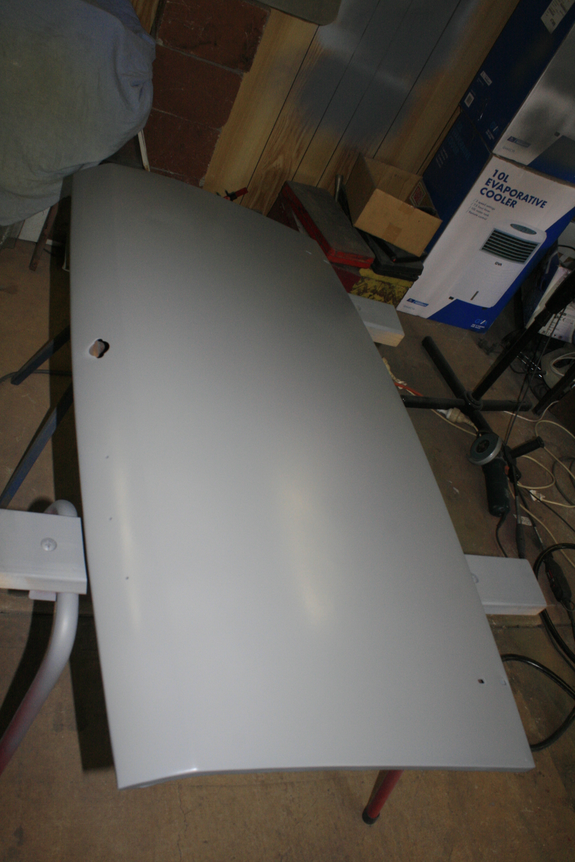

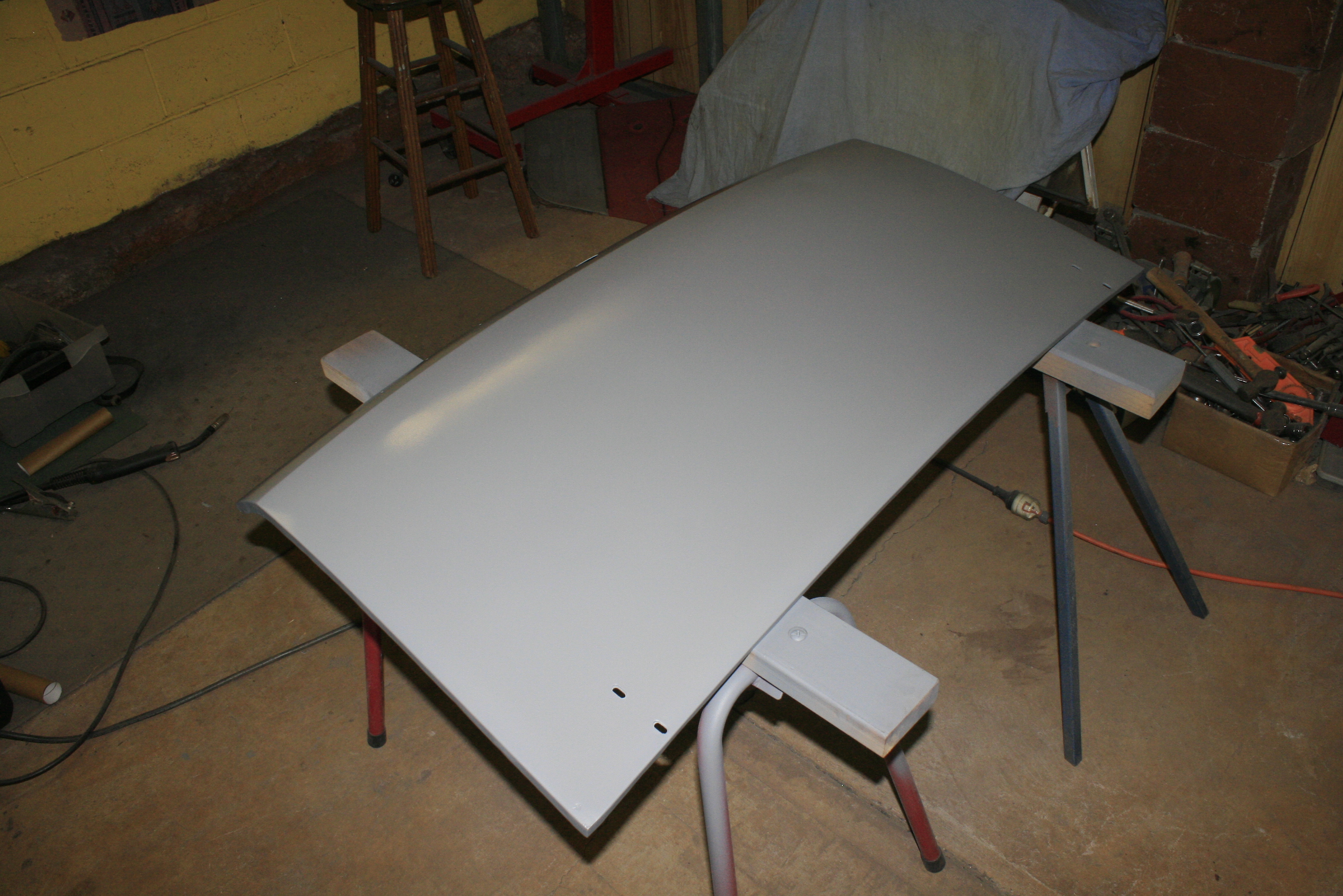

.Just Finished The Etch-Primer.

Post by Teditor »
..It Has Been Quite Interesting Trying To Figure Out Just The Application Side Of Things As I Have Been Advised By Many People & Each One Had Their Own Different Way Of Doing Things & There Was A Lot Of Clashing Methods So I Am Still Taking On Board What People Have Said & Advised I Then Try to Make It All Work In My Own Way & Only Time Will Tell..

etch primer is not supposed to cover the metal totally, its just a dust coat that then allows the primer to 'stick' so only a very light mist coat is required. You should be able to see through it. It's usually a yellow colour and is thinnned about 50% with thinners if i recall.
What sort of primer are you using? 2 Pak or Acrylic?[/quote]
We are using Acrylic, as Michael stated, we have had a lot of variable advise, so we are amalgamating suggestions and winging it, who knows we may invent new methods and become famous.
Ted
Ted Freeman
Contact:
Re: Screamin' Squirrel II
Post by Glenn »
Teditor wrote:etch primer is not supposed to cover the metal totally, its just a dust coat that then allows the primer to 'stick' so only a very light mist coat is required. You should be able to see through it. It's usually a yellow colour and is thinnned about 50% with thinners if i recall.
Ted[/quote]
OK Acrylic is fine and safer also! If you look up (Google) etch primer you will find that a dust coat is all that's needed. It contains phosphoric acid in a small amount which 'etches' the bare metal to enable better paint adhesion.
Be aware also that acrylic undercoat is hydroscopic. ie it absorbs water. Don't leave it too long before final paint.
There is a lot of good info on painting cars from the major paint makers.

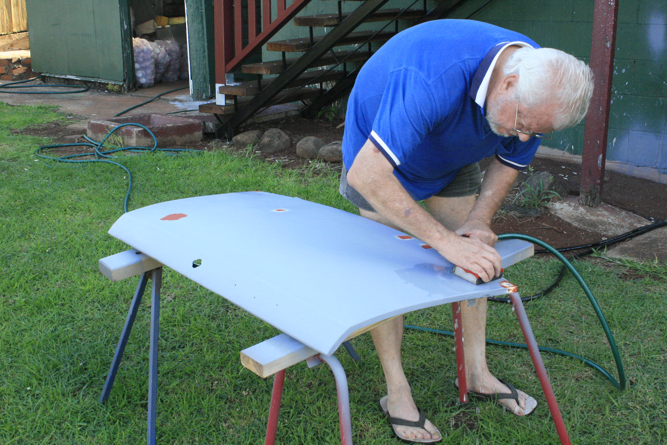

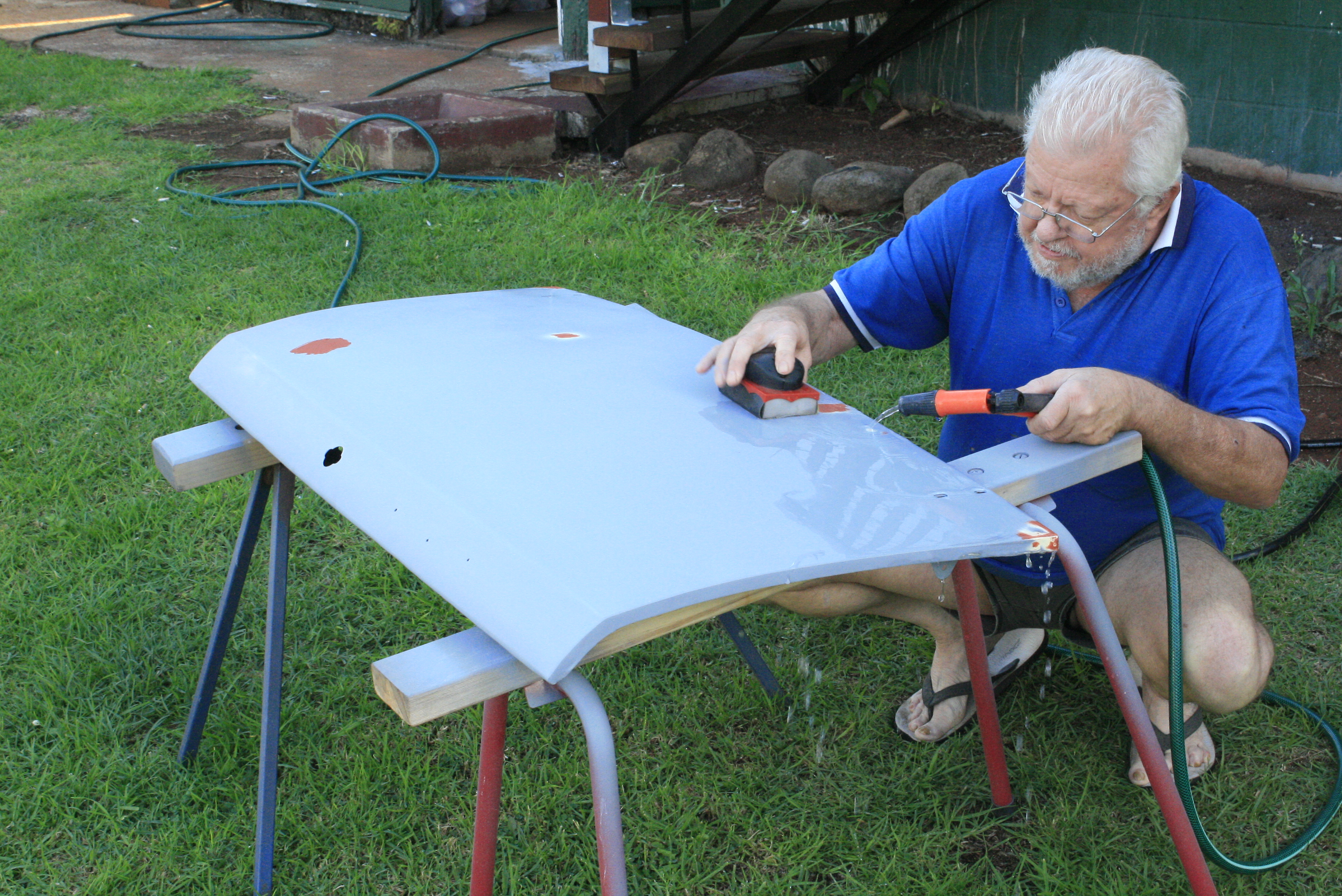

Dad'Z Into The High N' Low Spot Workin'

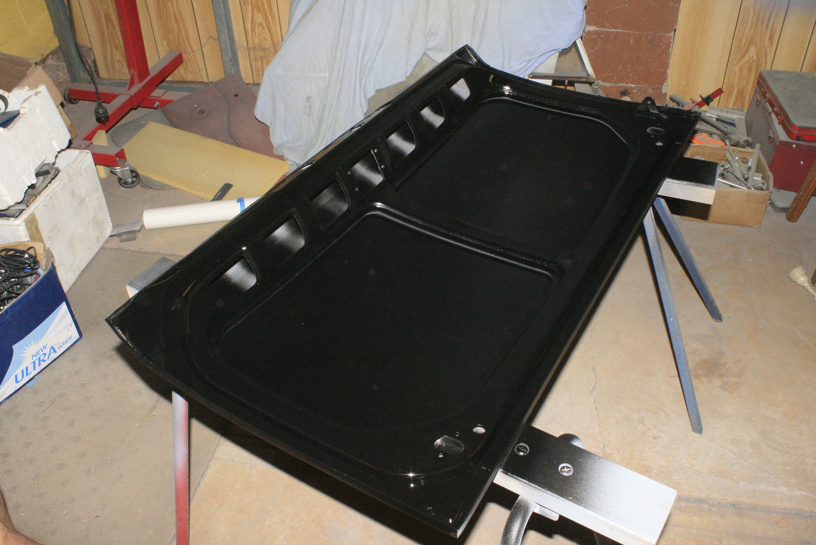

We Decided To Do Black On All The Inner Parts eg: Door Jams Under-Sides Ect....

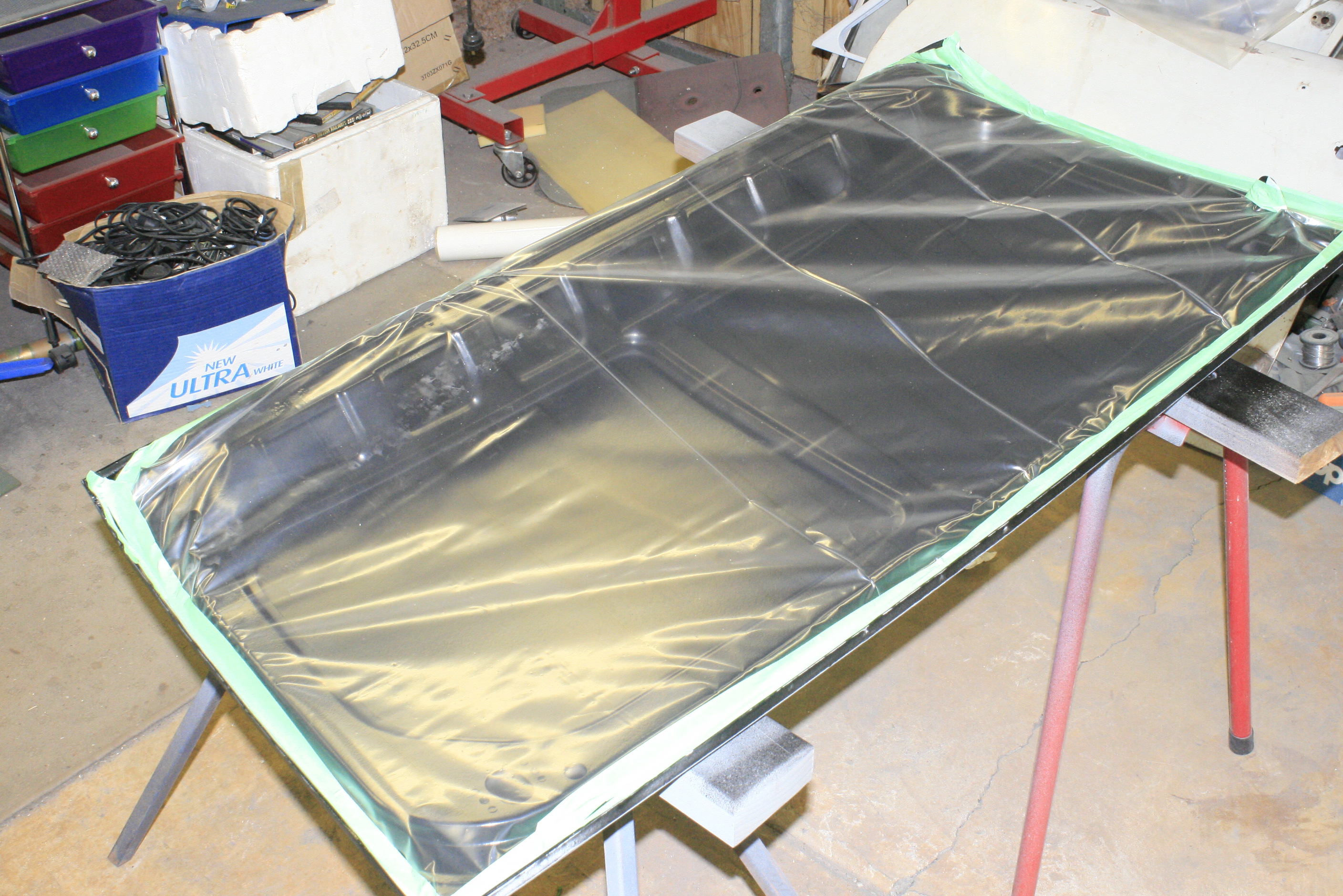

Post by Teditor »
Back At It Again... Masking Off The Inner-Boot With Plastic Sheeting Which We Purchased A Roll Of So To Prep The Other Side For Color Paint...

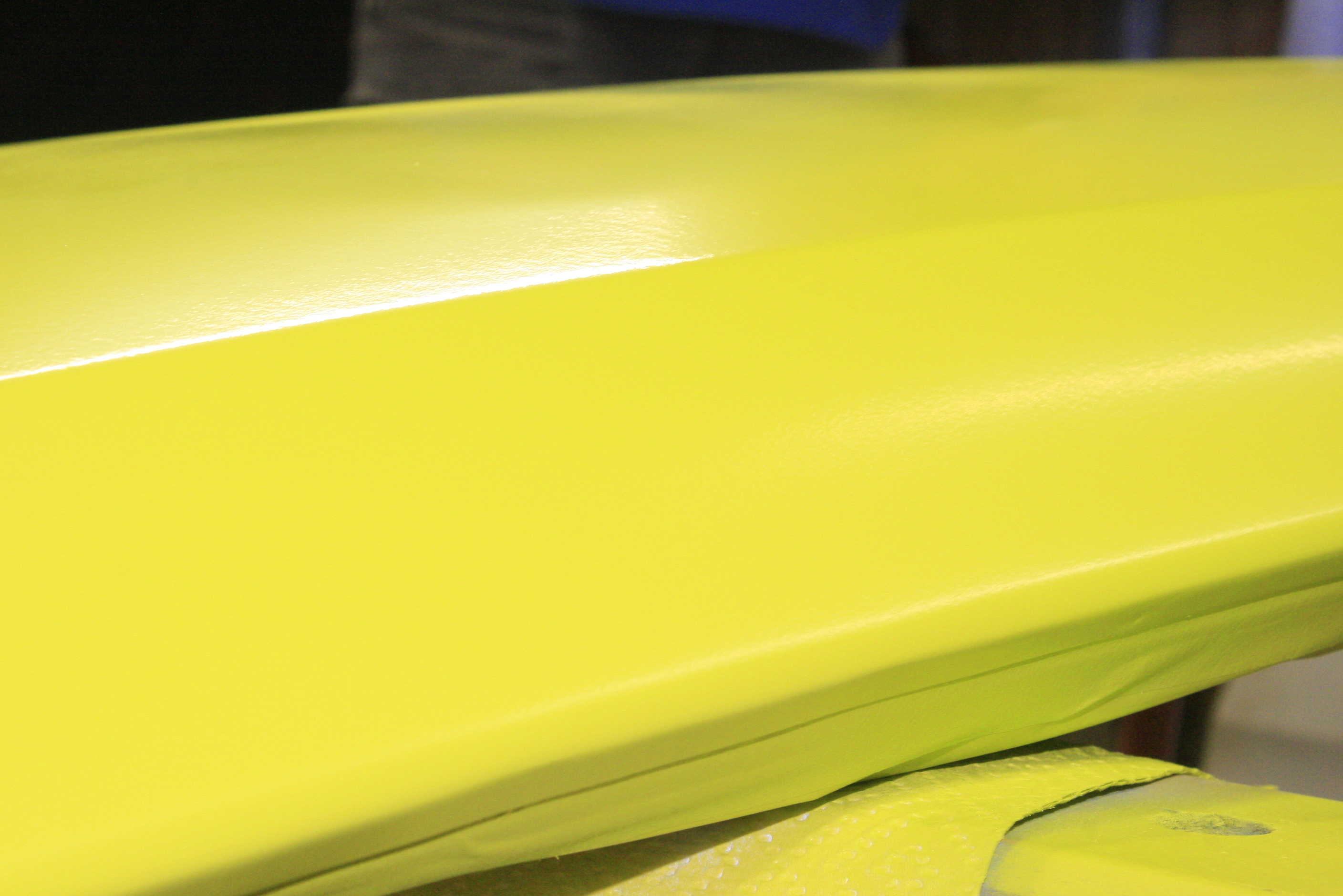

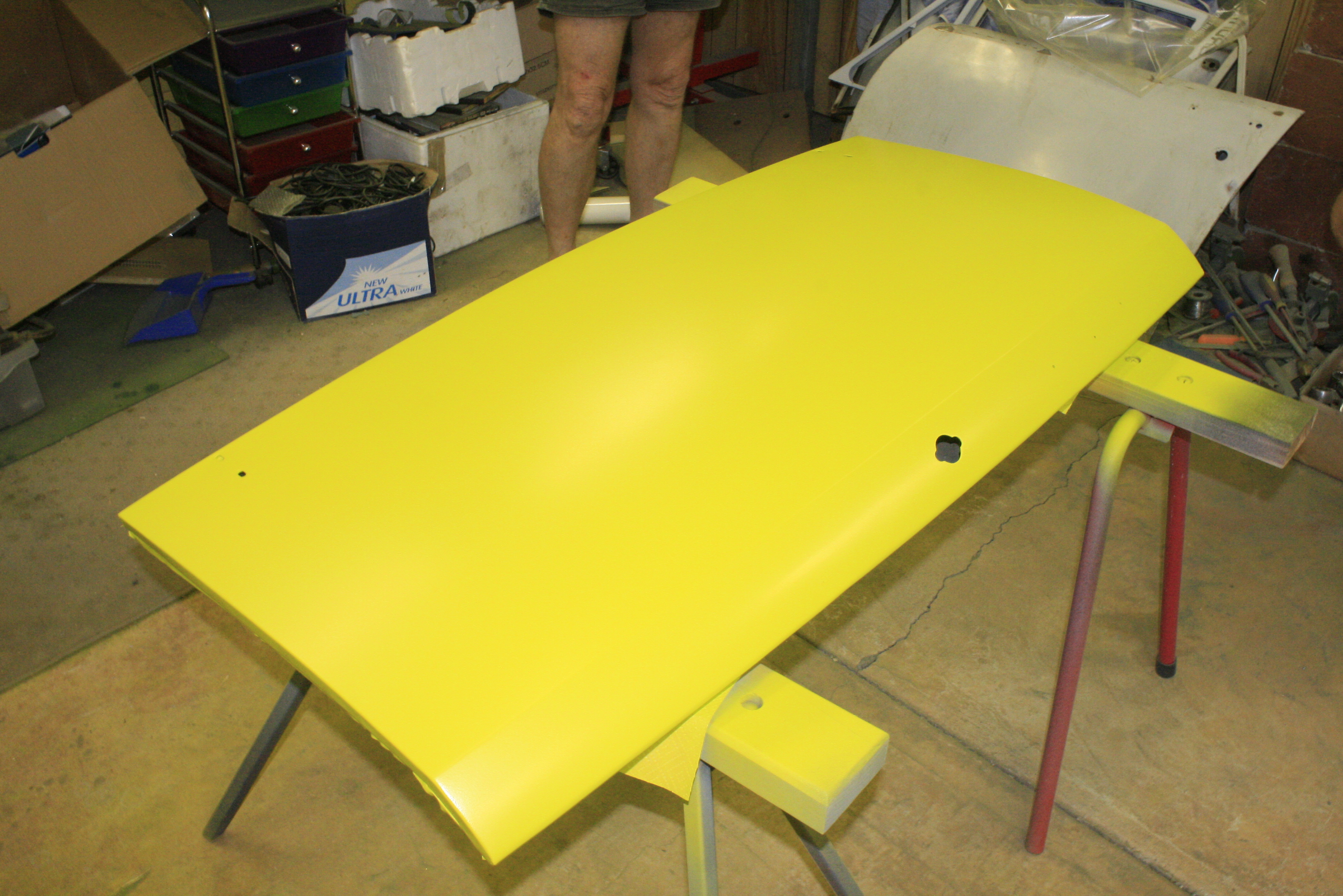

Post by Teditor »
After The 1st Coat Of Pine N' Lime & First Time Ever Using The Top Coat Gun, I Had Issues Setting Up The Gun & Was Not Quite Able To Achieve The 50/50 Over Lap But We Managed OK As The Results Show & The 2nd Coat & Gun Set-Up Was Easier To Achieve As Practice Don't Make Me Perfect But It Will Get Me There....

Post by Teditor »

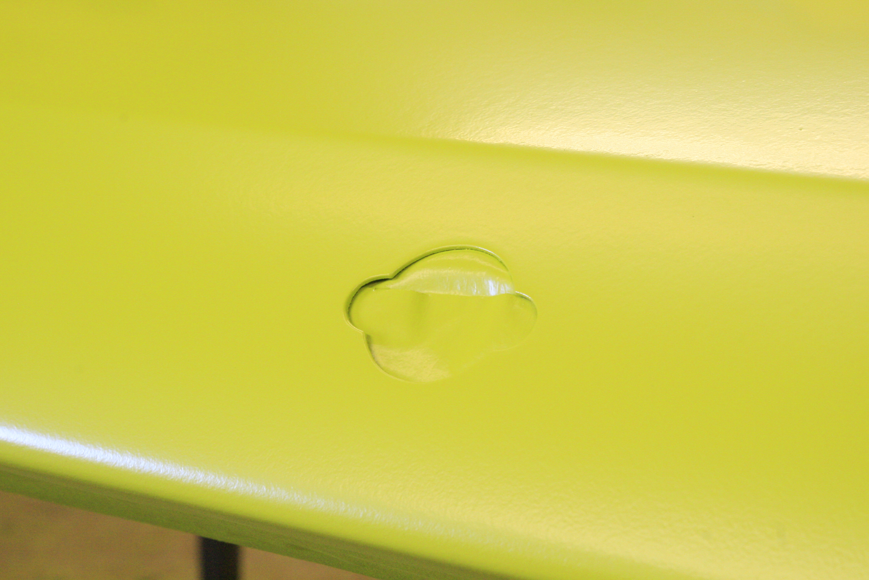

The 1st Coat Was Rather Thick As Father & I Were Unsure Of The Thinners To Paint Ratio We Now Have The Knowledge..... Thick Thin Still Looks Good To Us......

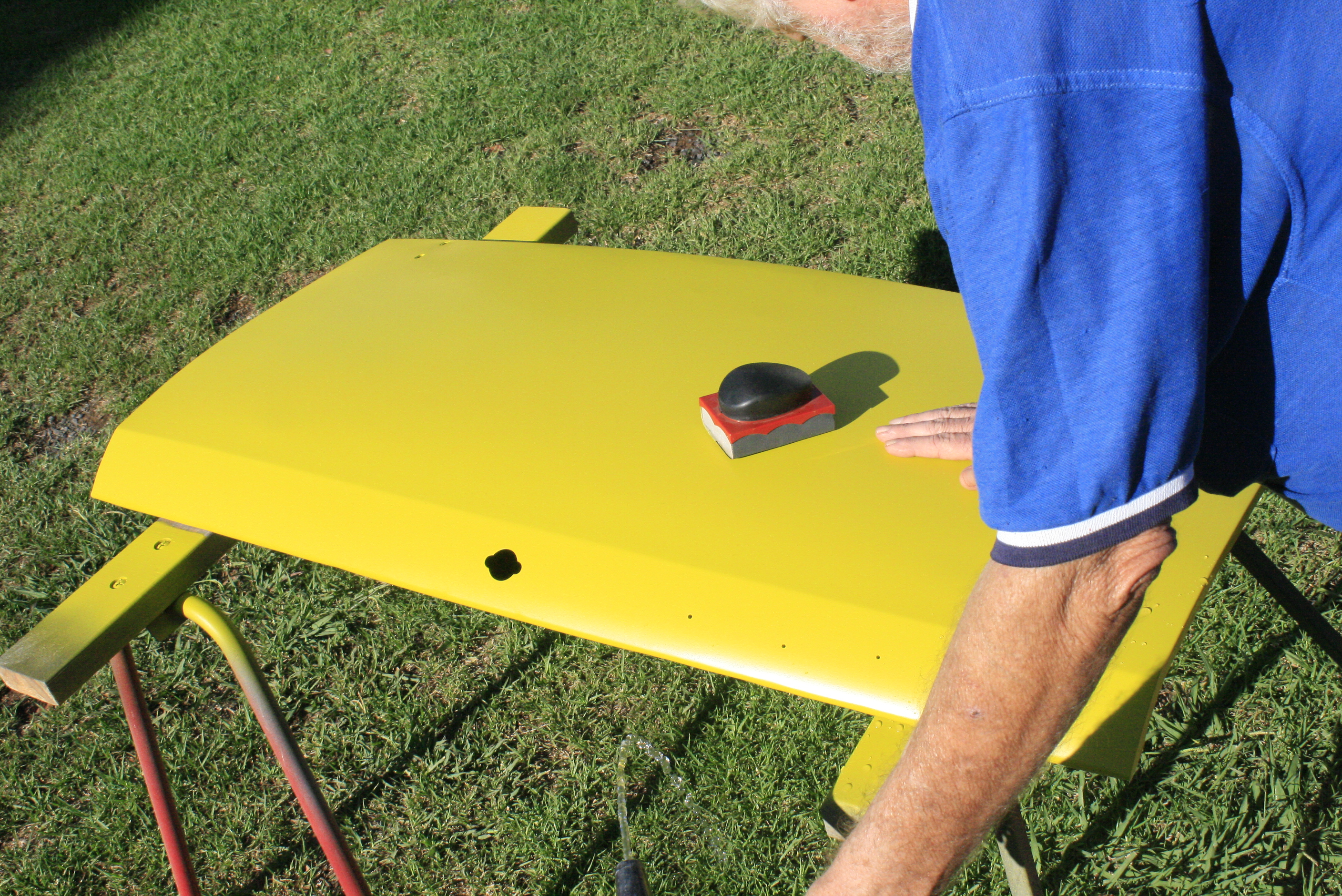

Post by Teditor »

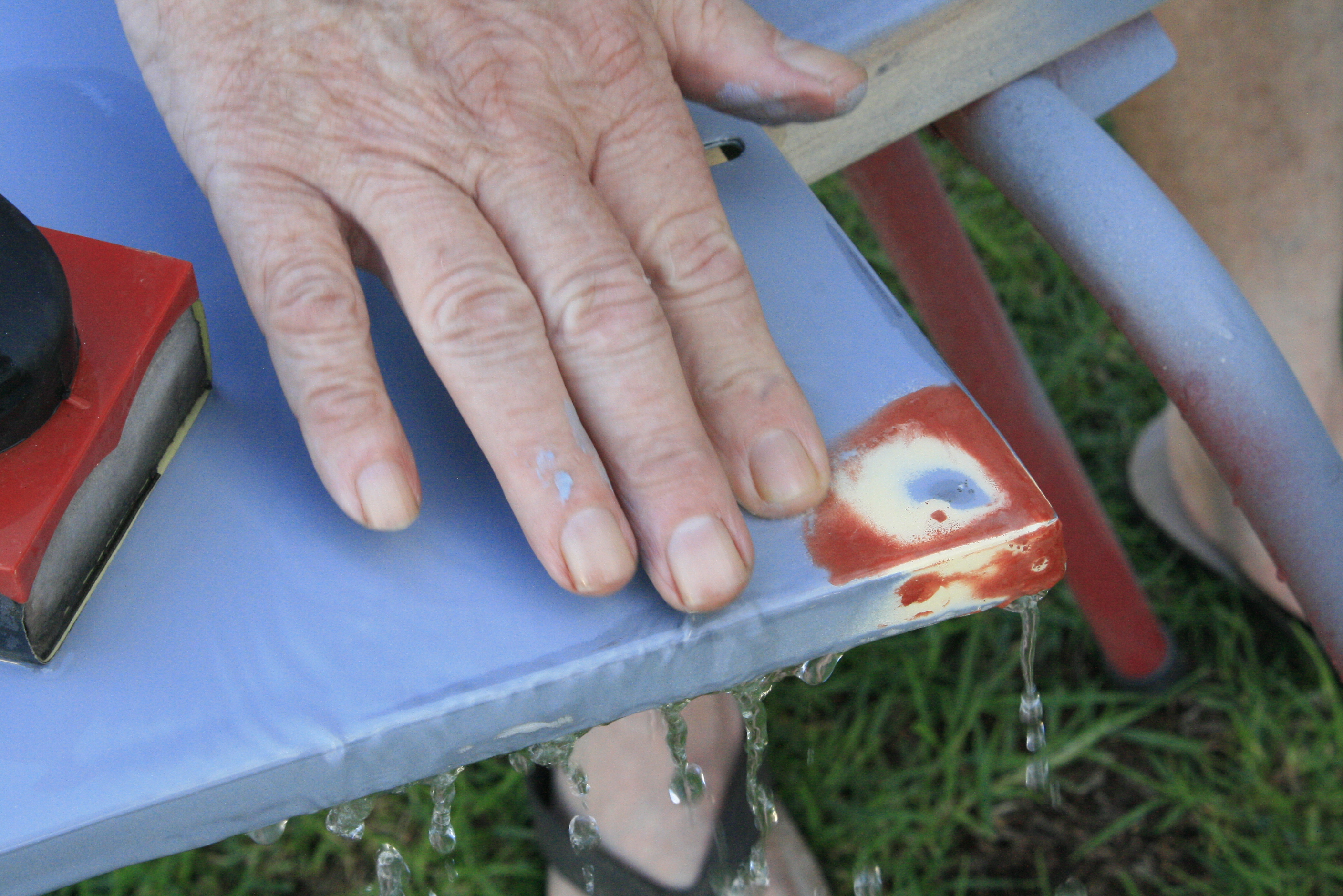

Dad Has Been Doing All The Wet N' Dry Sanding & Fiddly Bits & I Look After The Stripping, Welding & Painting Ect.... 1200 W/D Between Coats Of Yellow & We Have Made The Choice To Do 3 Coats Of Yellow Then The Clear To Bring In The Depth & Contrast Of The Color, Well That's The Plan Anyway......

Post by Teditor »
After The 2nd Coat, It Has A Really Nice Finish So We May Refine The 3 coats down to 2? Not Sure Yet As It Depends & Is Subjected To On How Much I Screw Up While Trying To Achieve Bliss, But Once The Clear Is On Well Lets Hope For The Best......

Teditor wrote:The 1st Coat Was Rather Thick As Father & I Were Unsure Of The Thinners To Paint Ratio We Now Have The Knowledge..... Thick Thin Still Looks Good To Us......
I'm not a painter but typically you add 1.5 thinners to 1 paint..... when you stir the paint and pull out the stirring stick, the paint should run freely, almost like water. Use good quality thinners also. A water separater at the gun is a good idea also.
WE have some painters here I think, so they can correct me if wrong.
rod
Post by rod »
yes that's rite ...looks like acrylic paint ...use premium thinners ..gets better shine ....yes you can colour sand acrylic to get rid of orange peel ...use water trap on compresser ....
