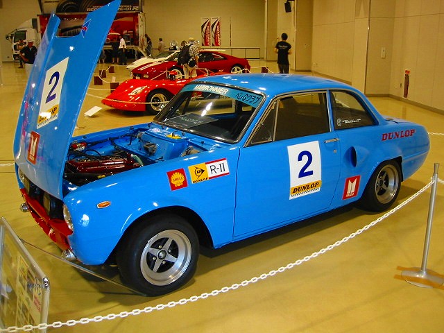

This is another picture of "a" GTX from the Holland club website.
The red car in the background appears to be Katsuyuki's R6 Spider, so this is probably a picture of Mr. Oba's Number 2 car tribute prior to the Old-Timer article.
Tue Dec 23, 2008 9:36 pm
Interesting that the later-style Isuzu emblem appears on the car, unless this was a later addition...
You're right. The Bellett G Club text on the end of the sun visor strip appears to be an addition also.
The two small black and white and one blurred color period pictures I have found have the number sticker a little farther forward on the door, and with a dark stripe or border at the edge, the Shell sticker is below the other two fender stickers and may not have a box around it, there are no stickers on the rear fender/quarter panel at all, and no manufacturer name at all anywhere.
Back to the front fender, the b/w pictures show the class (?) sticker reads "R-I", not "R-II", and the blurred color picture can't be read, but the text is white and the background red on the class sticker.
Oddly, no ISCC stickers anywhere.
