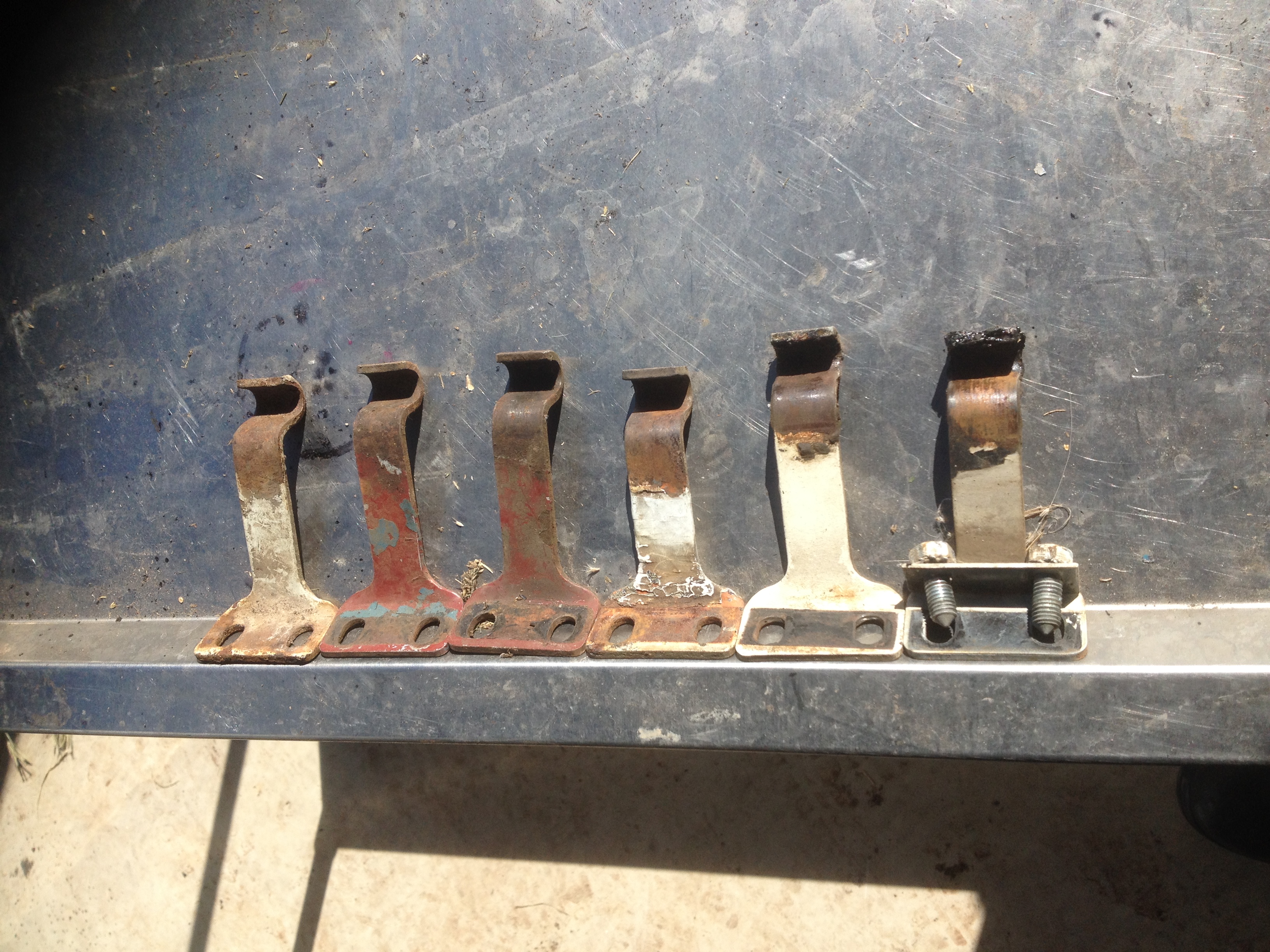

RH door check strap (metal) Since my GT has the longer GT doors and i think the strap is different, need a GT one or advice if they are same. Mine is busted. Its the bracket with two mounting holes that fasten to the A pillar and the other end hooks around a pin in the door, to stop it opening too far.

The parts books also list the 4 door and 2 door sedan and GT are the same for the check link or strap. Unless there was a change after '67 as these are the dates of publication of the books. I'm not aware of any member of the forum or Bellett owners who possess a later publication. It would be good to know, as I would like to photocopy the pages for my collection.

I was looking for some straps for Blackie when;
Thought I'd confuse the issue a little more
The two straps nearest the end with the bolts are definitely off the sport. Yes one is short the other is long. Not sure which side each came off. Anyway the other four are from spares lurking around the shed from Peter A.
Could be how much you want the door to open?? :?:

Hi Dean
the length varies according to the door i believe GT or sedan. Just wh\y i am unsure. Maybe the pin location on a GT door is different....
can u spare one of the longer ones ?
these sometimes break (as mine is) over time. The hook end just snaps off. Could be why they vary, as replaced with a sedan type.

but why would there be two different lengths on the one sport? Weird.
