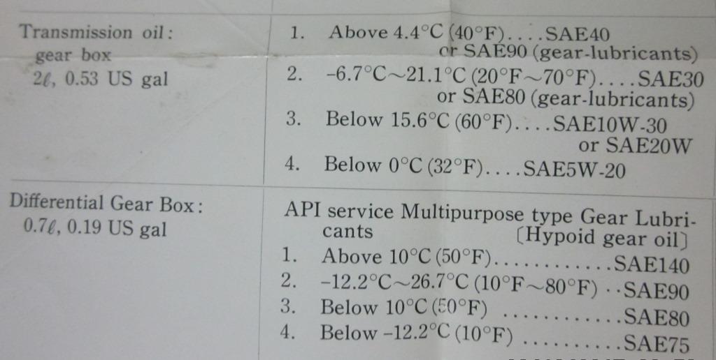

I was about to make the mistake. What oil goes there then?

Basically it's engine oil: see pic also from the manual. Most here use SAE30 I think.

Use straight SAE30 oil in the gearbox. Don't use multigrade engine oil and definitely do not use gear oil.
4 stroke lawn motor engine oil is SAE30. Silly as it sounds, it's perfect for a Bellett gearbox.

Its interesting that Isuzu don't specify what to use over 21.1C. Surely it gets hotter than that in Japan !!!
