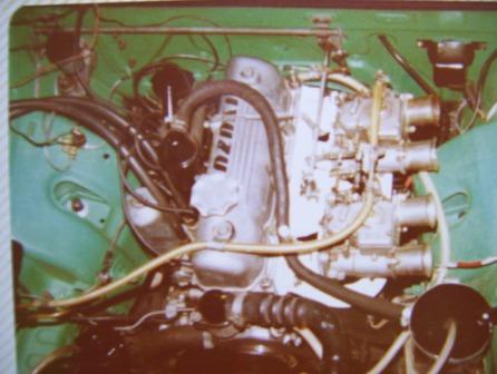

Okay, to start with I probably know that there's not going to be many out there !
Just putting this up if anyone hears of one that may or may not be for sale.
WANTED : Dual Sidedraft Weber manifold for 1500 motor (G150), with or without carburetors.
PS : a downdraft manifold for dual webers would be okay too : )

the only twin side draft manifold ive ever seen in the flesh was on a race car down here. they were made by "lynx" , and were a rare thing when they were new in the 70's, so the chances today.... i know of a car down here that has a single side draft manifold, made by "lynx" also, but it was purchased in the 70's also, and ive never seen or heard of another...
a downdraft manifold for a bellett was never made either.
a possible option would be a twin SU manifold for a sedan engine (i gather we all know that a GT inlet manifold and/or extractors WILL NOT bolt onto a sedan head??). there were a few different ones made back then by different companies, and i know of a few in bellett collections. personally, i think the "DAS" (drane auto service, in sydney, who mod'ed and raced belletts in the day, and did the famous "project bellett" in wheels magazine) manifold is best, as it has longer intake runners than the others, which are about 50% longer than a GT manifold, giving better low down grunt. the other ones ive seen made by other mobs are about the same length as a GT one.
another thing might be to use the original bellett manifold and put a DGV weber downdraft on it off a 2lt escort/cortina. all it needs is an adaptor plate that is commonly available. i did this mod to a mates sedan years ago, with a little cam and a set of pipes, and it really got it going, with a nice intake noise to match! i can give u all the finer details on this idea if you need, so PM me and i'll give you my number (easier to talk thru it really).
also, remember that any inlet manifold change on a sedan engine will need a set of extractors as well, because the inlet will not fit without them. "sonic" made them in the day, but as they are now 30-40 years old, they have a nasty habit of being paper thin and full of holes, so i new set made by an exhaust place would be far better.
hope this all helps.
