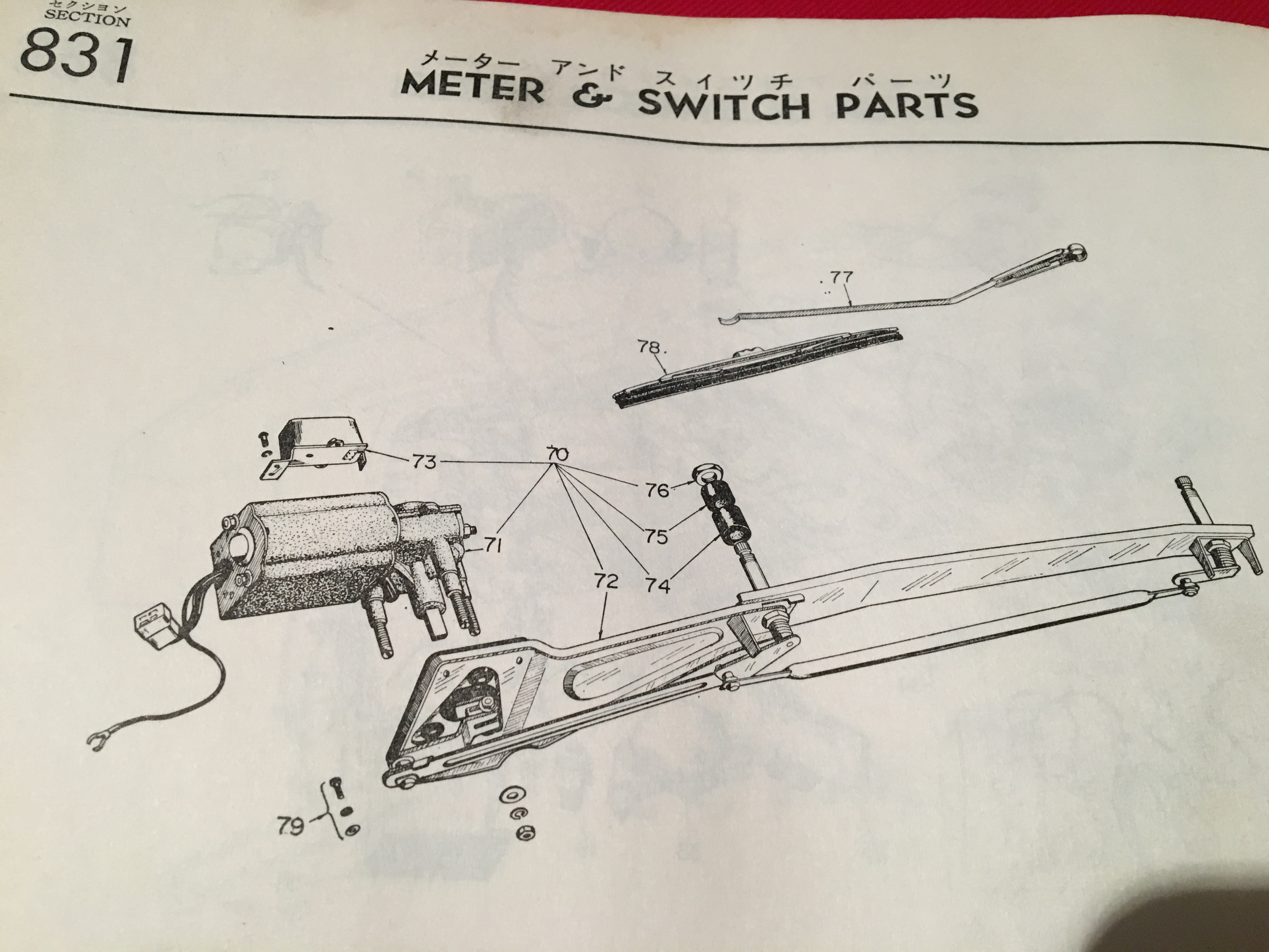

I have disconnected the arms from the motor. Motor works, but the bars (arms) are stuck.BULLITT wrote:a single circlip under the dash which fixes the wiper arms into the back end of the motor releases the wiper bars the 3 screws taken off will take out the motor I would take out the motor make sure the arms are turning its pretty easy I may have a diagram I will look tomorrow morning cheers dave one thing at a time

Here it is.

You can easily disconnect both arms from the motor to see which or both are stuck. See drawing from Bullett. You remove that entire assembly from the car by taking off the nuts on the outside of the car and motor. Then it might be possible to free up the arms using some penetrating oil or similar and slowly wiggling the levers each way.Bellett_EST wrote:I have disconnected the arms from the motor. Motor works, but the bars (arms) are stuck.BULLITT wrote:a single circlip under the dash which fixes the wiper arms into the back end of the motor releases the wiper bars the 3 screws taken off will take out the motor I would take out the motor make sure the arms are turning its pretty easy I may have a diagram I will look tomorrow morning cheers dave one thing at a time

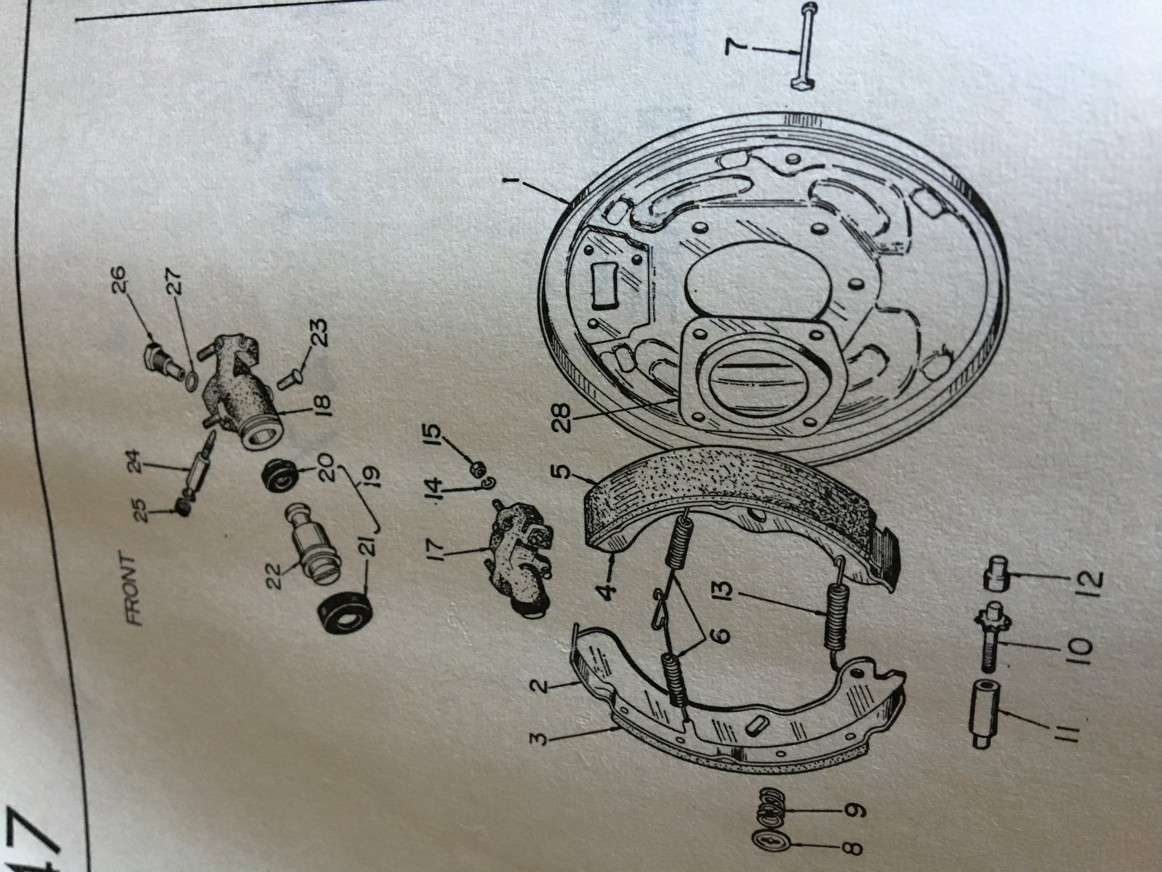

But another problem has came up - can anybody tell me a spare part serial number or code for the brake cylinder (inside the drum) gasket. It is impossible to search it by measure. I'm sure the same gasket can be found on other cars also, but the problem is finding it. If anyone has a part number, it would help finding it.

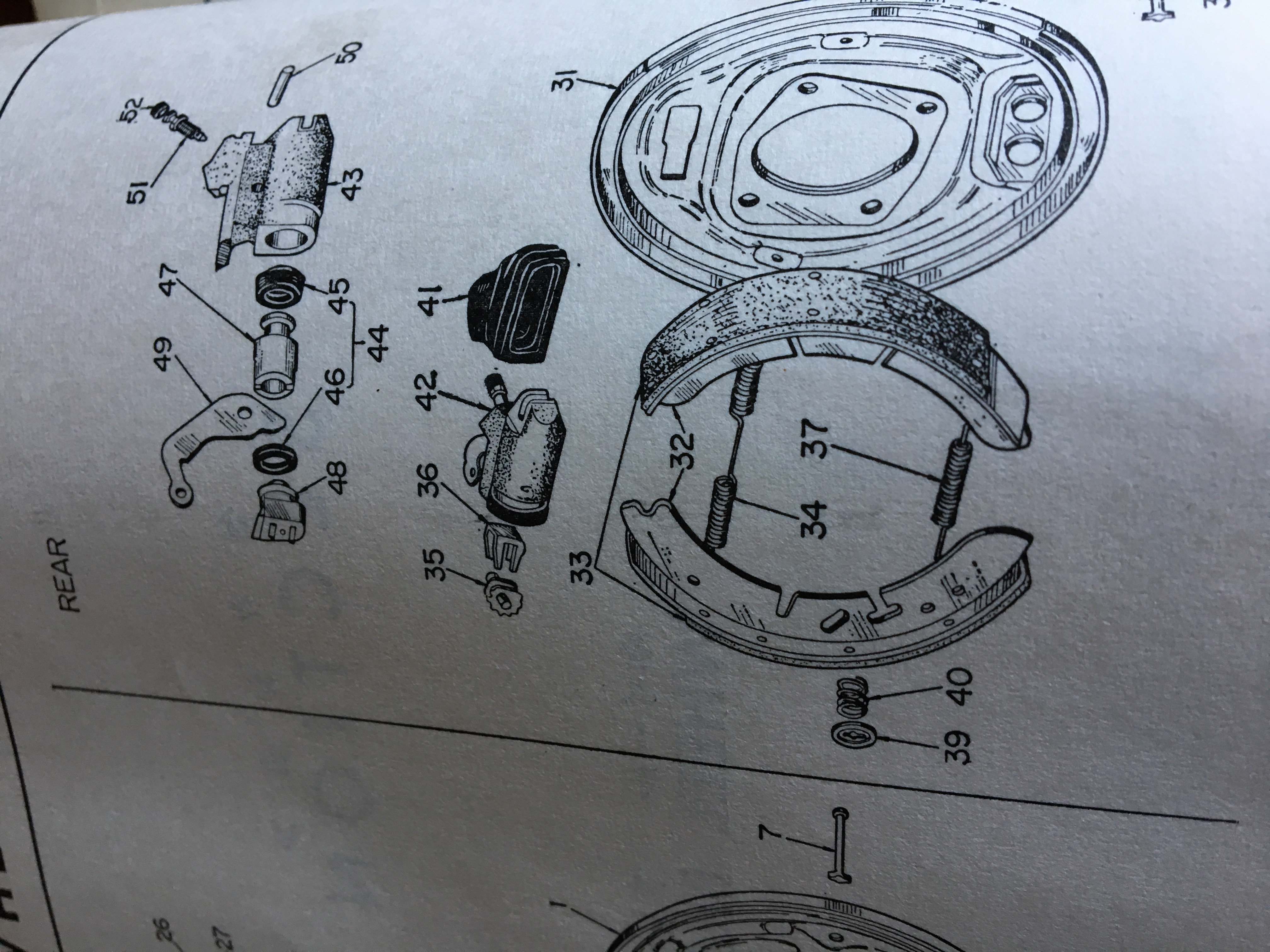

How are the bits you seek going ? This is the brake diagram. Do you mean the the wheel cylinder as in 17 on front and 42 on the back. Let me know I will douce the part number for you

Here's the rear

What I need is detail number 20 on the front brake diagram.
I believe it can be found on other cars, but it is impossibe to find it from spare parts database by measures. Some serial number or part code would be really helpful.
Tomorrow I'll go check in a hydraulics shop, they thought that finding it by size would be possible.

I will have a look at my old ones tomorrow morning in my shed cheers davo looks like a rubber cup ??

It's a gasket between the cylinder and piston.

Hi here's another photo it's a piston cup.

I am not sure about the term, but my problem is a leak from that "cup". Need to replace it, but of course it's not possible to brake repair kit for Bellett, so I need to find a replacement.
Let's see what the hydraulics guys say.
