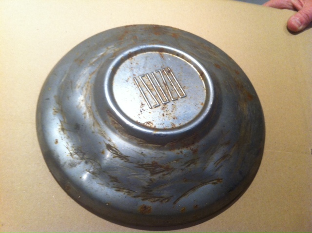

Not sure ,but I think they are standard hubcaps ? I have shown the worst one.
I also have a '67 Bellett ,and the hubcaps are the same ,but some of those have a slightly sharper outside edge on them,so looks like there may be 2 types .
I didn't realise there were so many blinker lens types! Mine has clear/white curved lenses,and I have some spares that are the same in orange ,and also flat face orange ones as well.
I guess the curved bit goes at the top?

Hubbies are often dented or rusty now, but can be re-chromed.

they are standard Bellett hubcaps. the deluxe ones are a full cover car and much fancier.

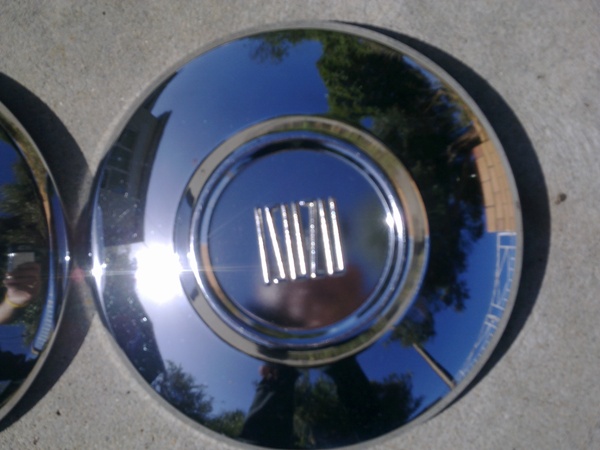

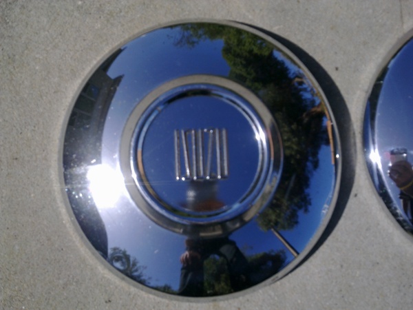

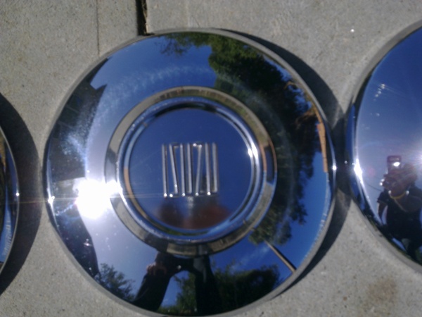

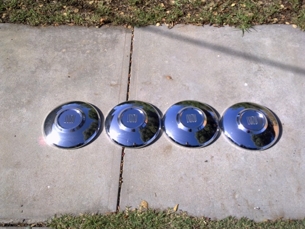

I have 4 of these -- been stored in the shed since 1979 when I replaced with mags
Not in bad nick
PM me if interested
File comment: pitting plus dent
File comment: all
File comment: best 4 almost the same
Wed May 09, 2012 4:05 am
nice one .....just what the man needs .... lets get all these little cars up and about my caps would be a waste of a photo after looking at these cheers davo
