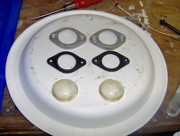

Do your GT'S look like these from a sedan?
Mark

lucky me i got a brand new set with my stash from woodburn still in the isuzu boxes i will have a look i think i have another fair set as well as the ones on my blue machine one is good other is fair all good glasses will look over w/e in my cavern cheers davo

Lens. 8263-1815. rim. 8263-1426. lens packing. [has 'o' ring seals on screw holes] 8263-1783.
body packing. 8263-1784. or go for lamp assembly with wiring harness & bulb socket. 8263-0409.

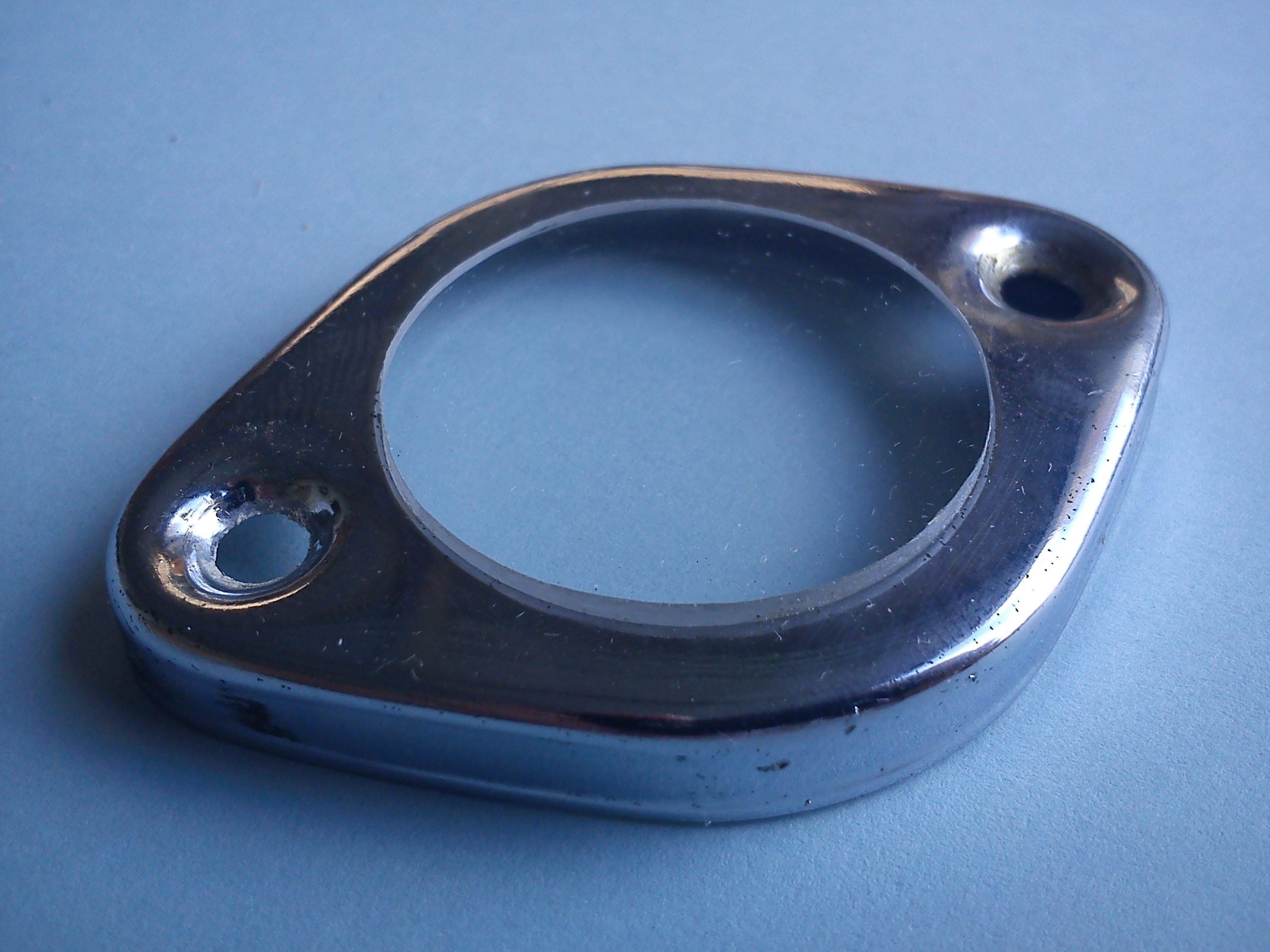

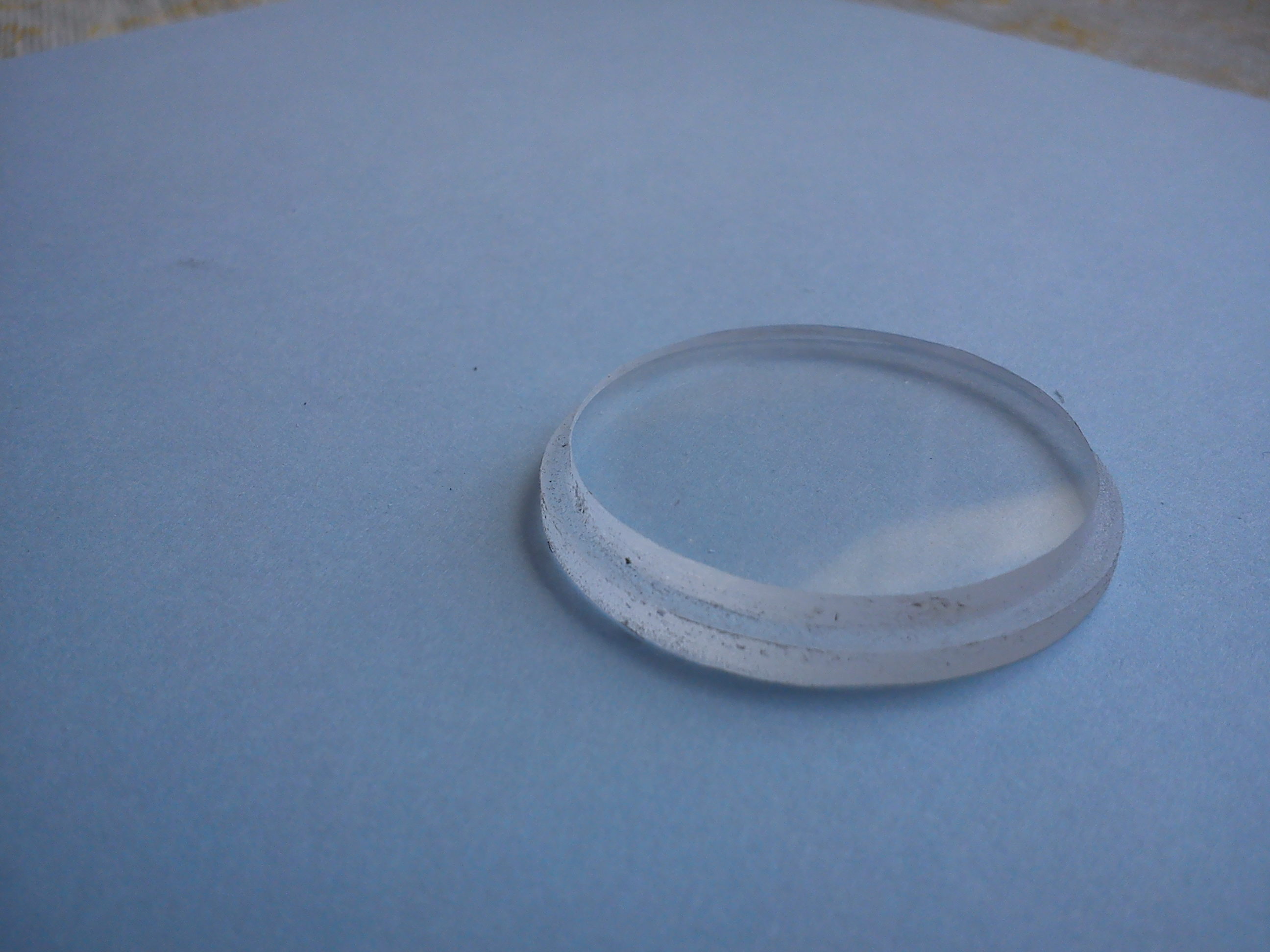

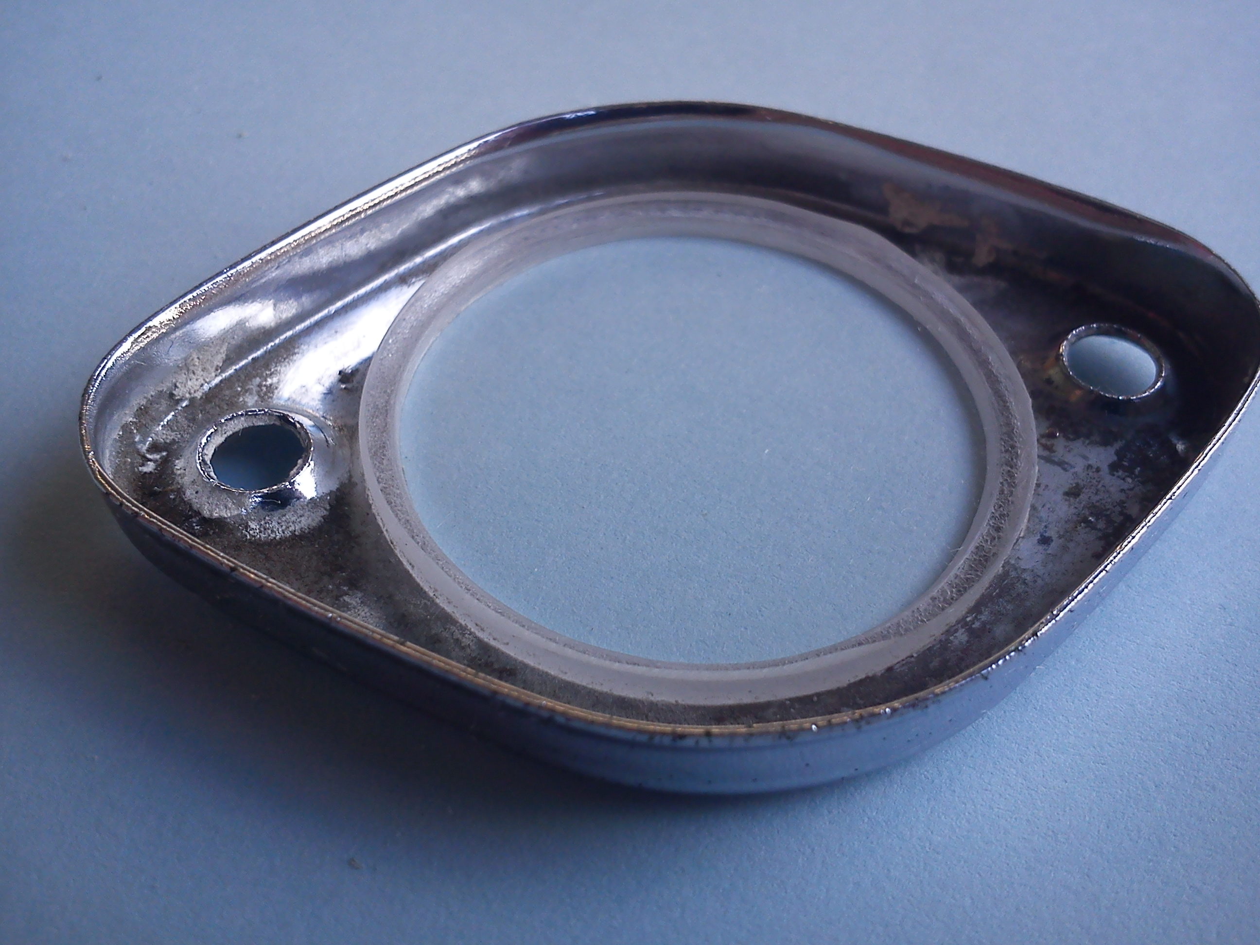

The holesaw method works pretty well.
I just made one from 4.5mm polycarbonate sheet as it does not dis-colour like perspex. (and i had some)
Took the centre drill out of the hole saw, then used the smaller one to make initial cut about half depth. Then next size up, cut the disk out. The 1st hole saw is not exact size so had to run a file round the edge to make it fit through the metal cover.
Used a drill press. You must clamp the material down of course. There is no dome to the made up part though. Since i don't have the rest of the lamp fitting, not sure if there is an issue with the bulb being too close or touching the 'new' lense.
