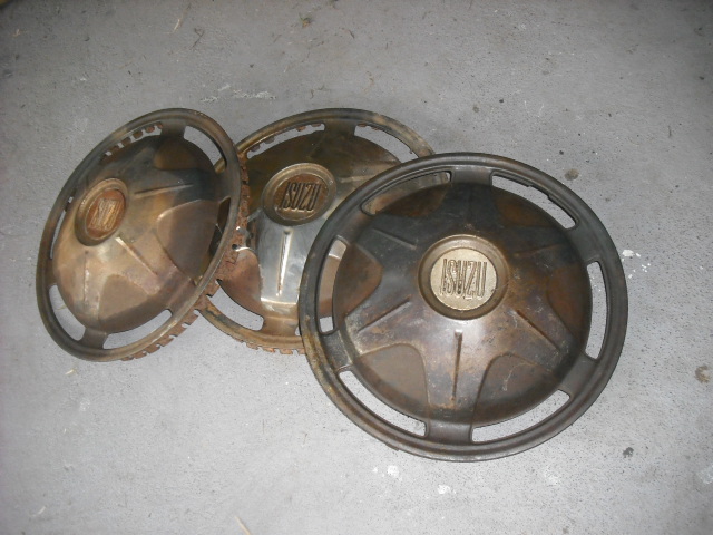

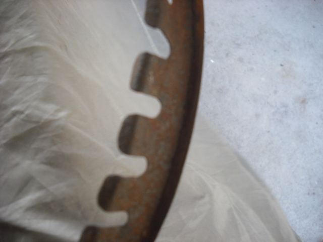

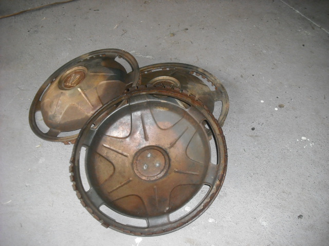

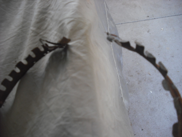

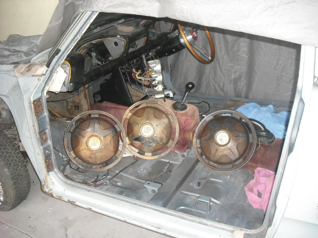

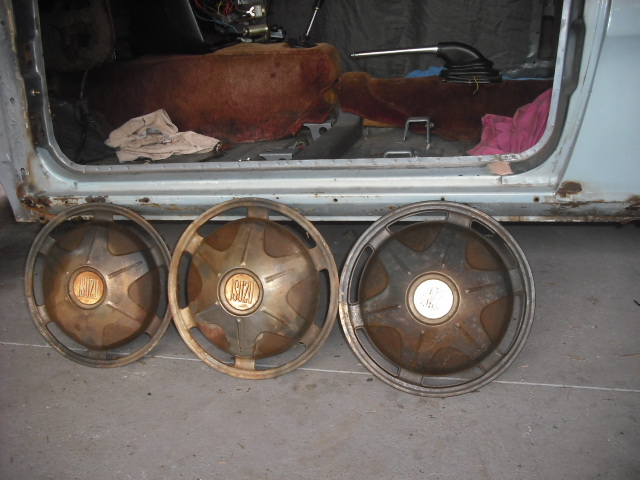

they need rechromed they have been burnt in a fire .still have the Isuzu badge in the middle the outer part which has the grip onto the rim is rusty and r/s they need some work started to re do them this week ..mabee I can put in new clips to hold them on a task ......will get some pics up ..davo
Fri Jan 23, 2015 7:22 am

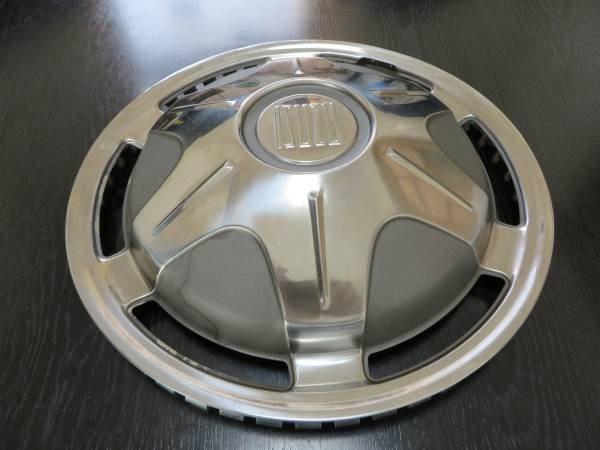

some of the clipping is r/s then theres a good new one in japan I can send a photo of the deluxe minters if wanted anyone got gt caps

Love that bronze patina Davo......just clear coat them :D
Sorry I can't lend you 2 of mine....they are already on loan to me.

I thought they are stainless steel.... so that 'rust' should polish off. The clips may not be stainless, but spring steel. Too long ago since i did them up on now Dave's GT.
then mask them up to repaint the paint areas. You would need to match the paint of course.

Have you tried polishing with a drill and flap disc?

I don't think i would use a flap disk,.... i assume that's a sandpaper disk?
It would be too harsh on the s/s i think. I think i would prefer using something like mag wheel polish, more elbow grease but should just remove the discolouring and shine it up
my 2c
Fri Jan 23, 2015 10:16 pm
Dave, I am with Glenn, use chrome polish not too harsh, you can buy these polishes in Supercheap or Repco and they do a great job, slow when they need it like yours do, BUT for the rarity of these wheels you need to be as gentle as possible!

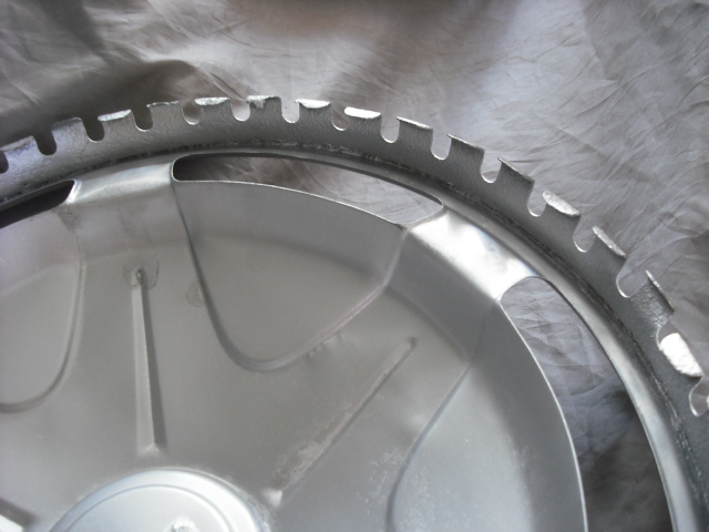

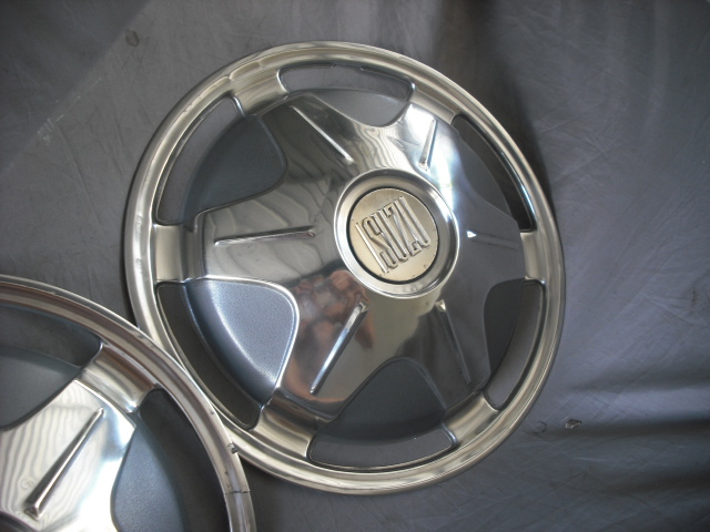

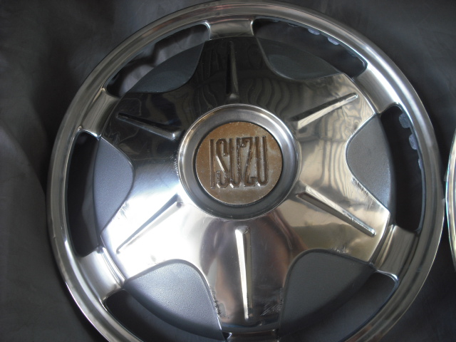

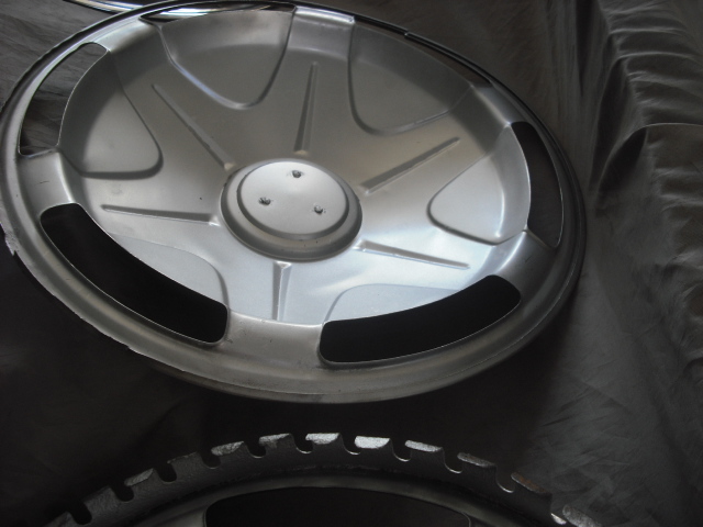

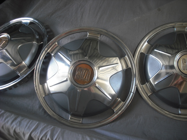

hi guys thanks for your return on the caps ..I spent a few painstaiking ours on these 3 caps polished ,buffed, and hamertone painted the relevant bit ..mee thinks they come up ok heres some pics of them and a side shot of the clip on it only one has a clip ... thanks glenn ,and glenn potter and farmer for your help what do you think ..not new ...nor am I
