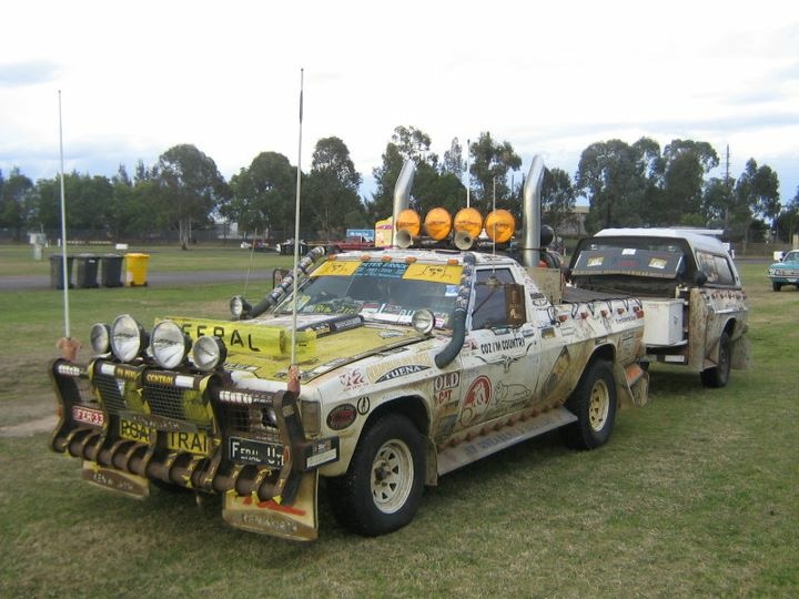

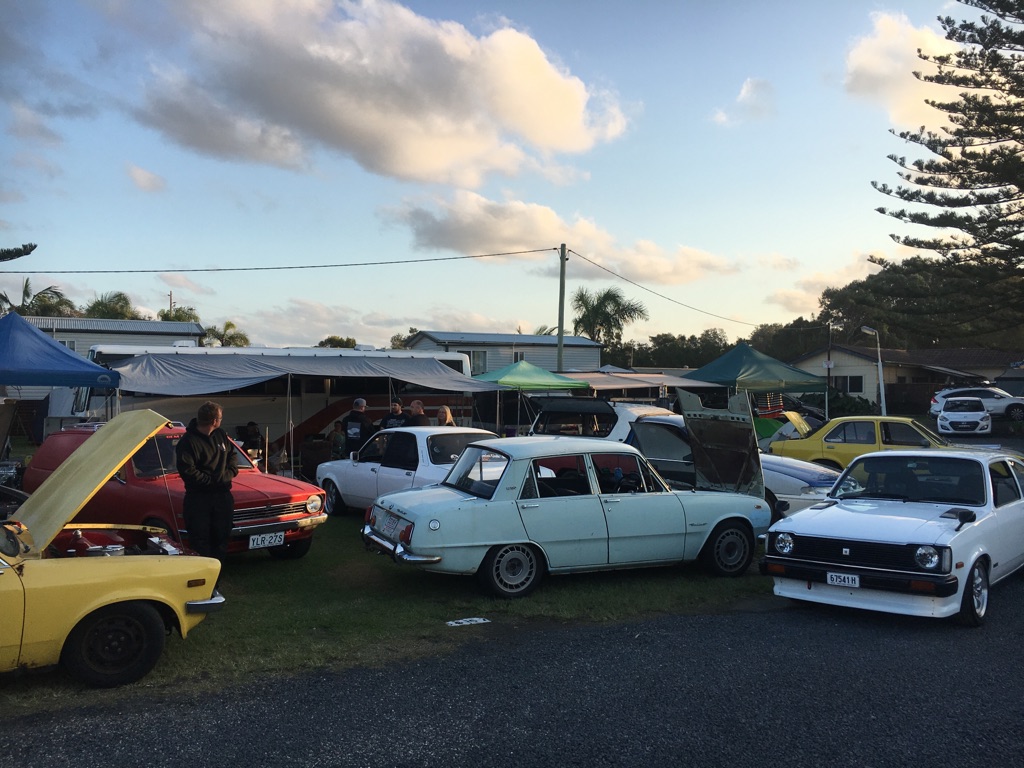

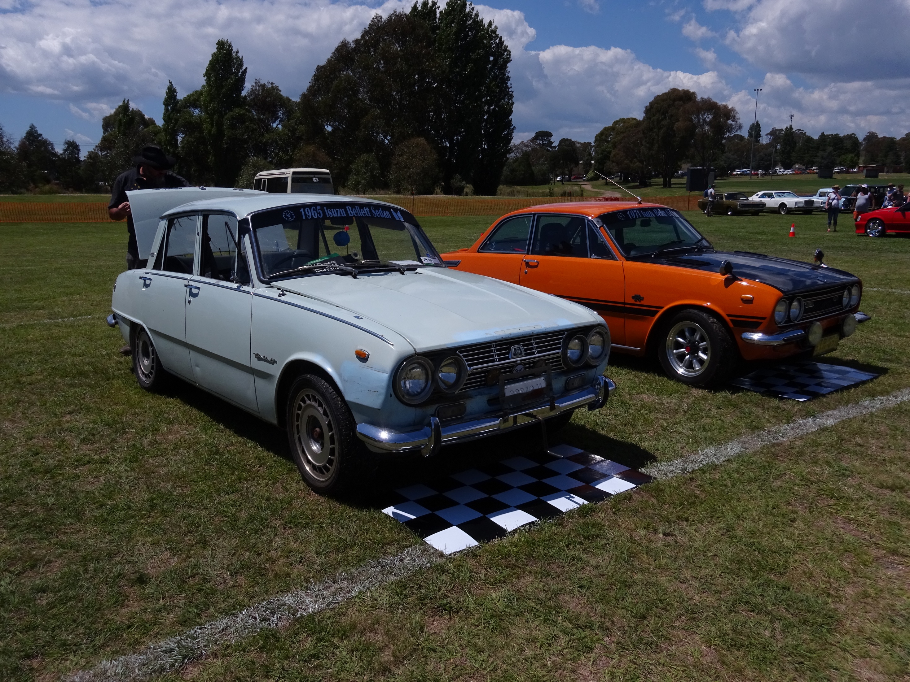

I have tried to send a photo of Kevs teardrop.
Hope it works

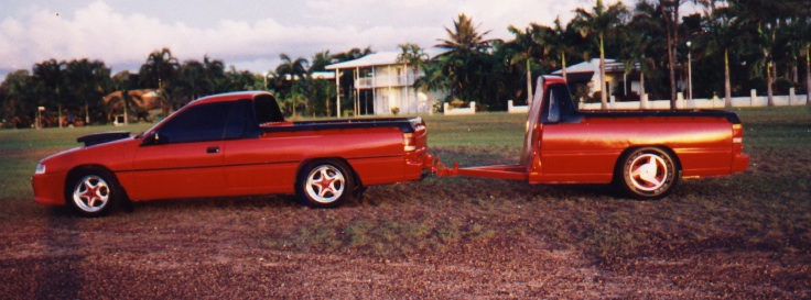

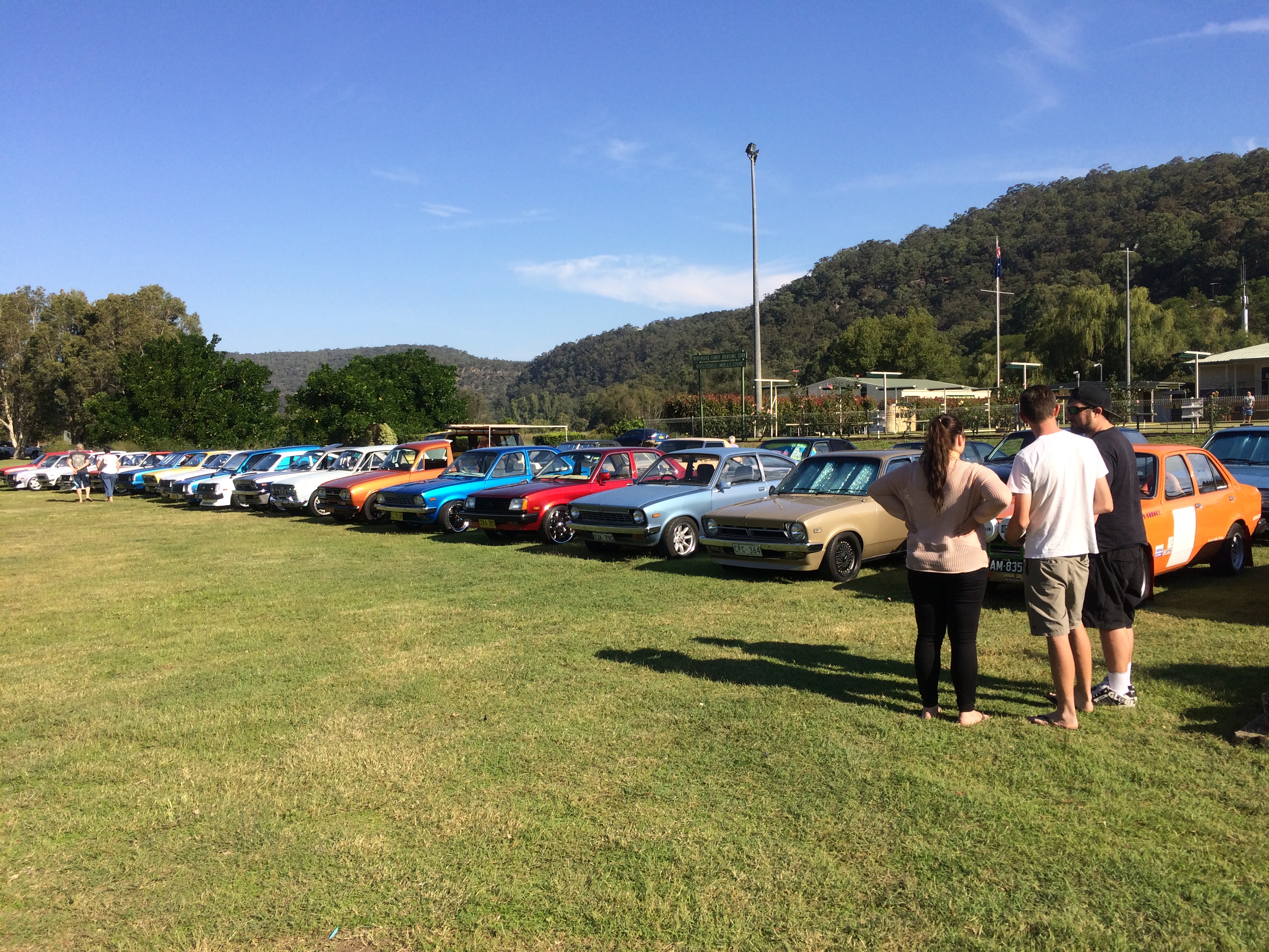

I have a couple too :D
I love the Skyline wheels on Kev's teardrop

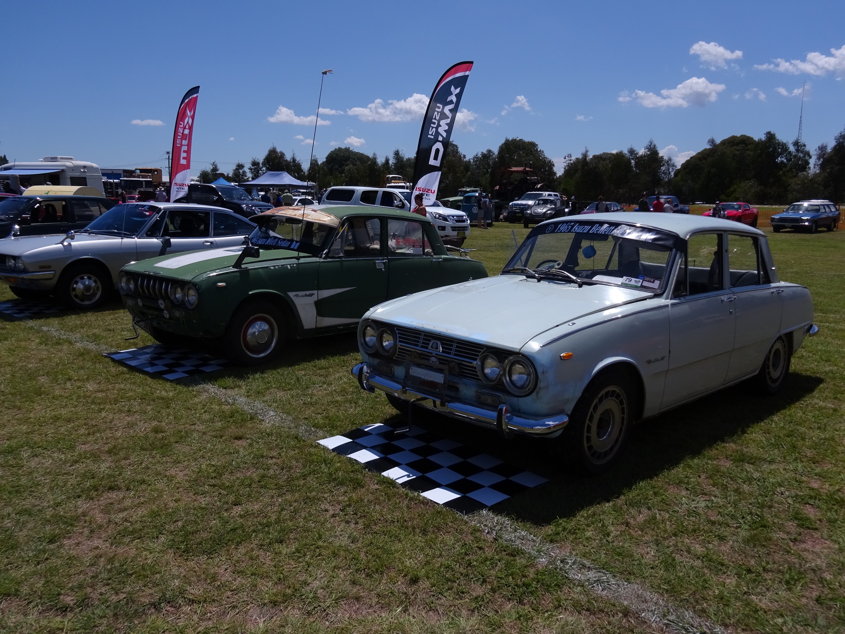

Club Starters Bellett.
Im still looking for the engine bay pix.
1500 block Gemini 1600 60thou oversize hightop pistons / block decked too much for the hightop pistons.
steel head shaved more than a bald mans head. too much for the pistons too.
had to run 2 head gaskets to stop blowing them out revving anything over 2500rpm
45mm side draught webber extractors.
daily driver for more years than i can remember.
the car known as WOODY was also known as my eldest brother..

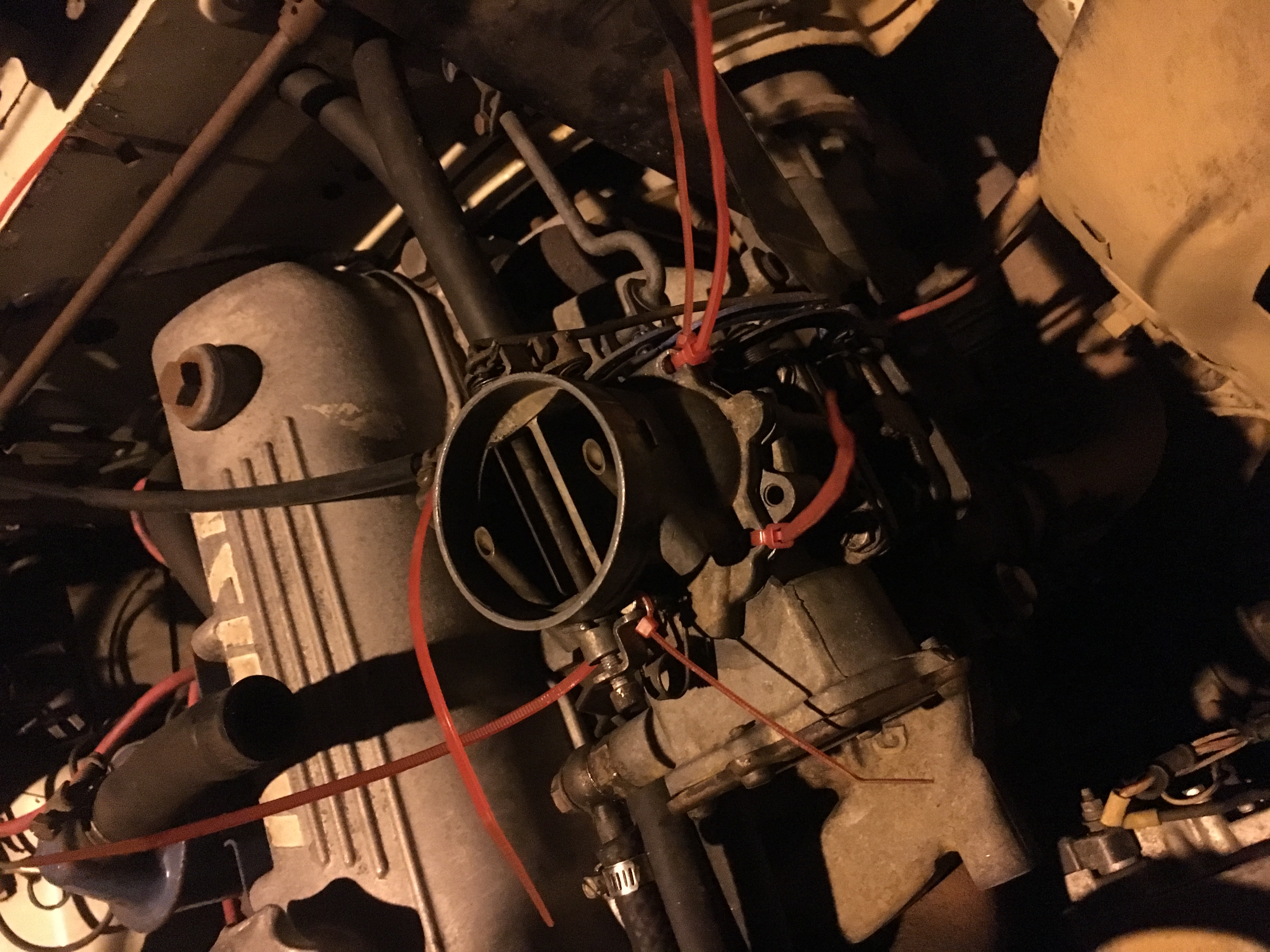

I hope the dude that invented zip ties is sitting on a beach somewhere, sipping on Margarita's with a dirty great smile on his face :D
Is there anything zip ties can't fix??
