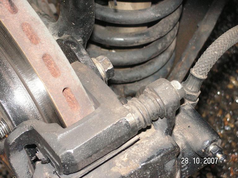

TP Magna quite and easy fit over standard drum hubs. Wheels wil have to go to at least 14"

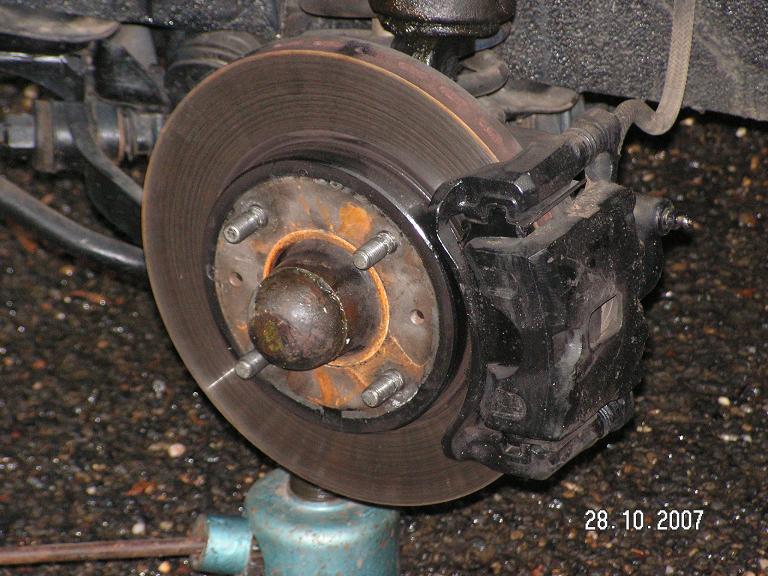

The Magna disk 1985-1992 includes the TM, TN, TP & fits OVER the drum hub.
Peter's pic above is not that type of Magna disk.

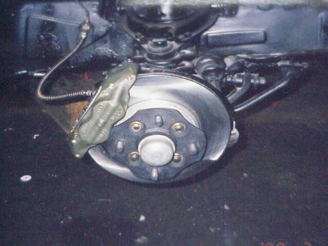

Sorry bout that wrong piccy Here is the right one. A template is available. I would add that as the piccies do not show this system has, what in my considered opinion a major flaw. The stub has 4 mounting holes for the drum brake system. This in my considered opinion is the way that any brake bracket should be mounted. I am in the throws of having a pair made for myself. They will be laser cut and possibly washed down to 9mm thick. I will keep you informed of my progress.
