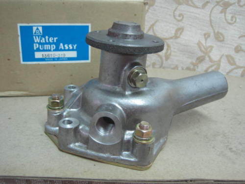

Here is a link for a water pump for sale on Ebay. BUT at nearly $400 AUS you would have to really need it!! http://www.ebay.com.au/itm/NOS-WATER-PU ... SwwE5WVYI9Josh

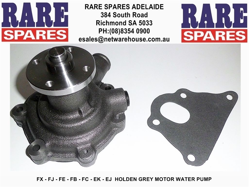

degruch wrote: I don't think any one individual will take that punt to be honest, as they'll be left sitting on stock forever. If a few of you can get together and arrange a group purchase for that 100pc MOQ from China it may be doable (100pcs between 5 people = roughly $2,500 a piece).
But $300-400 per pump is a reasonable price, I think people need to get used to this pricing as the days of $20 water pumps are long gone. every time this comes up, i think of the water pumps used on a zillion Holdens with the Grey or maybe the red motor (or black) and think those simple pumps might just be adaptable to a Bellett. Mind you I don't have either of them to compare and see if that's feasible. Depending on the height of the Holden pump, an aluminium adapter plate might work ? eg a plate 10mm thick, drilled to Bellett holes and countersunk bolts used to screw to Bellett block, then tap the plate to take the Holden pump. All assuming the water passage would line up or close enough.

degruch
Joined: Mon Nov 24, 2008 7:50 am Posts: 774
Glenn wrote: every time this comes up, i think of the water pumps used on a zillion Holdens with the Grey or maybe the red motor (or black) and think those simple pumps might just be adaptable to a Bellett. Mind you I don't have either of them to compare and see if that's feasible.
Depending on the height of the Holden pump, an aluminium adapter plate might work ? eg a plate 10mm thick, drilled to Bellett holes and countersunk bolts used to screw to Bellett block, then tap the plate to take the Holden pump. All assuming the water passage would line up or close enough. You might be onto something Glenn...I wonder if it might be possible to find a proprietary pump shaft/bearing/impeller of the right length (maybe Holden), scan in the Bellett water pump housing, CAD up a modified housing to accept the new shaft/bearing/impeller and then CNC machine a new housing? Off shelf aluminium might do the trick, a coarse sandblast on the outside will make it look like a cast housing...completely rough estimate, maybe $100? Add backing plate, gasket and proprietary parts, maybe another $100? Maybe we can 'open source' our way out of trouble and have a reliable supply of parts?
