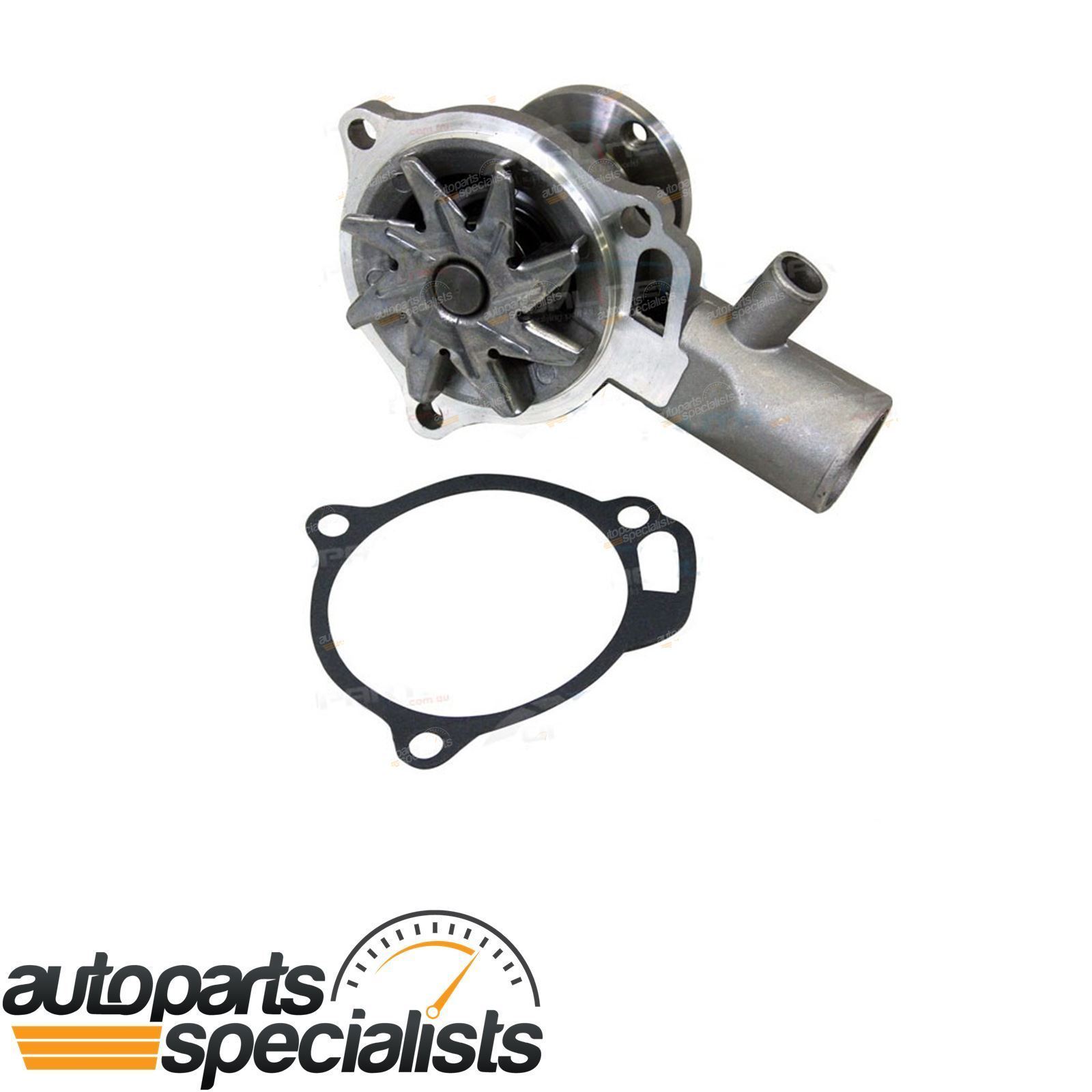

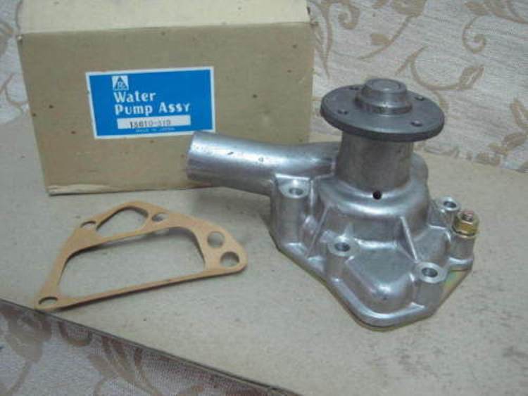

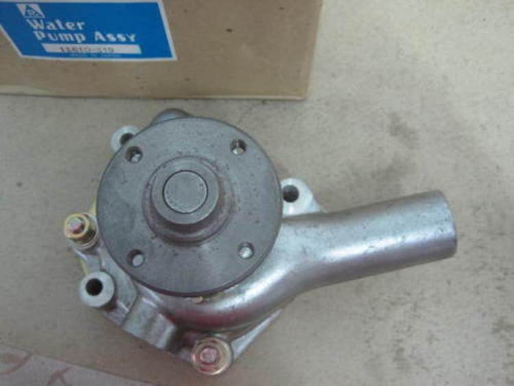

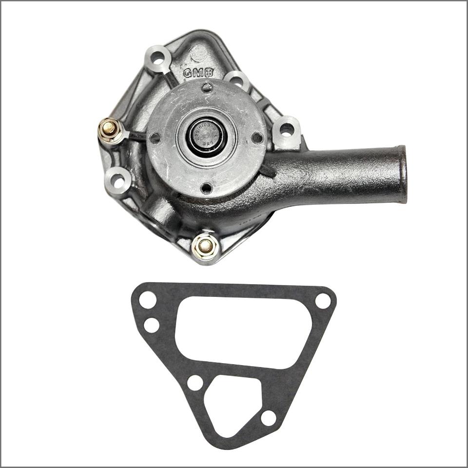

The pump looks pretty right :ugeek:

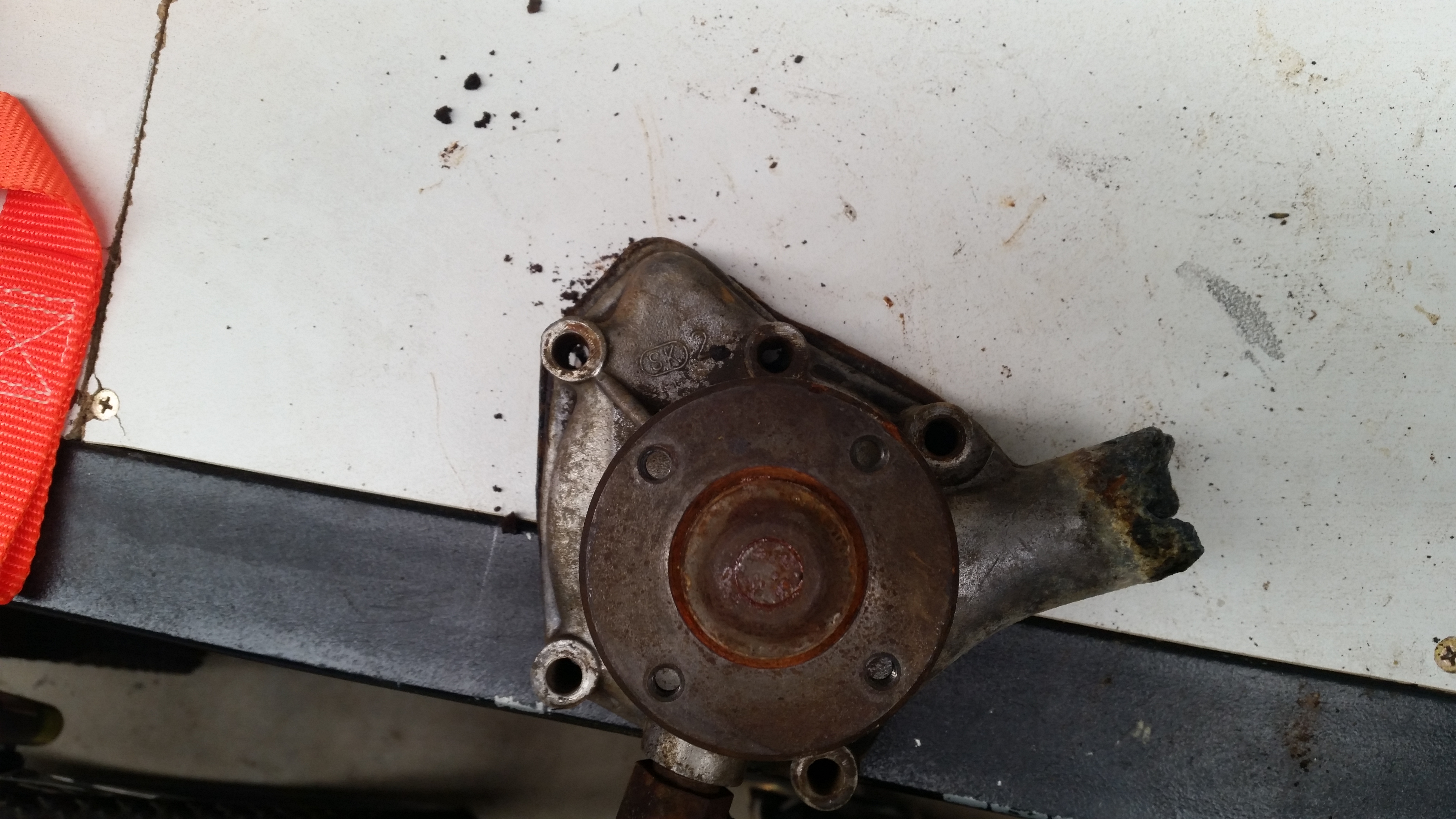

Yeh had me worried haha so went and pulled the pump off the deluxe . The deluxe pump has one less bolt holding the backing plate on but the rest is identical. Double checked on the other bellett it has 2 bolts holding the plate .so not sure what the deal is there .

Without being cryptic, there's some important differences between the top one and a Bellett pump from memory...we should play spot the difference! I don't think that one will work on an OHC Bellett, but I may be wrong.
Repair kits I've found have their perils...3 different types of seals within PR20 Bellett pumps (carbon, cork and steel sealing faces). Later pumps also have wider bearings, longer shafts and different impellors which operate at a different flow rates.
Not sure what the difference in bolts for backing plates means, but would be interested to find out. Sorry sdoubleb, didn't mean to scare you! The Cypress pump and the Bellett look very similar, yes, so probably good, but safest to check critical dimensions before buying just to make sure.

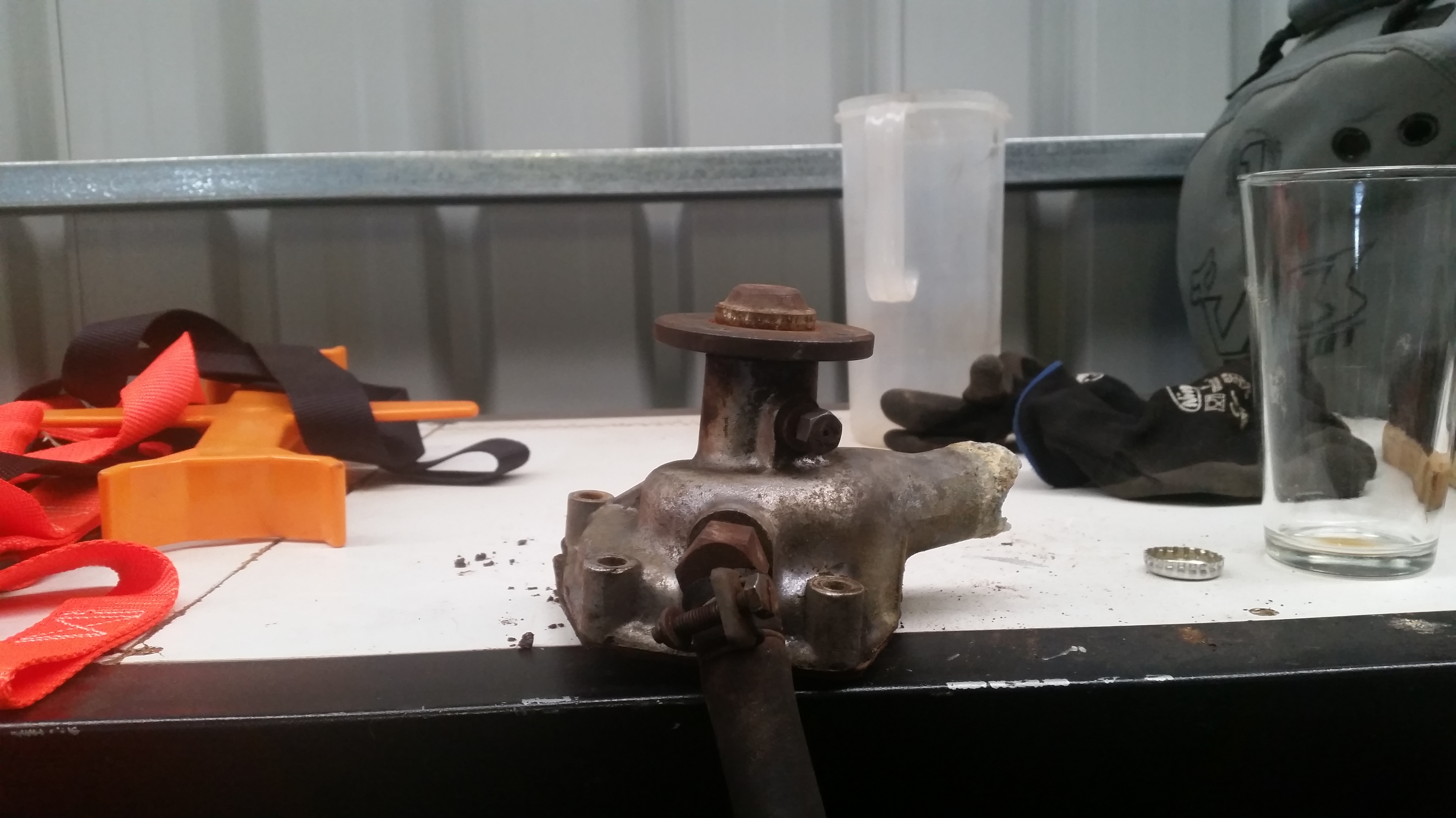

Heights on this an pump that was ebay look the same . Pump on ebay has gone . But seller did say he had more pumps
