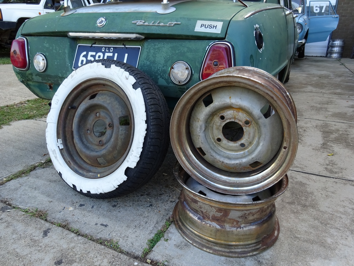

Some of you will remember the Datsun 200B steelies that Donkey use to roll on from previous National meets.

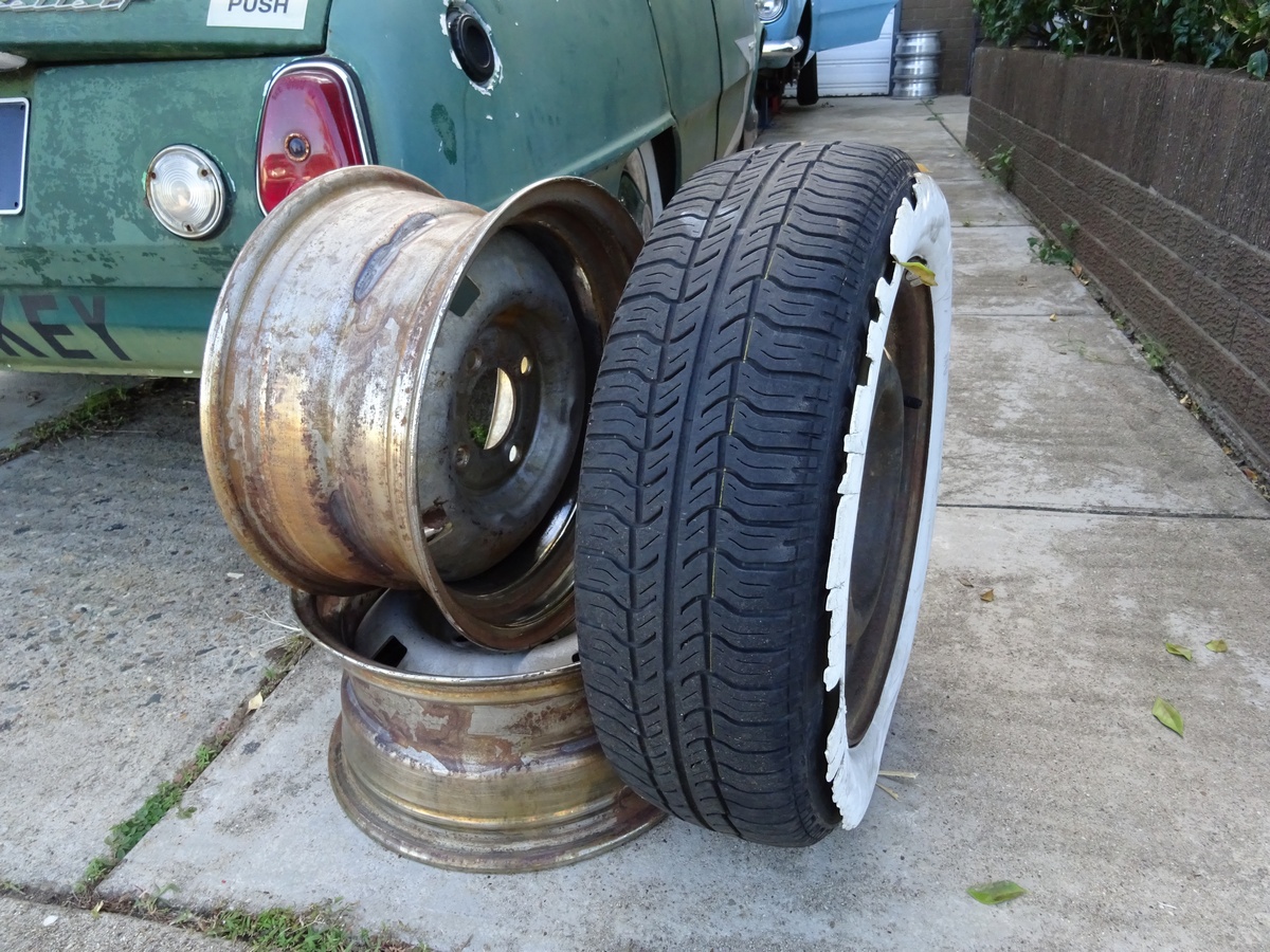

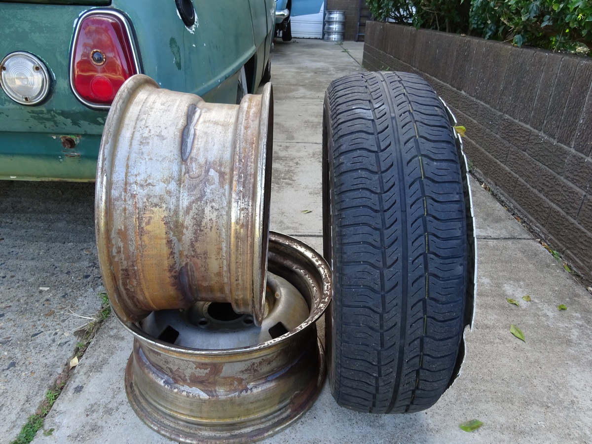

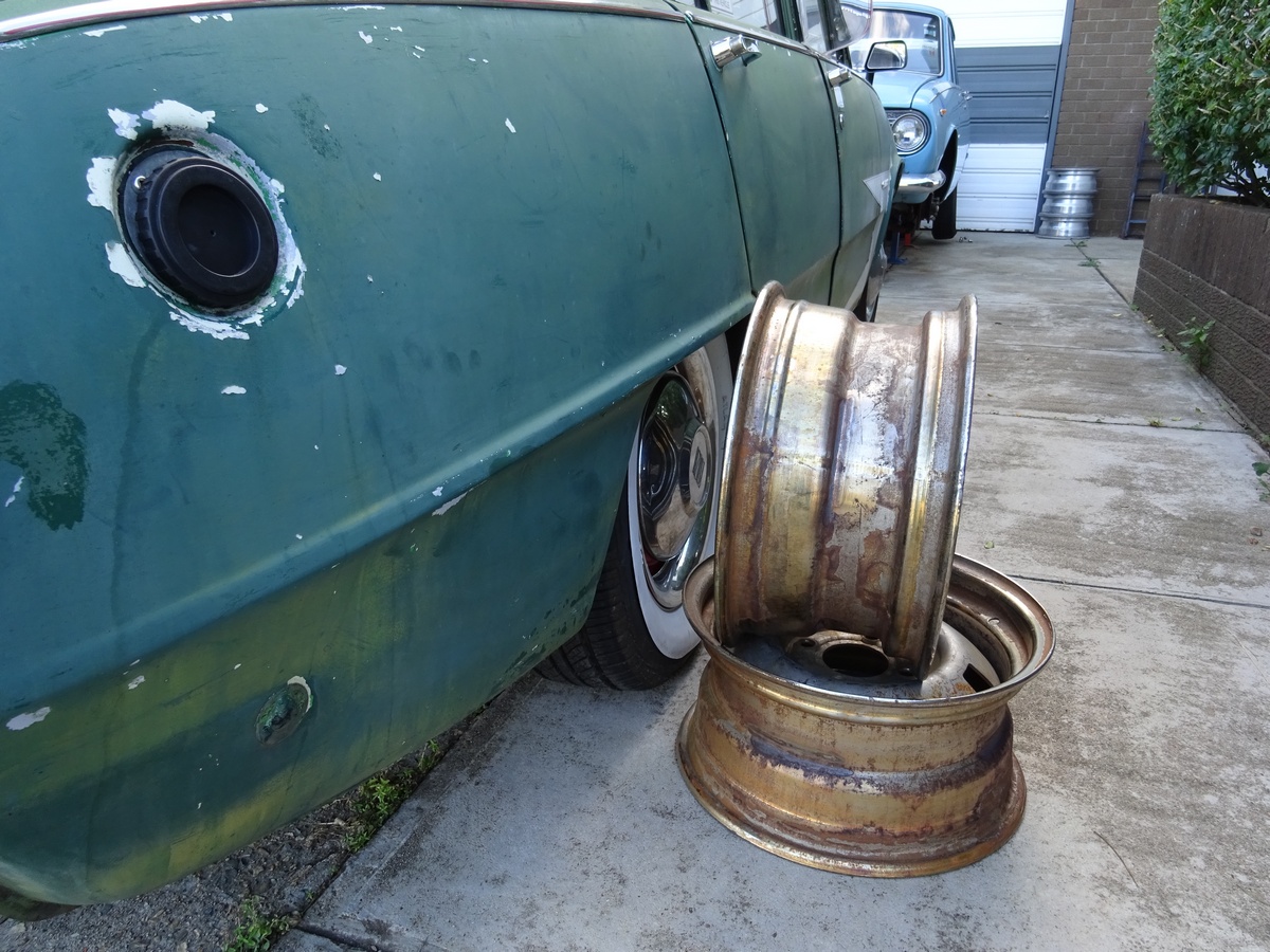

Well their original 4.5" width just wasn't filling the rear arches enough for my liking so I've just had 2 of them widened a little.
Out with the 4.5's and in with the 7's
I still have to get them powder coated yet and tyres fitted but you can see how PH phat they're going to be..... :mrgreen:

These are the rims now after widening
Bently's widened rims (2).jpg (431.45 KiB) Viewed 45667 times
Bently's widened rims (3).jpg (517.01 KiB) Viewed 45667 times
Bently's widened rims (4).jpg (540.88 KiB) Viewed 45667 times
Bently's widened rims (5).jpg (502.84 KiB) Viewed 45667 times
I was going to go with 8" widend rims but to do that I'd have to go 15 or 16 inch rims for the inner lip to clear the top spring seat, but I can't find any steel rims that I like other then ugly "pursuit rims" with the required 4x114.3 PCD
......oh and just incase anyone wants to know, you need a backset of 4 & 13/16th inches on 13 or 14 inch rims (gives approx 3or4mm clearance to spring seat and 7-10mm to the outer guard - so choose the right tyres!! MAX 205wide)

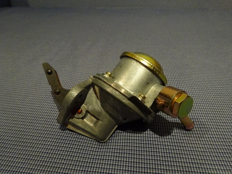

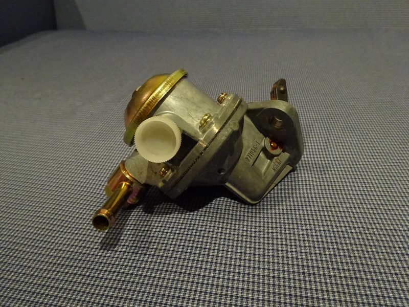

UPDATE TIME......
Donkey is still missing in action but the "Family" love runs deep for this little guy (work has interrupted engine install - ready to go just no time to slip it in)
A massive high five to one of my SA brothers for Donkeys new pig valve to steady his new heartbeat..... you know who you are.... and yes - YOU ARE A LEGEND!!
